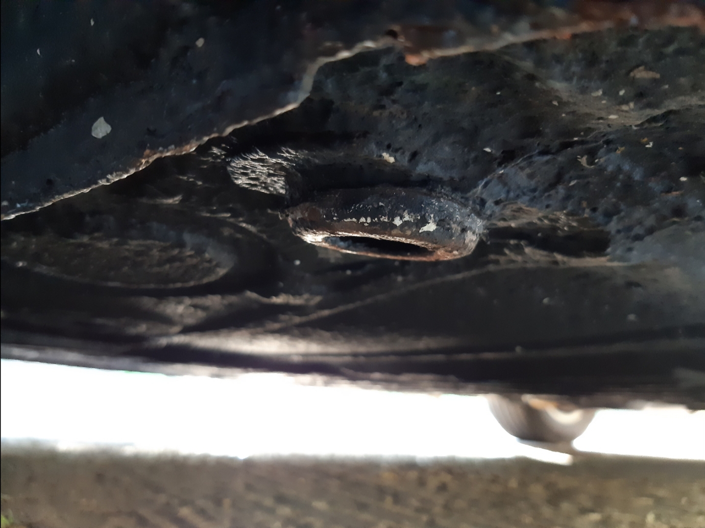

I've noticed that the front jacking points on my car aren't level, and wondered if they've gone up as the car has been lifted - thoughts? It all seems solid.

SirAndy   They are crooked because those aren't jacking ...   Mar 25 2020, 10:15 AM
Biggles   They are crooked because those aren't jacking...   Mar 25 2020, 10:29 AM

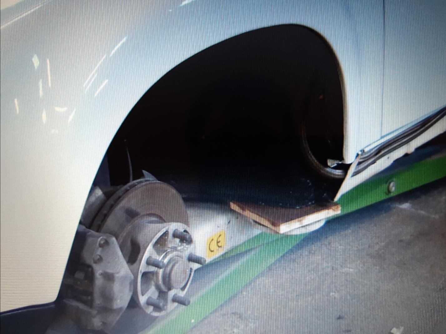

dr914@autoatlanta.com   jack under the engine mounting bar, or the front c...   Mar 25 2020, 10:37 AM
Biggles   Cheers George. No engine mounting bar. It's a ...   Mar 25 2020, 11:13 AM

bretth   I thought all four doughnuts were for jacking up/s...   Mar 25 2020, 11:05 AM
SirAndy   The donuts were used to suspend the cars on the as...   Mar 25 2020, 11:17 AM

Retroracer   Donut jacking: interesting reading for me. Early ...   Jul 6 2020, 05:44 PM
Cairo94507   Jesus.....what is the best way to lift a 914 w/o d...   Jul 6 2020, 05:50 PM
euro911   Jesus.....what is the best way to lift a 914 w/o d...   Jul 6 2020, 11:38 PM
mepstein   Jesus.....what is the best way to lift a 914 w/o ...   Jul 7 2020, 06:17 AM
