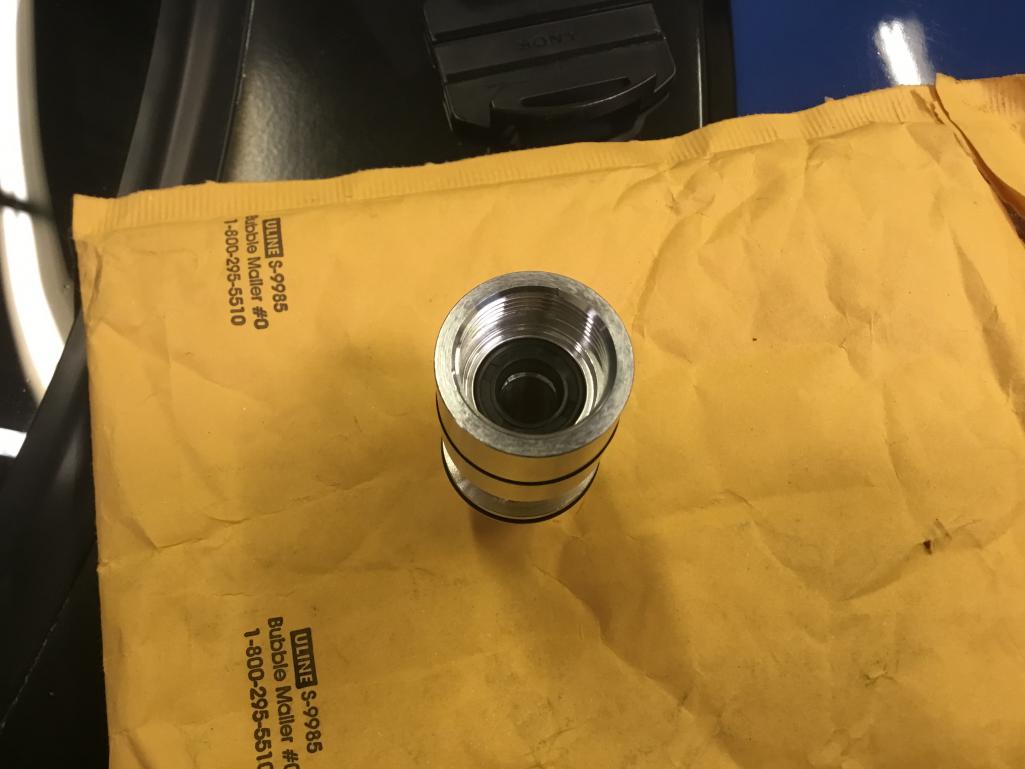

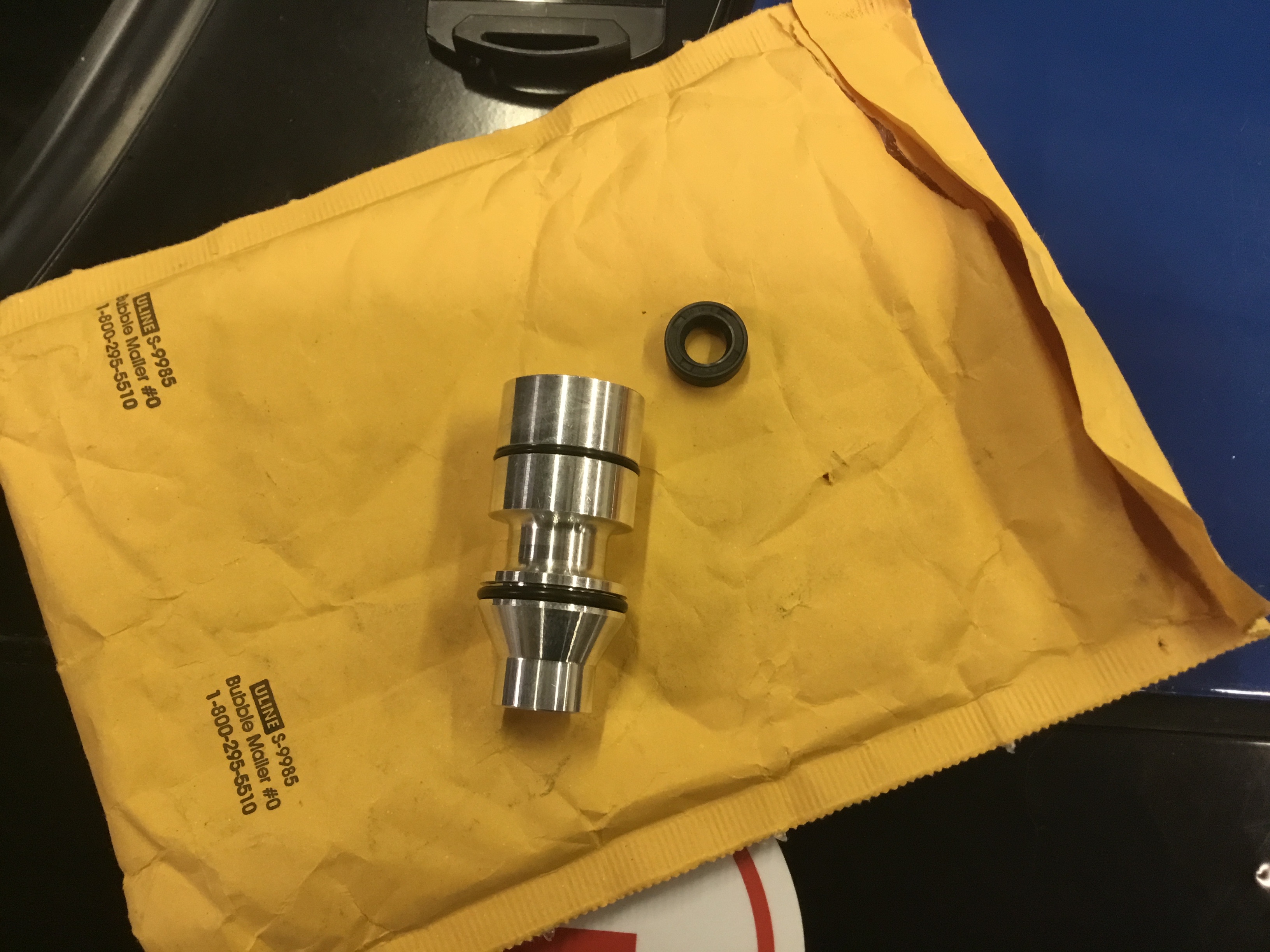

Ok dumb question and no pics cause I’m at the office. Yesterday I got the package. It came with the new shaft with o rings (2) installed. There was a small rubber gasket also included.... where does that go? I don’t recall this coming out when I swapped my last shaft...

This is the little guy I mentioned, it’s harder rubber.

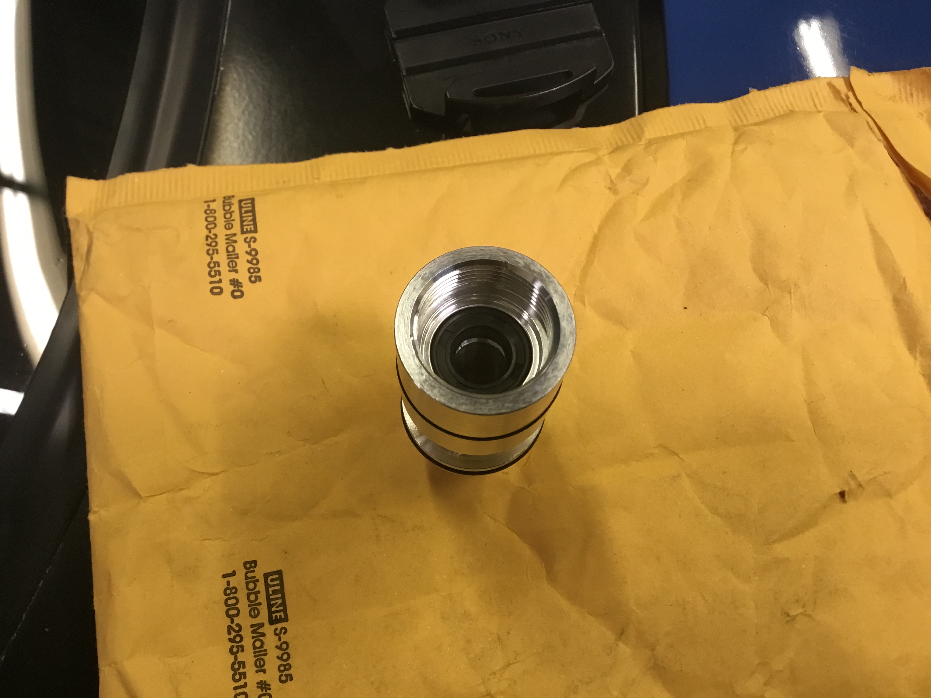

Now that I’ve got it in hand, assuming it goes like this, inside the bushing...

QUOTE(infraredcalvin @ May 6 2020, 04:37 PM) *
You are correct that is the orientation. The seal we put out that we sent the replacement on id the one that we added. The thin one.

Installed! No drama, will check for leaks in the next few days...

How common is it for the lip seal to fail ?..thinking that could be my issue (IMG:style_emoticons/default/idea.gif) .

Sorry but confused,not talking about O-rings but the small lip seal shown in the pic,are you saying that not fitted to the factory part and only to the one you sell?.

Sorry my misunderstanding when you said lip seal I assumed you meant the o ring on the bottom that sits just inside the lip.
The internal seal can leak, for the most part they aren't under any real pressure, so not a bad call to change out every 70-100k.
