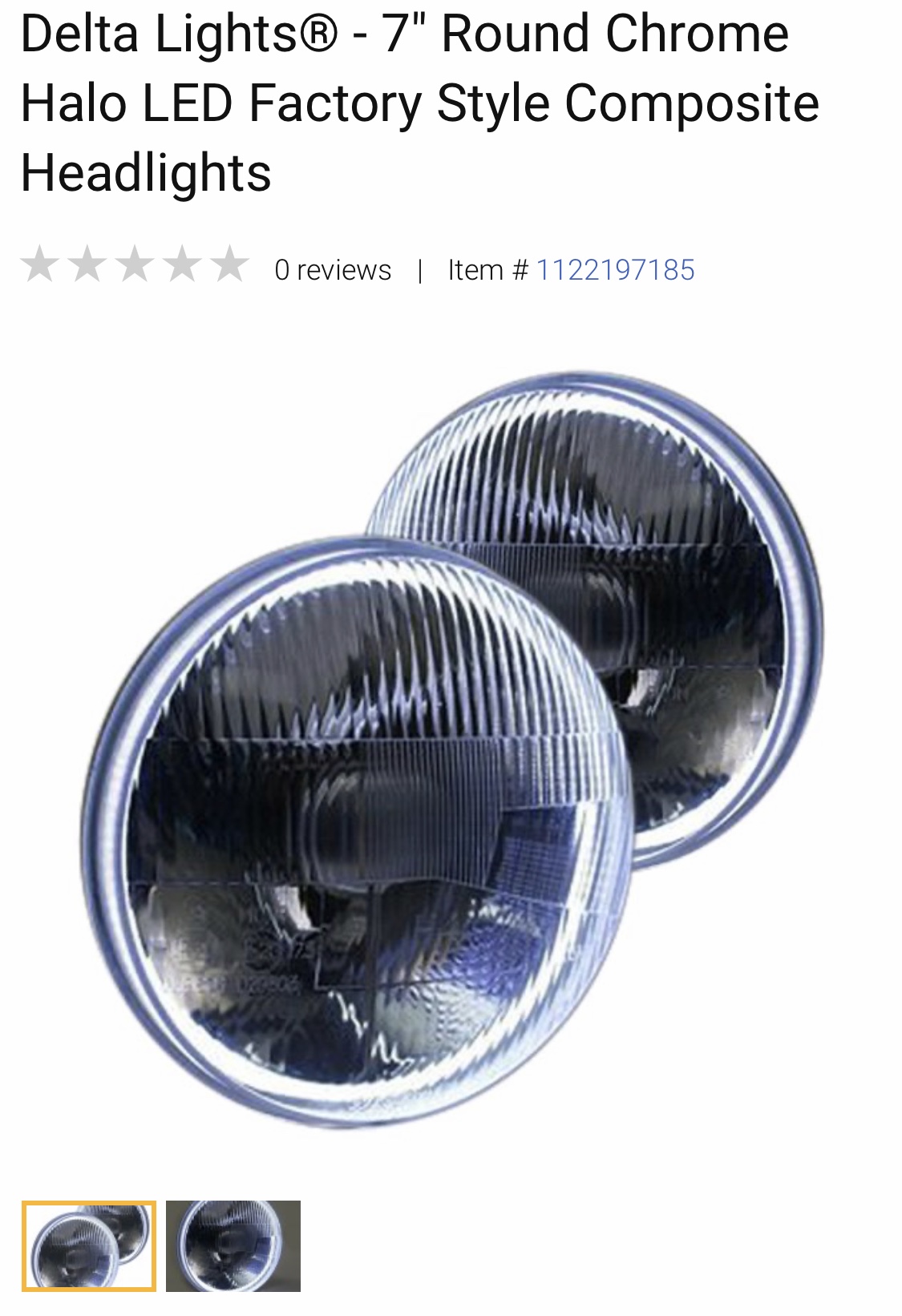

Hello. Curious of opinions for these headlights, does anyone have halo lights installed? Thanks

I like the idea of LED lights in a 914. I do not like the idea of adding stuff to is that doesn't make it period correct. And yes I understand that LED isn't period correct either, but better light for me is in another league as driving around with big halo's. Especially in popup headlight the kind of defeat the purpose. Or are you always going to runs the de popups open?
I don't think you can see the halo with the main beams on.

I’ve seen people use halos in the fog light location. Seems like a better place for a DRL since they’re always exposed.

This was in my thoughts as well, that it wouldn’t be period correct. I put them on my Corrado, there’s no giant ugly ballast sticking out like a sore thumb, they just plug in like original and they make a world of a difference. You can Actually see the halo at night with lights on and the light is more of a white light with blue glow. The only advantage On my 914 is that it will be painted blue which would match.

A halo Headlight on a car with hidden headlights does not compute. It’s like putting gills on a horse.
