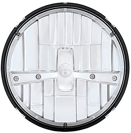

I waste a lot of time looking at LED headlights online and the closest of the GOOD headlights I've seen to period correct are some United Pacific 31400 units that sell under a few different brand names.
IPB Image
Not perfect but a little closer than the Nighthawks and I actually like the pattern better. Here's a review of them.
https://www.youtube.com/watch?v=1qStRHOFRcY
The problem with buying LED is there is a lot of snake oil out there. I've seen some LED units that look period correct, but not DOT approved and usually have really crappy beam patterns that either don't use the light efficiently or would blind oncoming drivers. I get the idea it is hard to aim LED lights using more conventional lens designs.
