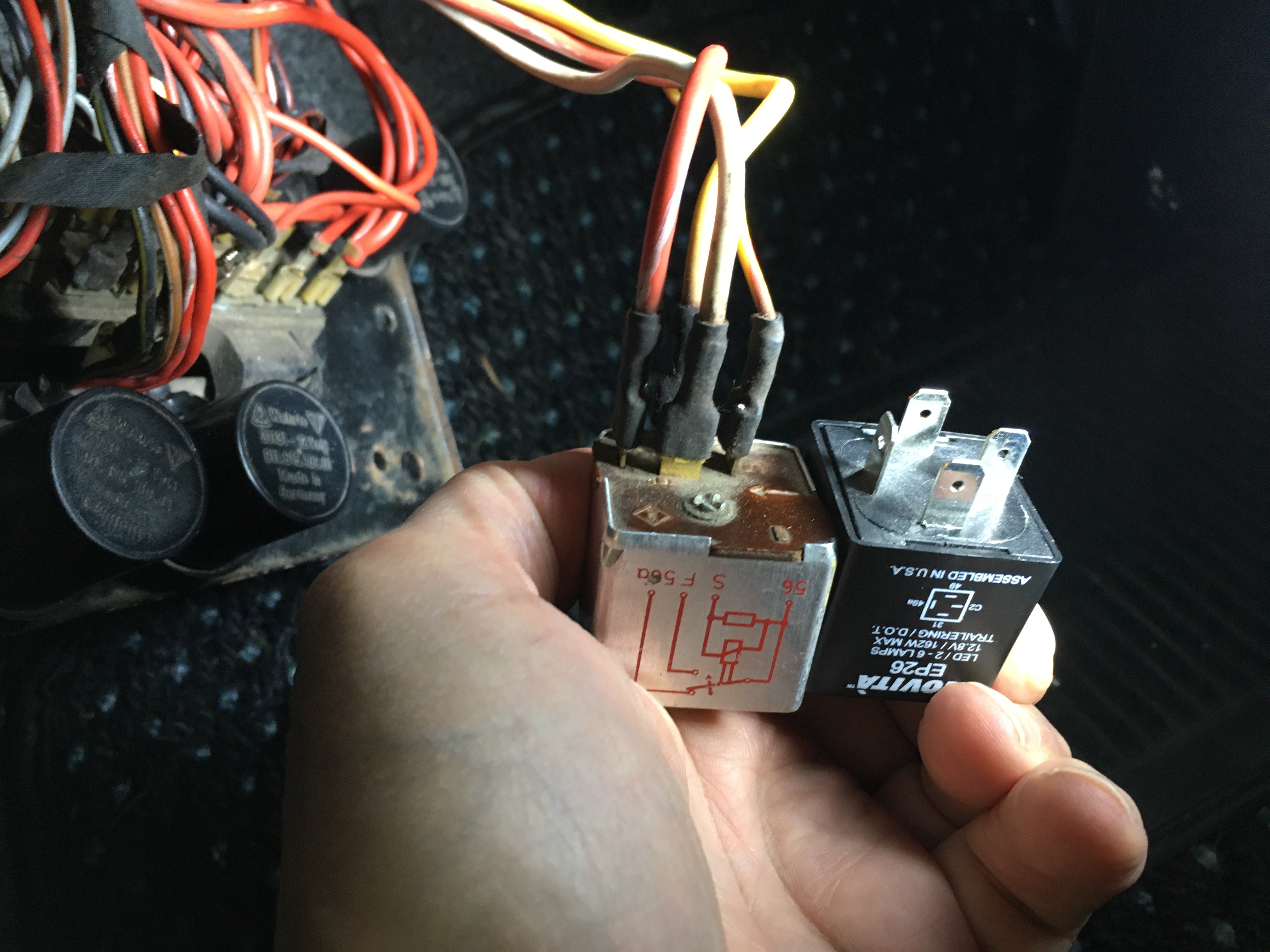

What wire goes to what terminal?
PanelBilly
post May 11 2020, 06:09 PM
Posts: 5,959
Joined: 23-July 06
From: Kent, Wa
Member No.: 6,488
Never mind found another connector stuffed in the dash

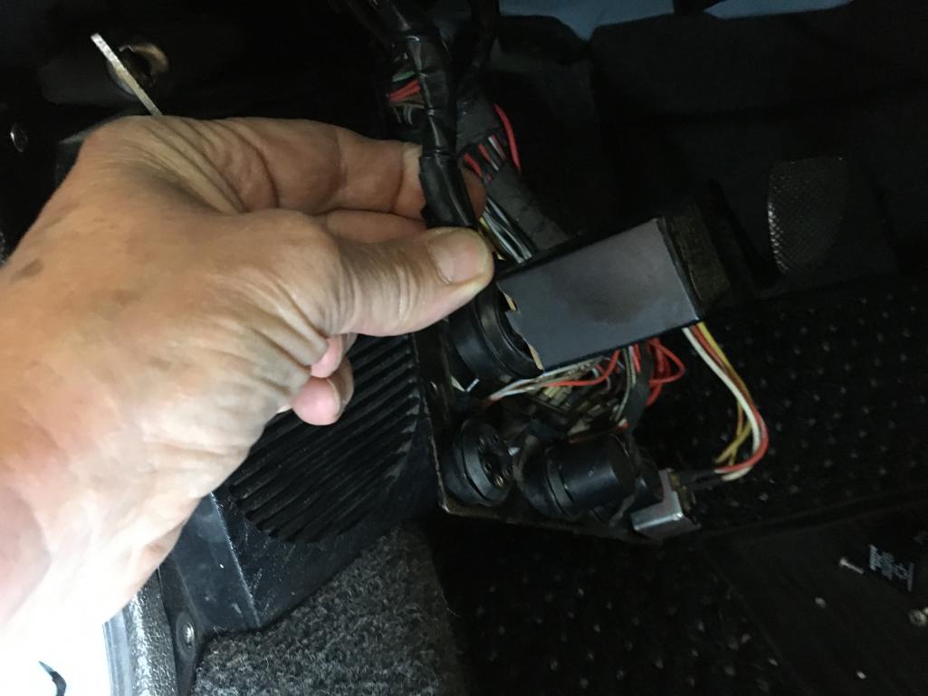

The first one is the high beam relay. If you manage to hook the flasher relay to that circuit, your headlights are gonna go all Disco on you!
Just an FYI for everyone here. The flasher relay was never mounted on the fuse panel. There is a hole in the dash frame below the switches. That holds the headlight flasher. The factory flasher relays were too tall to put on the fuse panel mount plate.
76-914
post May 12 2020, 09:24 AM
Posts: 13,880
Joined: 23-January 09
From: Temecula, CA
Member No.: 9,964
QUOTE(ClayPerrine @ May 12 2020, 06:12 AM) *
Pics? how was it attached to dash frame? Clip? Rubber grommet? TIA (IMG:style_emoticons/default/beerchug.gif)
