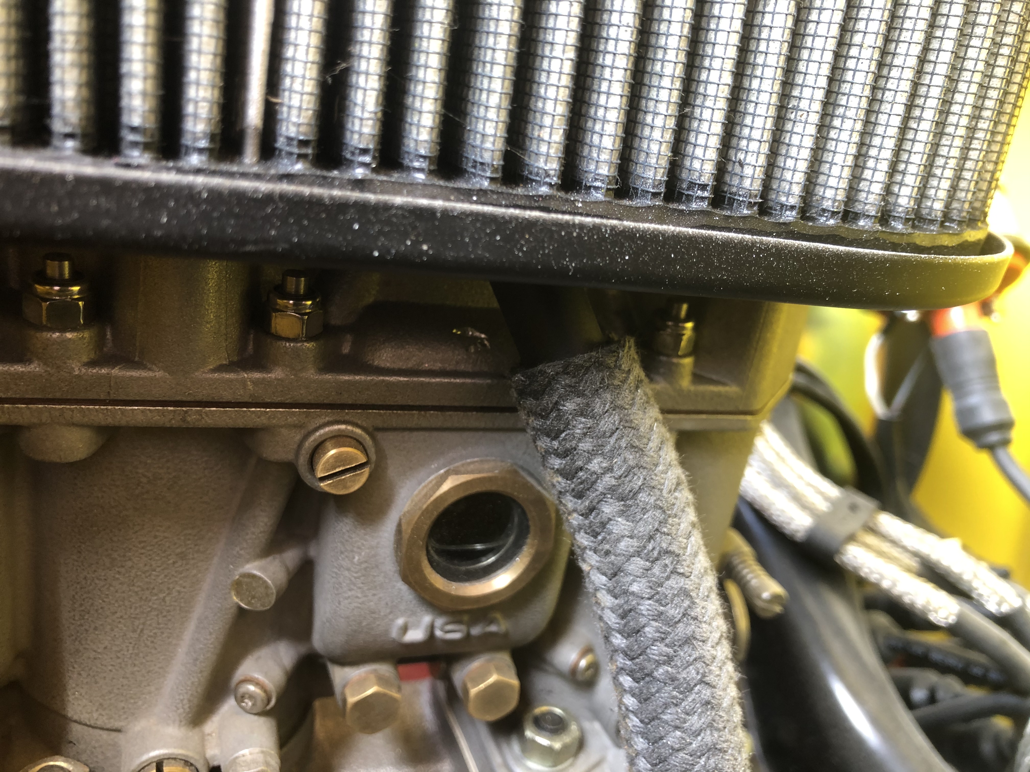

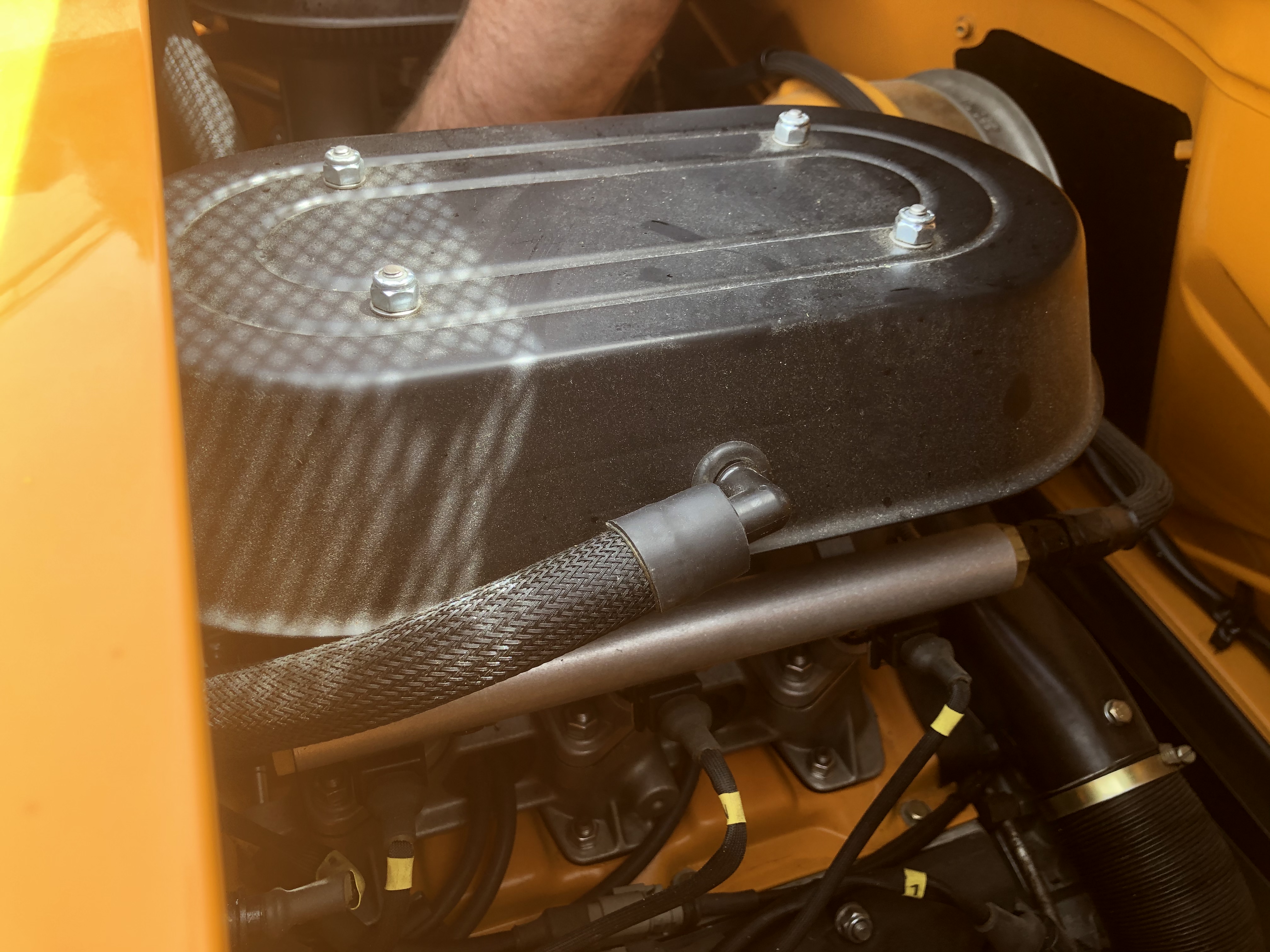

I always like to use them. It helps vent the fumes off the tank that create that old-car gassy smell and, there's usually plenty of places to add the fittings on the engine side. For 911 motors, we simply weld a tube on the plates coming off the fan shroud. That gives you the pressure needed to create the vacuum in the canister. Then you'll need to get the return line to vent into the intake before the MAF.
