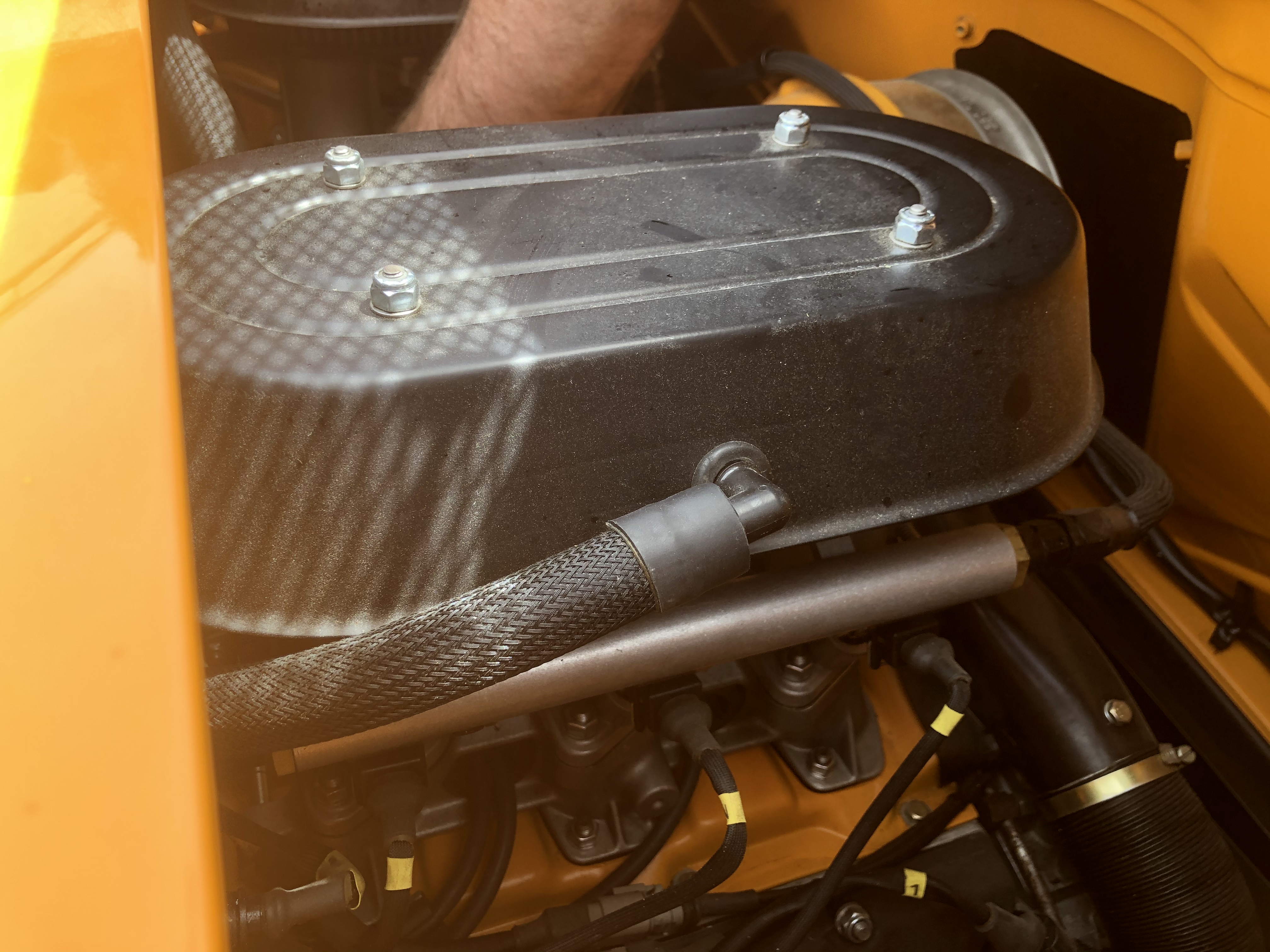

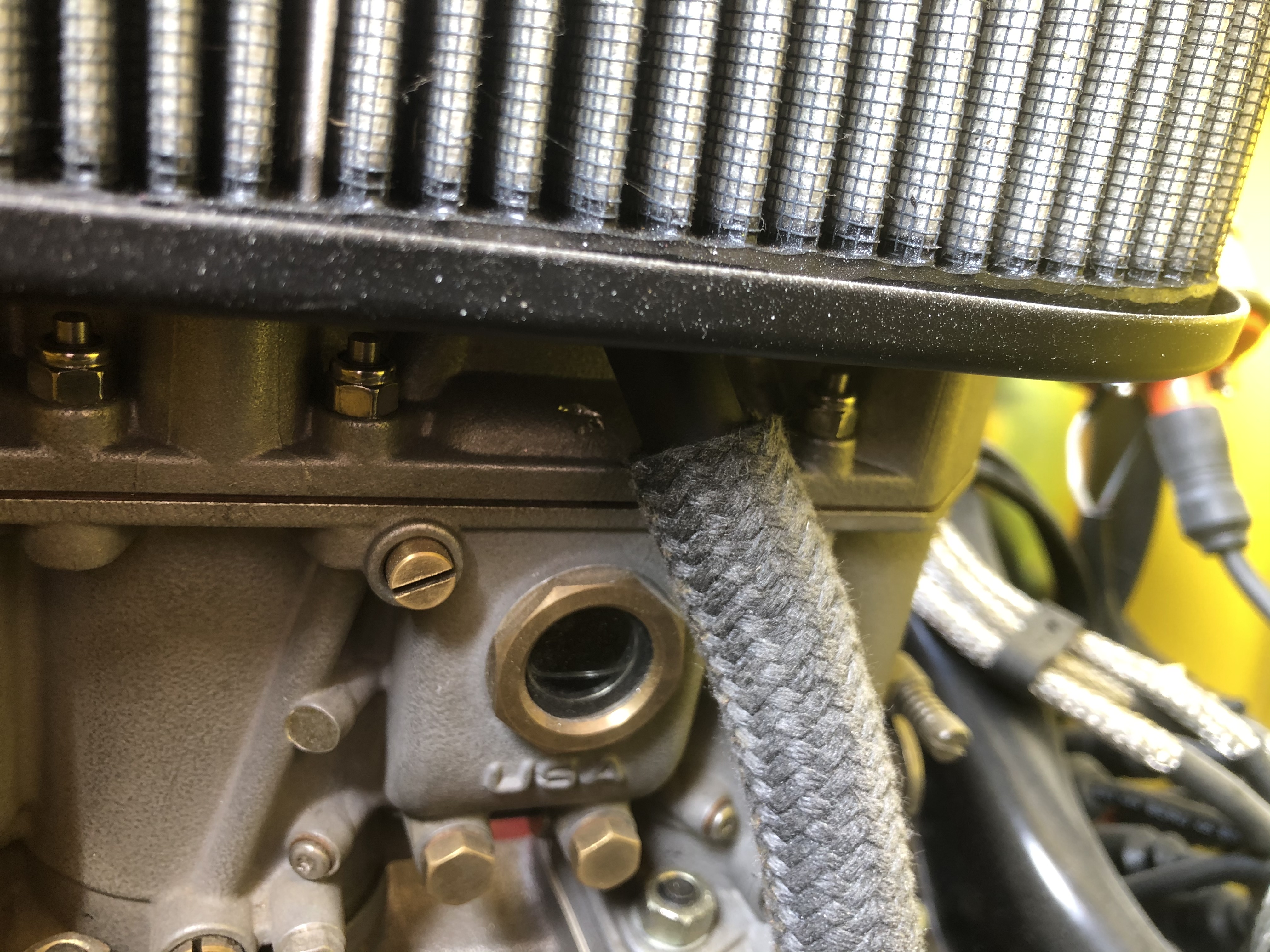

Eric_Shea
Bob’s vintage Sports Purpose air filters on PMO carbs. Base was modified to accept vent tube.
Kelly’s into more traditional watersheds on PMO EFI throttle bodies.
No pics of a Motronic system today.
