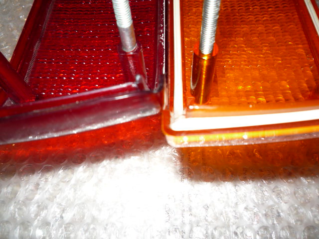

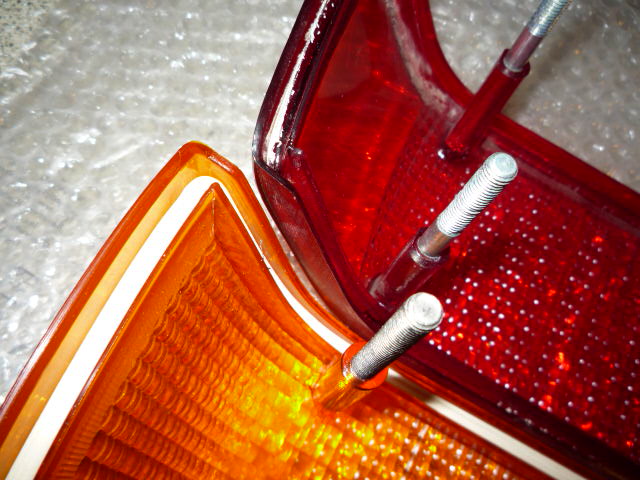

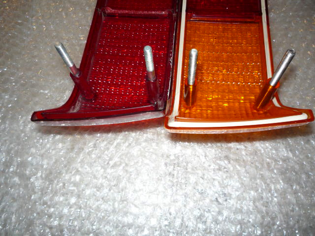

In an age of laser scanning and parts made to absolute tolerance, why are parts like this showing up? I received some tail light lenses from my German supplier. They were SUPPOSED to made by Hella with no markings. I have no clue why the parts were never checked against the original one. The corner bend is no where close and off by about 1/2". I am out $$$ om this deal. Posting pictures to show what I am talking about. Euro lens is the aftermarket.

Yes should be simple. The problem is if they are made like OEM there are 3 sections on each side. The inner, the outer and the reflector. To do it correctly the tooling has to be made to fit, beaning the shrinkage is allowed for. So far that has been the issue. That and not checking to fit on the car. I have yet to make these are there is supposedly "suitable" product on the market. I too have some coming from Germany, supposedly Hella.
This may get interesting.

The main issue is that they don't have Hella on them and they clearly don't want to be associated directly.
I've seen this before. Very well could be Hella running service parts off worn tools or with modern plastics that don't shink the same as 70's era materials. They know full well that parts aren't to print and don't want their name on them.
Alternatively, they really aren't Hella . . . China makes some really nice Chibson guitars. Very hard to tell at first glance that they aren't a real Gibson's. But those that know what to look for easily spot the fakery.
Either way it really sucks to be out real coin. (IMG:style_emoticons/default/ar15.gif)
I wonder can they be softened with a heat gun and carefully formed for a better fit?

Try the heat gun to soften the lens to see if you can shape them to fit the car.

Forgot to add, the posts do no line up either, causing bowing.

The problem is the point at which the plastic becomes pliable is close to the melting point.
If you were to try this the temperature needs to be consistent through the part. If you used an oven and started low (less than 300) you could try until you find the point it would work, but you may have issues with other dimensions too.
If you laid it onto a bucket to cool it would help. I'm interested to see how this works.

We see this too often. Bad tooling, so the whole run is bad. They sell it anyway, so they can recoup there costs. Very important to not buy parts and let them sit around. Test them out immediately so you can send them back. I made the mistake of buying parts for a project and then installing them a year later, only to find out there junk and can't return them.
