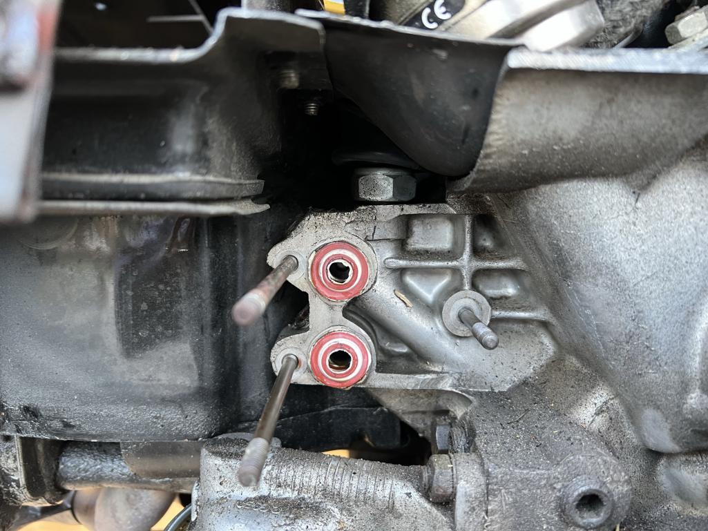

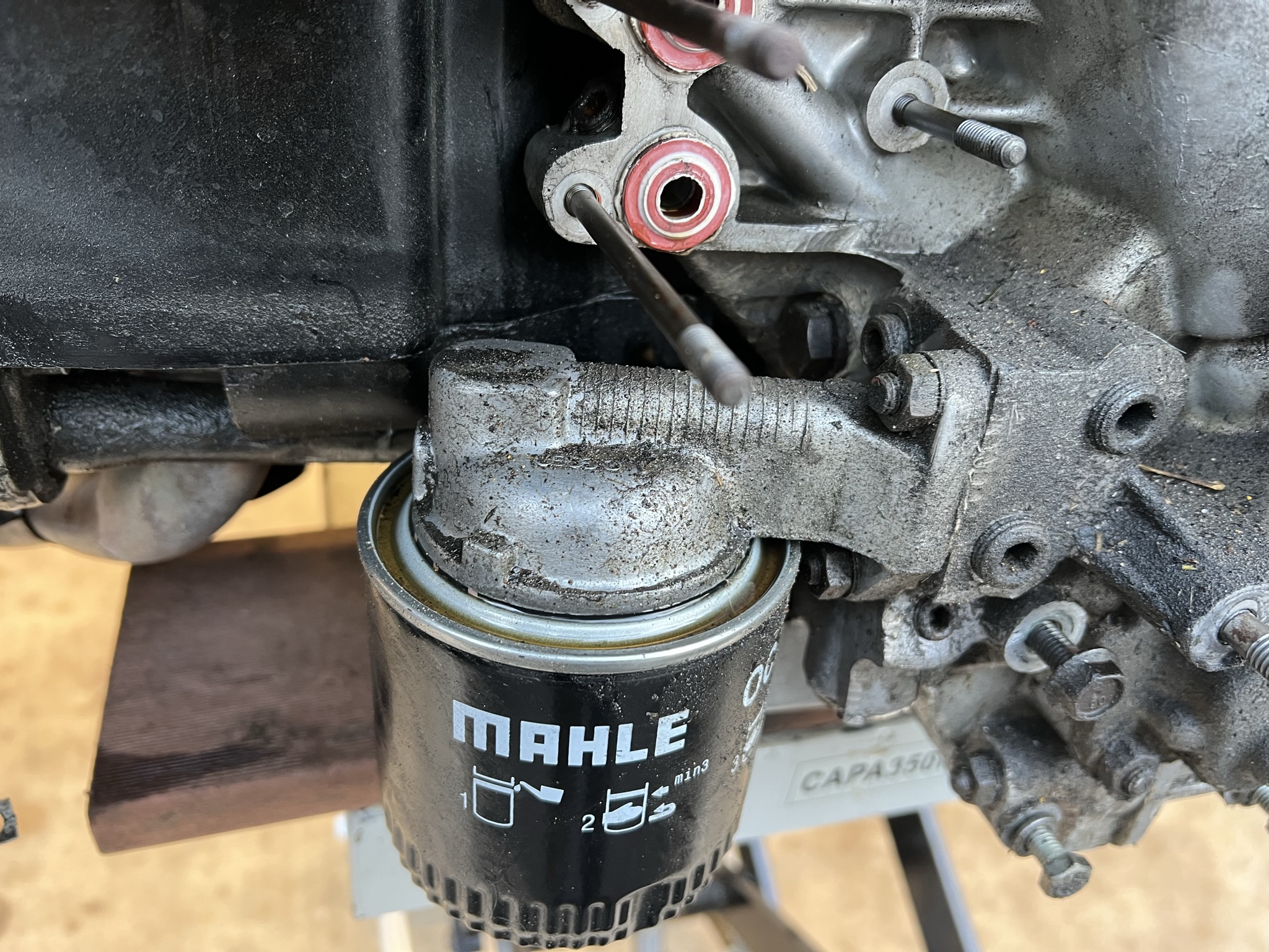

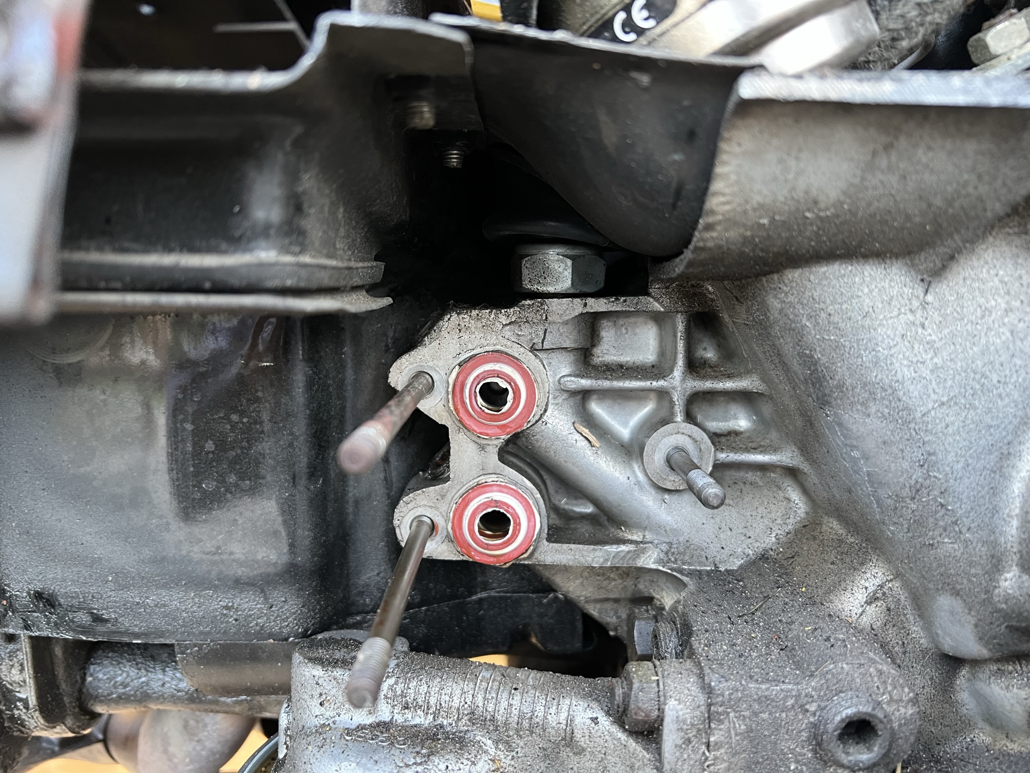

Rather than create a new thread, I am going to jump on an oil leak thread that is already out there that is in the same vein.
I've pulled the drivetrain to do some leak repair. I know I need to do pushrod tube seals and valve cover gaskets. I assumed I had oil galley plugs leaking and possibly oil cooler, so I pulled the shroud.
I have not cleaned the case, so the oil you see there is as it was when I pulled the fan housing. I see greasy engine but not the heavy dripping I see on the ground. I do see oil dripping off the filter bottom in the car and now seeing the top I see oil pooled on top of the filter stand. I do not see indications of oil coming from the cooler or cooler seals, the oil pressure sender, the oil filler box, etc.... (yes, the copious amounts of sealant used is cringe worthy and not my doing)
I have thoughts of stuck oil pressure relief valve, crack, warp, or defect in the filter stand, or filters that just don't seal. Has anyone seen this and root caused it?

There's at least a decent chance that much of your oil is coming from those seals that have the extra goop on them.
Hopefully that's not a crack I see where the oil pressure sender threads in.

Someone else just went through a similar leak with puddling on top of the oil filter.
Problem was oil filter was not properly tightened. Simple mistake.
Same thing going on here?
