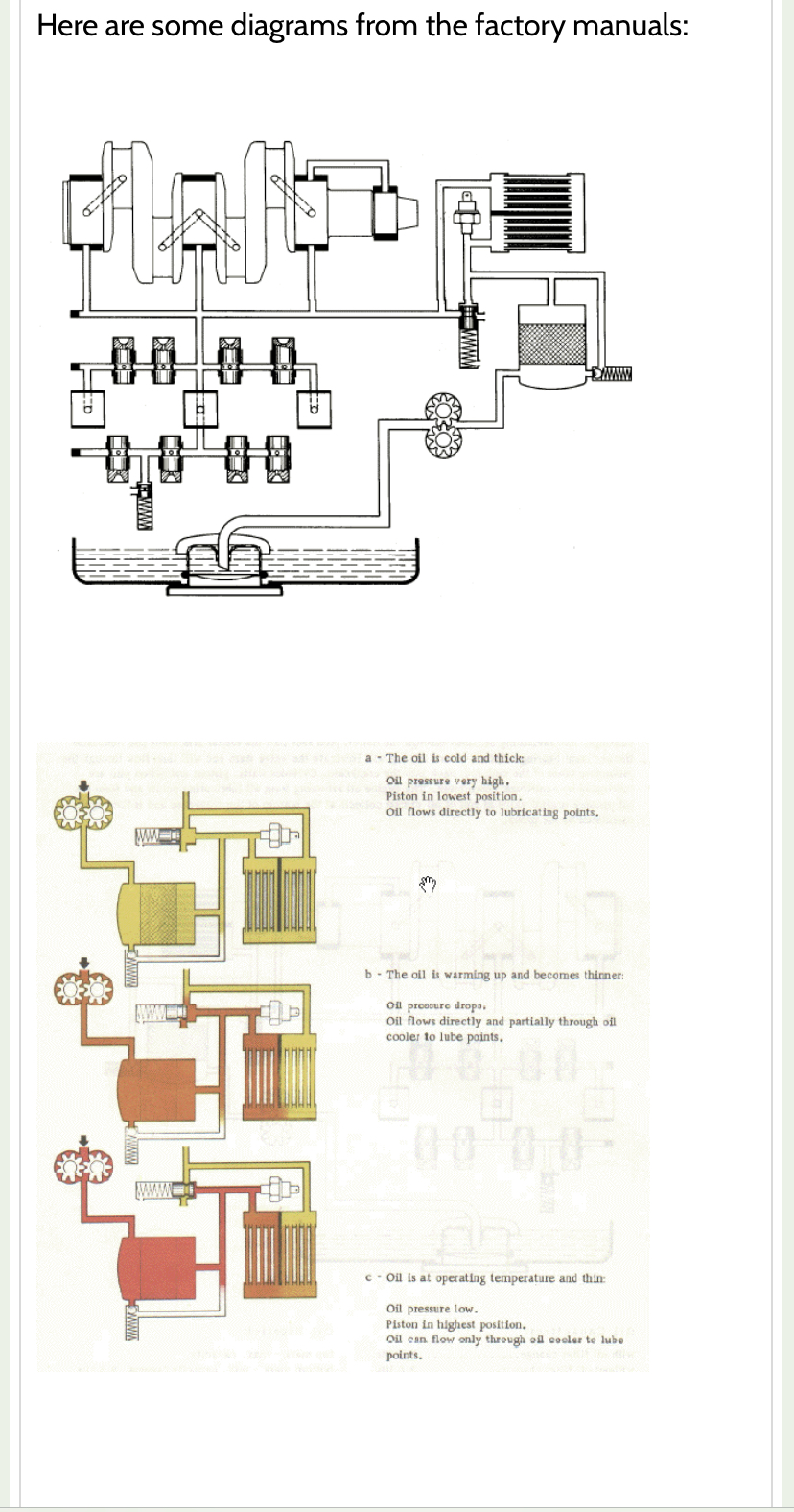

That was my first thought (hope) but the filter is snug and this has been leaking over the course of several oil filter changes.
I do have a couple spare filter stands. I am going to look very closely for defects on the sealing bead on the casting where it meets the filter, just to be sure.
You don't think that a stuck oil pressure relief valve pushing oil past the filter seal could be at fault? I hate to pull them if there is little to no chance but if someone thinks it is possible I will.
Would you pull all those threaded galley plugs and reseal them? If so, what sealant would you use? Sorry for all the dumb questions. Try not to be too hard on me. I've rebuilt 616 engines with no leaks so I know it is possible, but the galley plugs we use on those are press in replacements.

Oil pressure relief valve has no bearing on the oil filter seal. The oil filter always sees full pressure and does have its own bypass if filter becomes clogged and pressure is too high.
Far more likely to be those janky oil cooler seals. The galley plugs aren’t wet and have no direct path to deposit oil on top of the filter. I’d leave the galley plugs alone - don’t introduce new variables.
Clean everything well. Replace oil cooler seals and stay away sealants on them. Put UV dye in the oil.
Hopefully there is no leak. If there is trace it via the dye trail.
