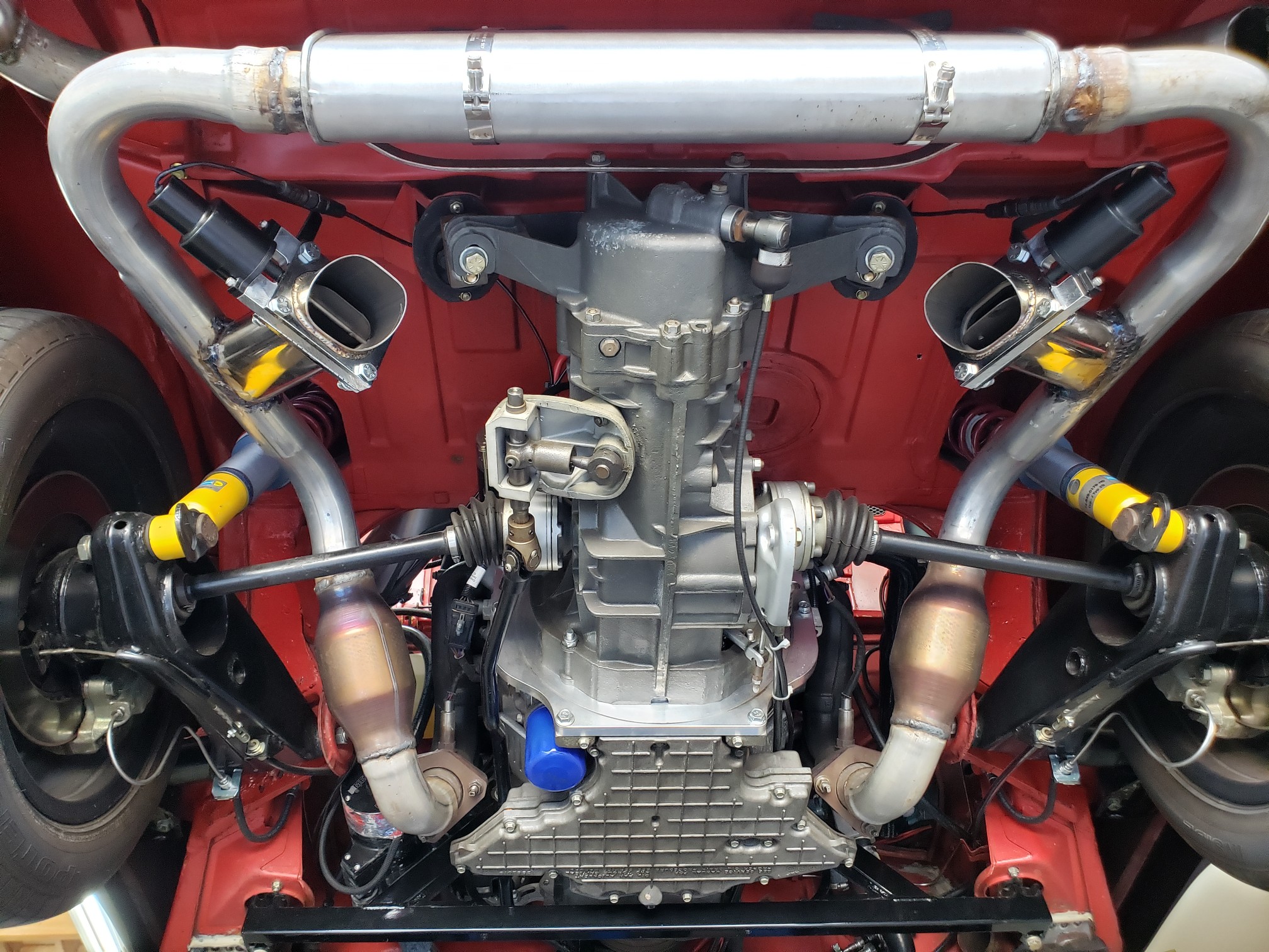

My Narp 914 SPORT MODE
Has this been done before?
Per Google: (Porsche Sport Mode)
SPORT MODE: The 'SPORT' mode is your perfect driving mode for more spirited drives through backroads or canyon passes. When selected, throttle response and shifts are sharper, the suspension is stiffer, sport exhaust valves will open, and dynamic engine mounts will engage.
My Narp 914 version:
SPORT MODE: The 'SPORT' mode is your perfect driving mode for more spirited drives through backroads or canyon passes. When selected, throttle response and shifts are sharper, the suspension is stiffer, Dual sport exhaust valves can be opened from 0 to 100% with a flip of a dash switch. and dynamic engine mounts will engage.
I installed this on Chucky (LS V8 powered) last weekend. YIKES…It worked!!! (IMG:style_emoticons/default/beerchug.gif)
I get to road test it tomorrow. Now, Chucky can live up to his split personality. (IMG:style_emoticons/default/calvin.gif) / (IMG:style_emoticons/default/cool.gif)
It took me an entire day to install and fab up brackets, plus the wiring. I only had .045 weld wire at home so not the prettiest, but sound. (IMG:style_emoticons/default/biggrin.gif) Sometimes I wish I had four hands. All deburred, may ceramic coat later. It’s also using a different ECU tune in Sport mode.
I plan to update to Holley Terminator ECU and harness after paint later this summer.
Wife said, Why? (IMG:style_emoticons/default/confused24.gif)
Oscar

wow! it will be nice to see it tomorrow running on the twisties! I can be in Oscar’s tale during the drive!

It will sound like a nascar! Got video ?

Nice and dry under there .

That is super clean, Oscar. Well done as always.

Cable "Open header" cutouts first innovated in the 1960's by one of my mentors Doug Thorley. He started putting 12v solenoids on them in the early '80s. Lots to be said about how adaptive the OE and aftermarket mfgs have integrated these into all sorts of modes via modern electronics.
This should be killer Oscar (IMG:style_emoticons/default/aktion035.gif)

You could tell that that car is NARP as there isn't a drop of oil anywhere to be seen!

Oh good lord Oscar...I love it!
I know it's not close ... but drive by my house and I will take a video (IMG:style_emoticons/default/smile.gif)
makes me think of the old days when we put cut outs on the old 55 Ford V8 with dual exhaust
had to get under the car to flip open but hey I love your electric flaps
please please make a video (IMG:style_emoticons/default/smile.gif)

Sweet! That looks really good Oscar! I can't wait to hear it! How about some in car audio too? (IMG:style_emoticons/default/aktion035.gif)

No car audio planned...in Prius mode you can easily hold a conversation with top off...in Chucky (Sport) mode use sign language to communicate with passenger.
Best of both worlds.
Next, after paint..hidden AC & Heat using existing dash vents.
Oscar

Looks great - look forward to the video. Should send the pedestrians running for cover! A flamethrower would be a nice touch too... (IMG:style_emoticons/default/boom.gif)

I can remember JC Whitney sold those that were cable operated. Open and close them while sitting at a long stop light. Make the other drivers think they're going crazy. (IMG:style_emoticons/default/blink.gif) Your car looks great Oscar. (IMG:style_emoticons/default/beerchug.gif)

We need a video man! Looks awesome. This off course can also be done on a 4 banger... (IMG:style_emoticons/default/idea.gif)

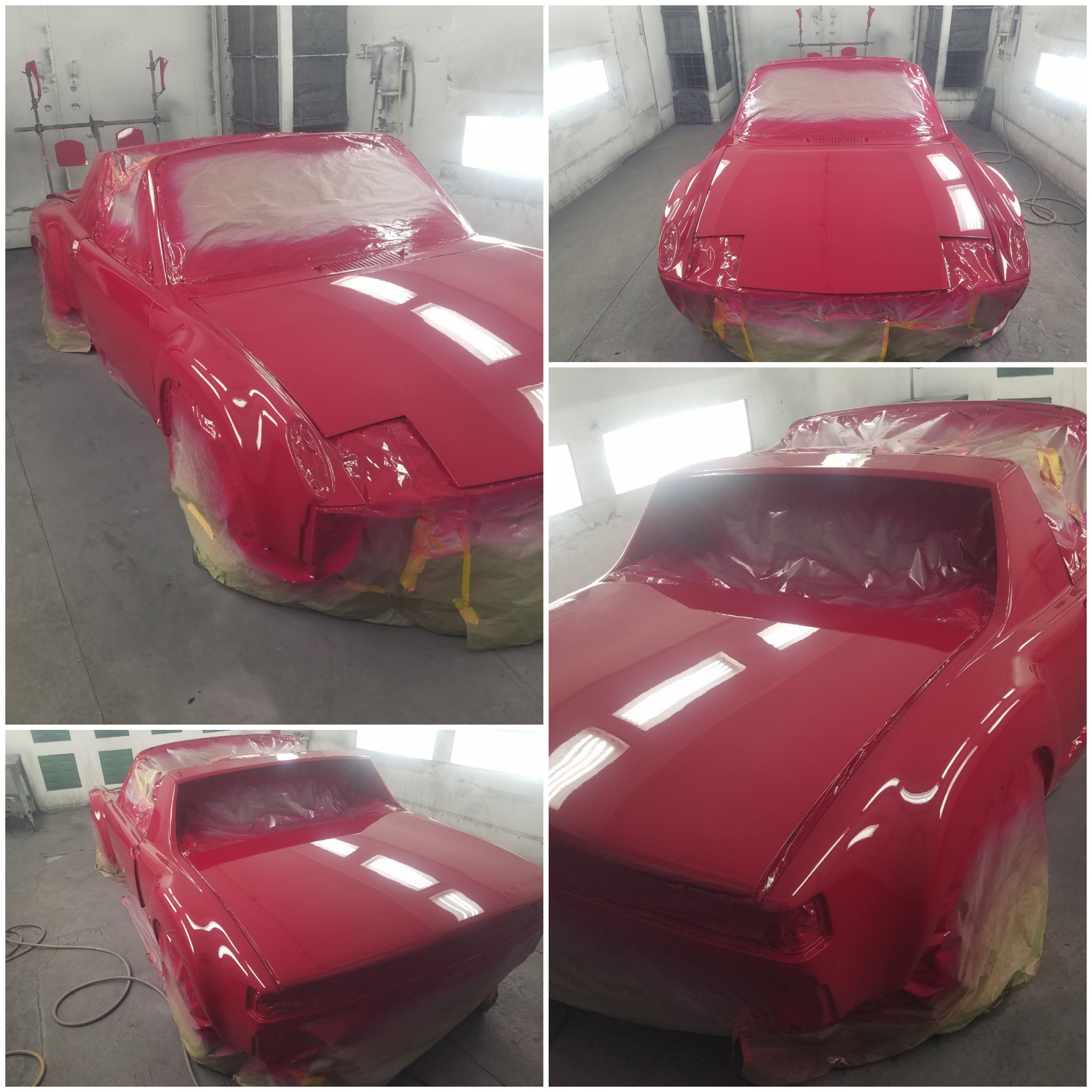

Chucky got lipstick today....with luck I can make WCR 2020 in November.
My high-school friend who owns the paint shop promised 2-3 week turnaround , but at 6 weeks now. I guess I'm fortunate.
