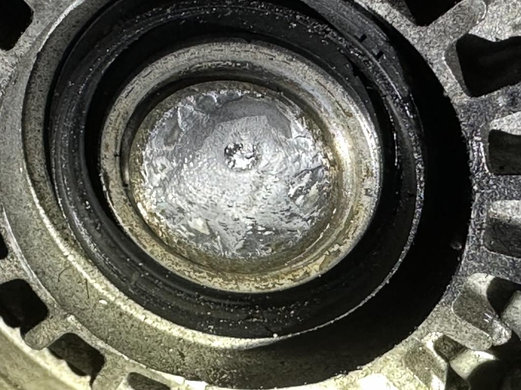

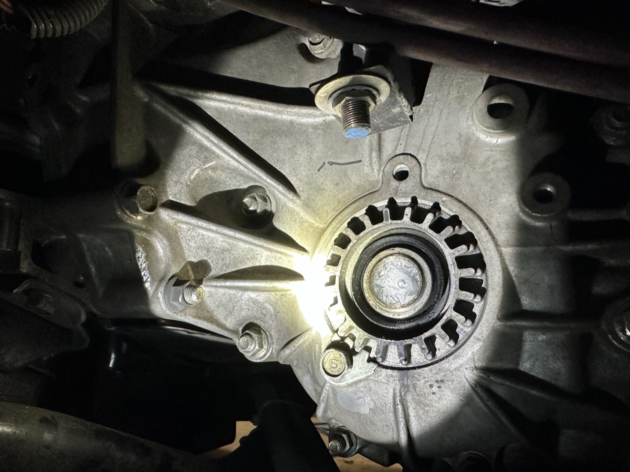

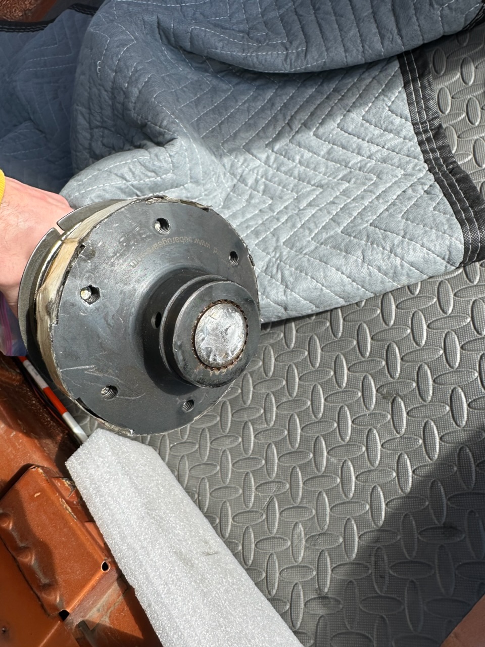

waltonsm   PSA… Sheared off a diff stub axle this weekend....   Mar 28 2023, 02:05 PM
East coaster   Ouch!   Mar 29 2023, 04:36 AM
jd74914   Did that shear at a snap ring groove   Mar 29 2023, 06:55 AM
waltonsm   The fracture occurred at the the small diameter of...   Mar 29 2023, 11:13 AM
waltonsm   Did the work to swap the stubs this morning. Start...   Apr 8 2023, 08:12 PM

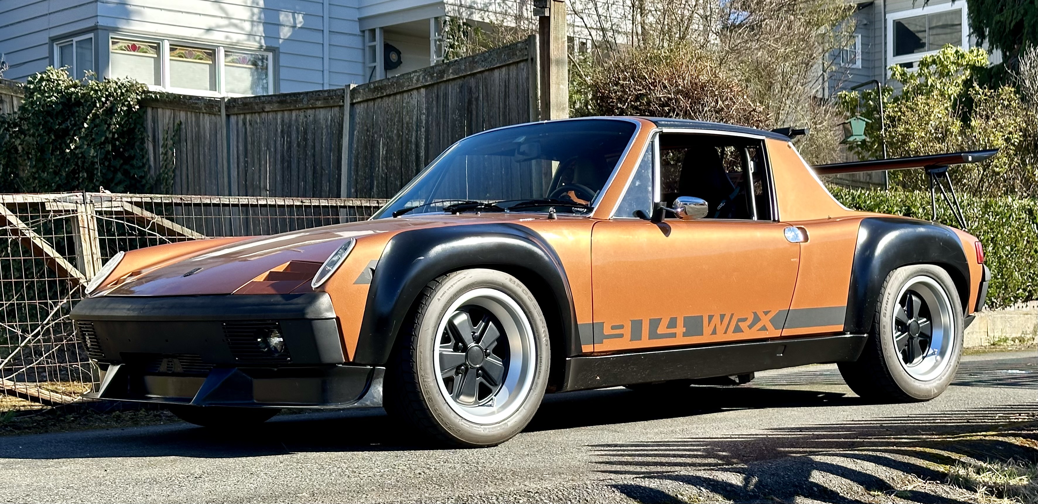

waltonsm   And back on the ground.. with wider front track. A...   Mar 17 2024, 07:55 PM
sb914   And back on the ground.. with wider front track. ...   Mar 18 2024, 06:26 AM
DRPHIL914   Looking good!! :headbanger:   Mar 18 2024, 06:25 AM
East coaster   What goes up must come down…….are you planning...   Mar 19 2024, 05:21 AM
waltonsm   Absolutely will lift it again. It was super fun wi...   Mar 22 2024, 11:53 PM
