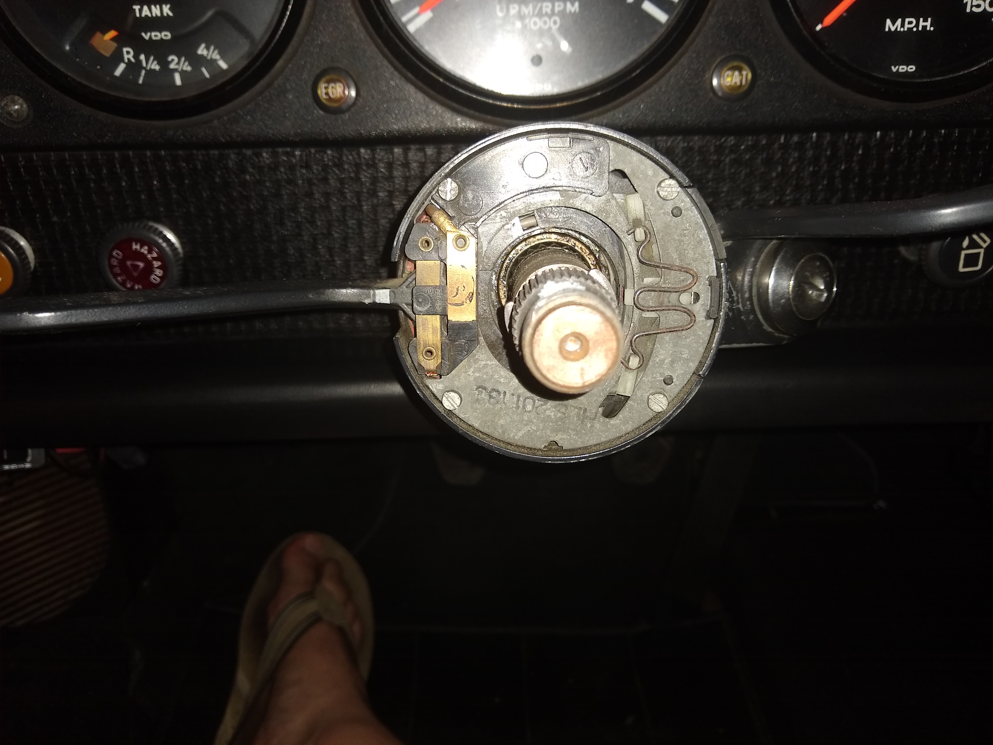

Additionally, my horn doesn't work. I attached a picture below. It looks like the brass colored arm has been removed or sheered of. Will that affect the performance of the canceling tab?

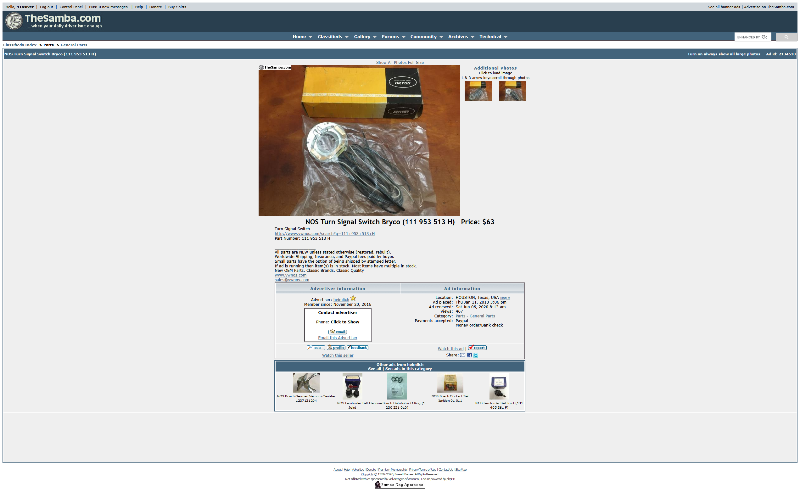

Early cars are SPECIAL. You might be able to get away with this switch. You will have to make sure wiring matches up though or get creative. Pull screws and see if the back matches up. Click on screen shot to open up

The broken contact is the reason you have no horn as you have no contact on the slip ring,this is usually cause but no lube,the tab wears and breaks off.

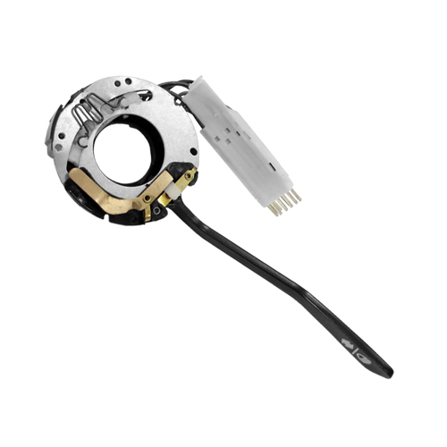

your pic is of a 75 76 model with the horn contact tab broken off

All you can do is buy a new turn signal switch. The missing tab acts as a spring loaded contact that slides against the turn signal ring on the back of the steering wheel. Without it, the horn will never work. And they can't be bought separately.

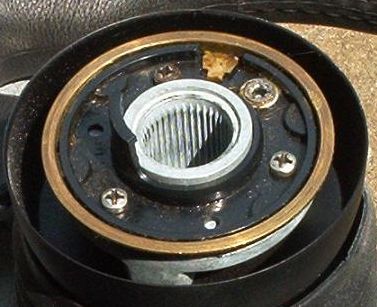

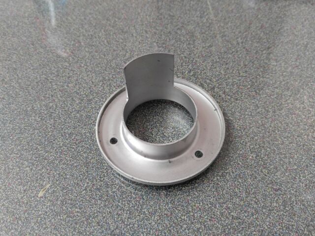

Example of what I am talking about below. Perhaps a later model turn signal and cancel ring tab was needed to accommodate the steering wheel and adapter.
This is what I have currently on my adapter:
This is PT# 914.347.835.00 which appears to have a longer cancel tab. It is listed as an early model part:

I haven't done it yet, but in theory if you put flat washers on the screws behind the cancel ring, on the back side of the steering wheel adapter, it will be just enough to catch the cancel ring tab on the turn signal mechanism.
The screws in questions are the phillips screws in the picture below. The washers would have to be between the black cancel ring and the back of the adapter.

Update: I put 3 flat washers on each screw that mounts the cancel ring to the steering wheel adapter. It is cancelling intermittently now.
The tab on the cancel ring isn't hung up on anything I can see. Tomorrow I am going to try to see if just one or two washers per screw will work better.
