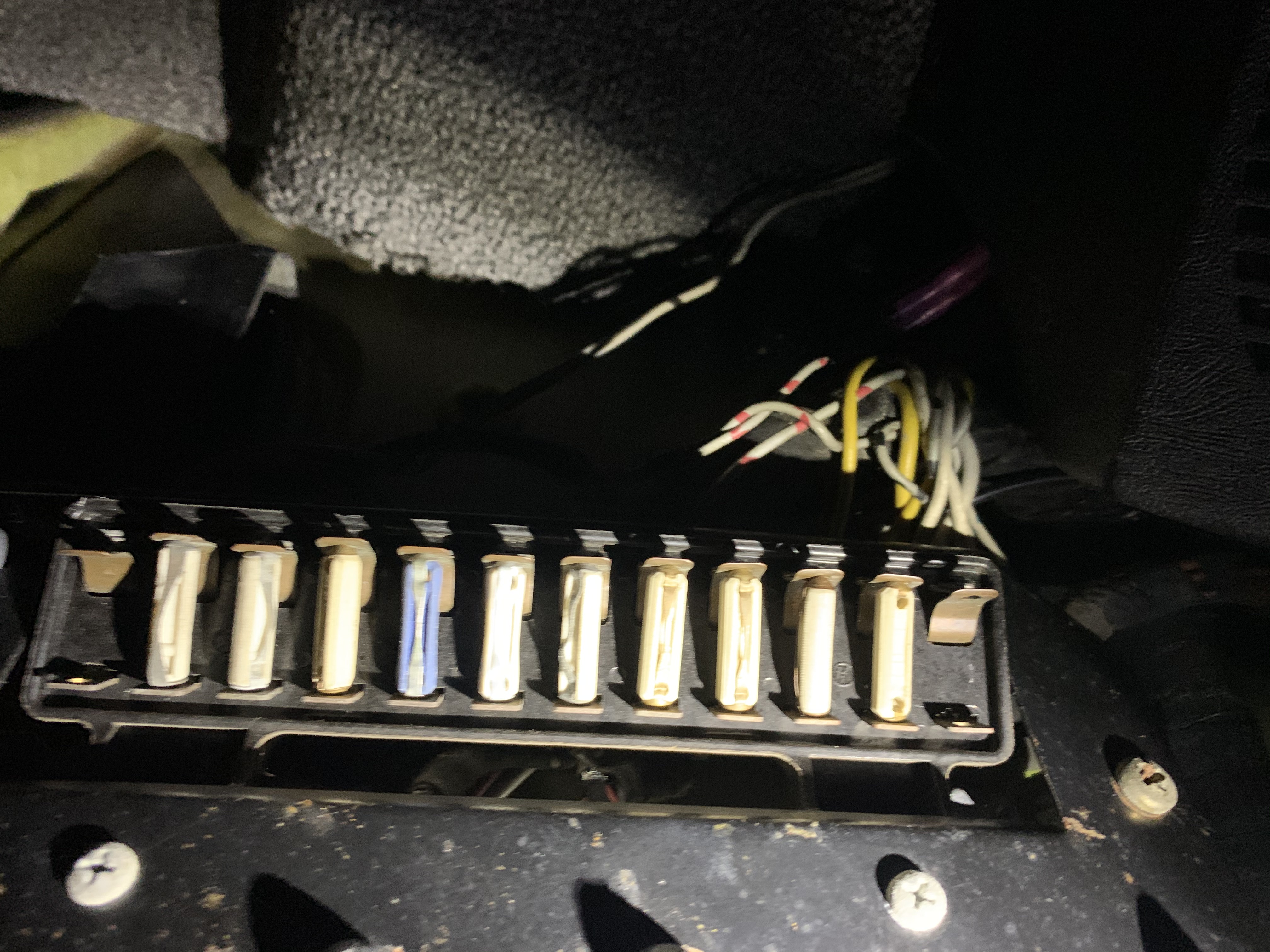

johnpierre
post Jun 23 2020, 09:40 PM
Posts: 401
Joined: 11-September 12
From: culver city, ca
Member No.: 14,913
hey there - thanks for all the help
here is what i found based on your help.
#1 im pretty sure the fuel pump is priming - i can here the low whine when i turn the key
#2 checked all the fuses and they all look old but non blown, i turned each fuse to see it that would make a better connection
#3 it looks like im missing a fuse on either end - not sure i even know it they where there to begin with
$3 looked at the coil and it all seemed to be connected, no lose wires
#4 i did find a vacuum hose that is not connected, i can't seem to figure out where the hell it connects to however it is coming from a long black straight tube that is at the front of the engine bay
#5 checked tank to make sure there was fuel - there is
#6 there are only 10 fuses and i could not see any numbers anywhere - must be on the plastic cover that departed me some time ago so i don't know where fuse controls the pump
here are some pics to see if you can see something i did not

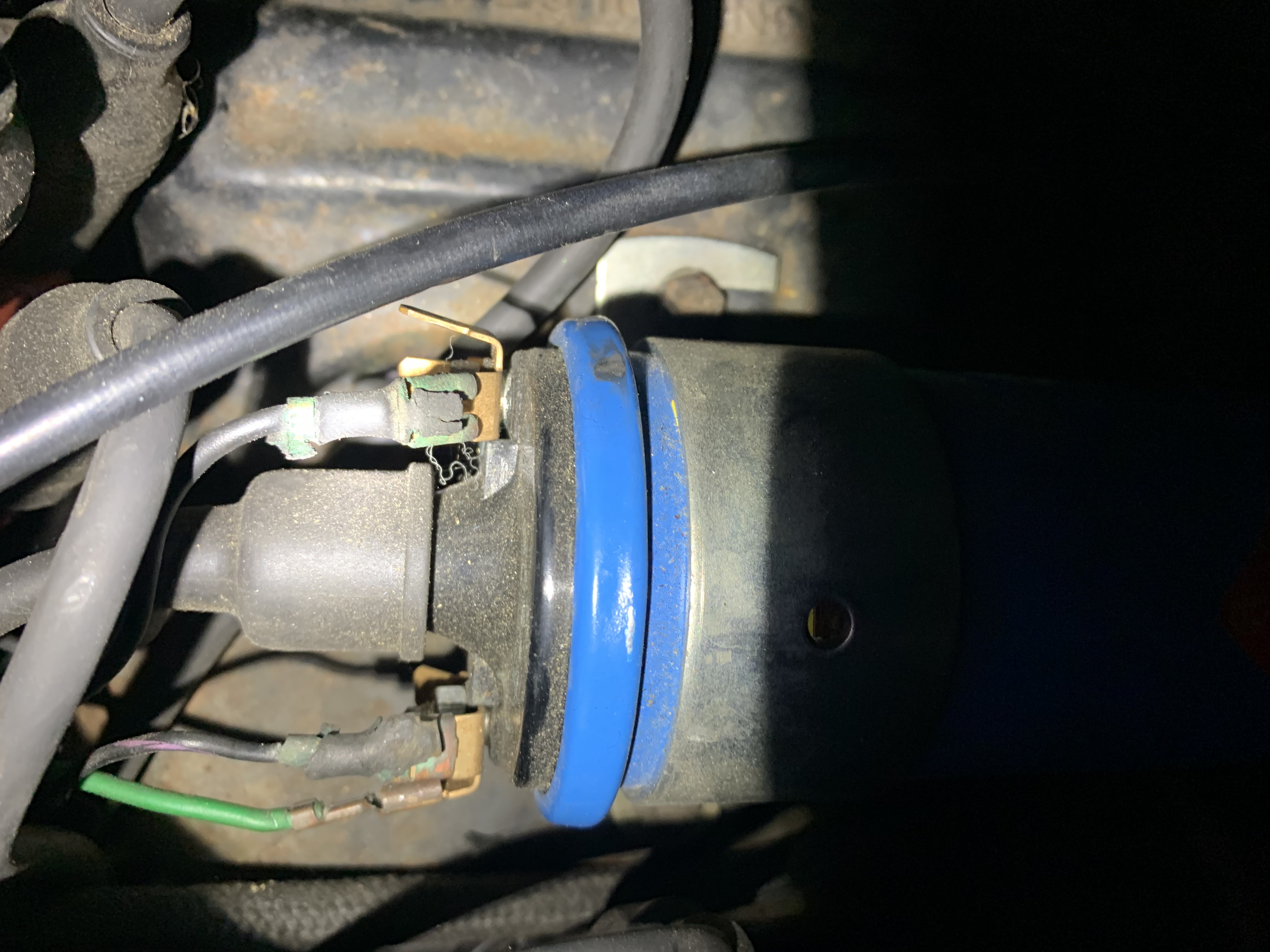

johnpierre
post Jun 23 2020, 09:41 PM
Posts: 401
Member No.: 14,913
the coil presumably...

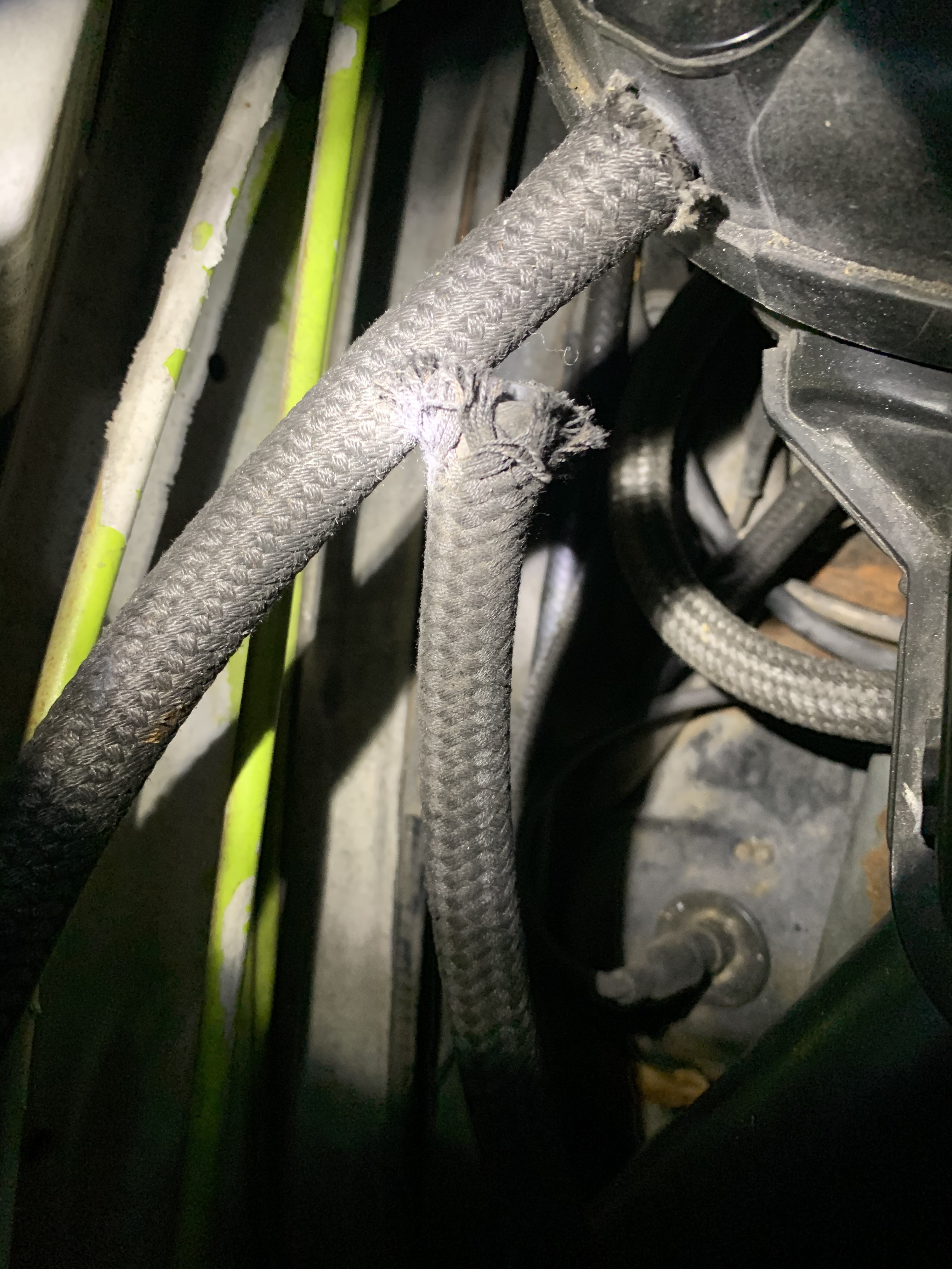

Member No.: 14,913
vacuum hose to nowhere

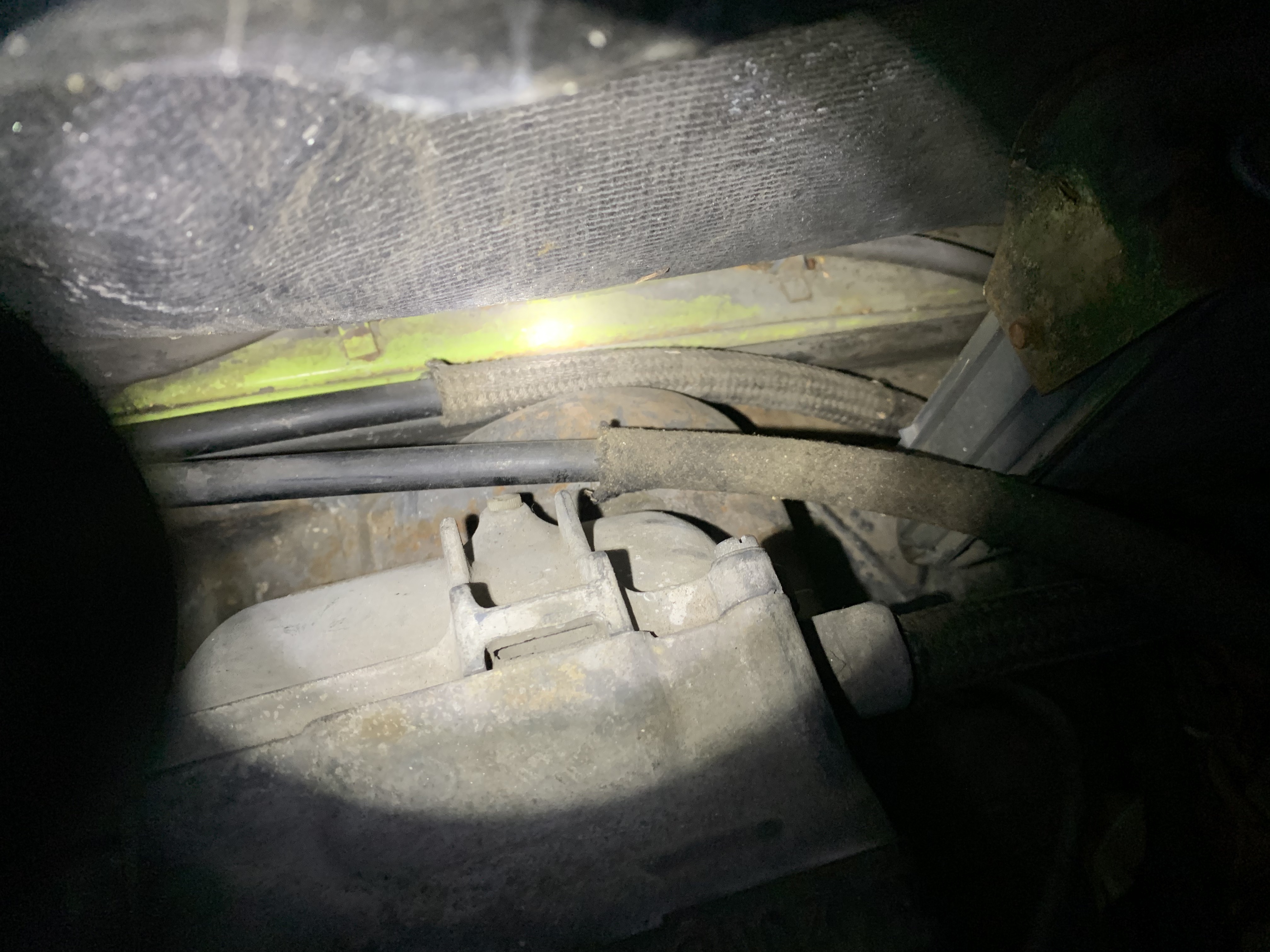

johnpierre
post Jun 23 2020, 09:43 PM
Posts: 401
Member No.: 14,913
this is where the vac hose begins

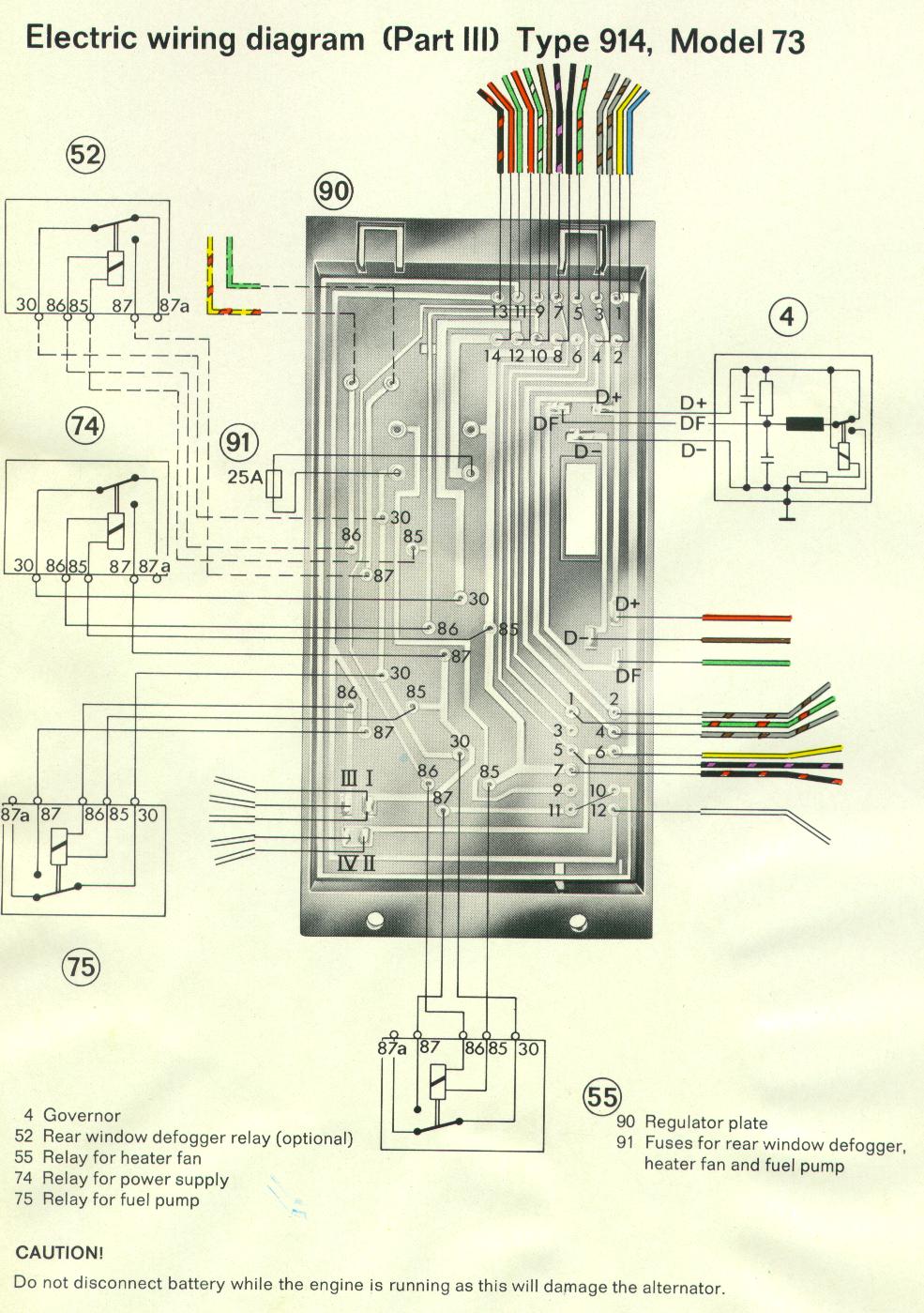

914_7T3
post Jun 23 2020, 10:53 PM
Posts: 1,899
Joined: 3-April 17
From: Los Angeles, CA
Member No.: 20,991
QUOTE(johnpierre @ Jun 23 2020, 08:40 PM) *
Here are the fuse locations for a '73 from the owners manual. Looks like you are missing the left high beams (white 8 amp) and headlight motors (blue 25 amp)
As for fuel pump relay, you can reference this relay board diagram showing the underside to help identify the loacation.

ndfrigi
post Jun 24 2020, 01:28 AM
Posts: 2,993
Joined: 21-August 11
From: Orange County
Member No.: 13,474
QUOTE(johnpierre @ Jun 23 2020, 08:43 PM) *
that is the line for charcoal canister and not really affect the issue you are having now.
