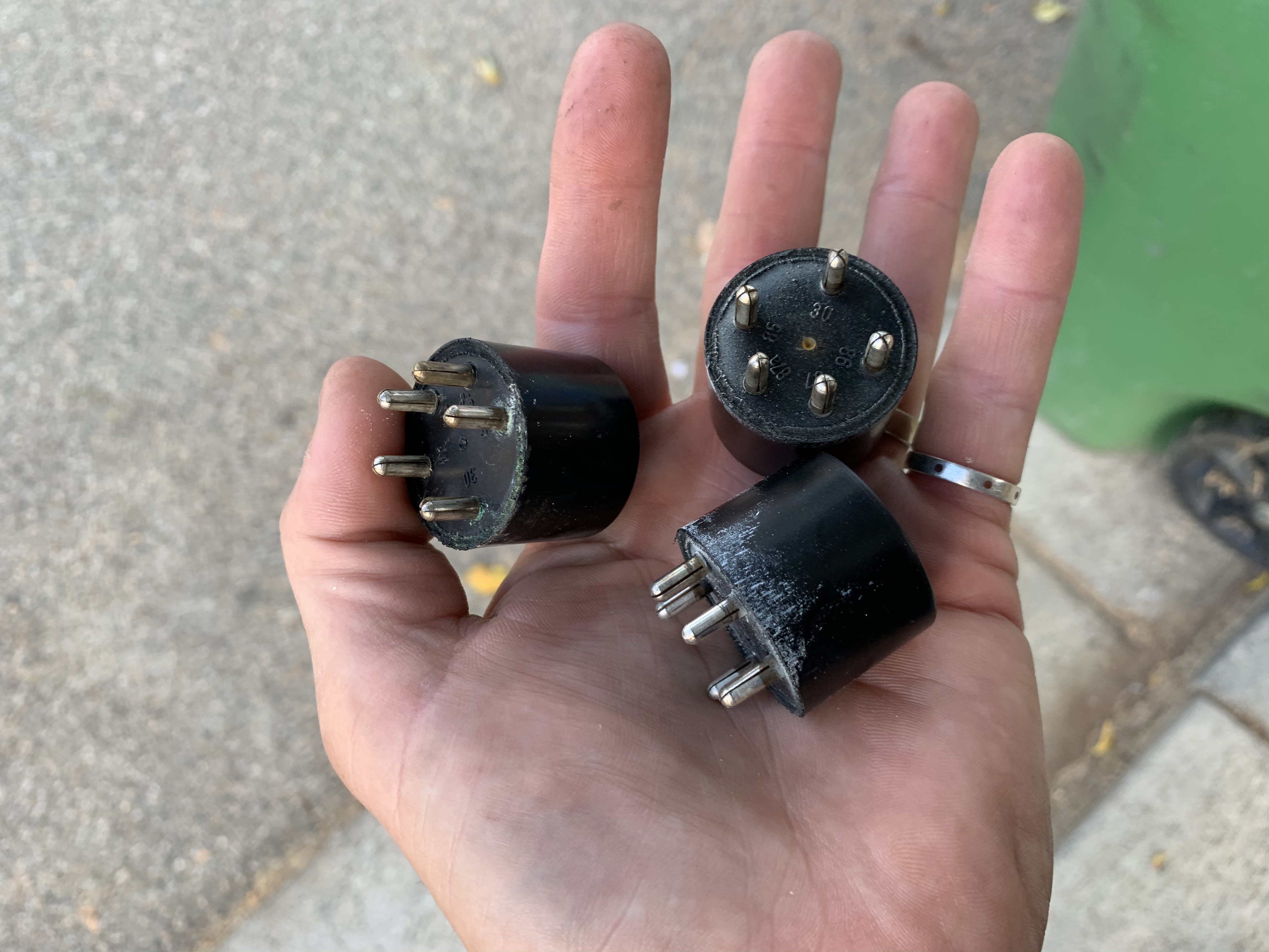

johnpierre   ok here is the update: found the relay board - th...   Jun 24 2020, 12:31 PM
mrholland2   ok here is the update: found the relay board - t...   Jun 24 2020, 04:42 PM
johnpierre   so here is the update: fuses arrived from pelican...   Jun 25 2020, 08:26 PM
johnpierre   old relays   Jun 25 2020, 08:28 PM
johnpierre   relay board with new relays installed   Jun 25 2020, 08:29 PM

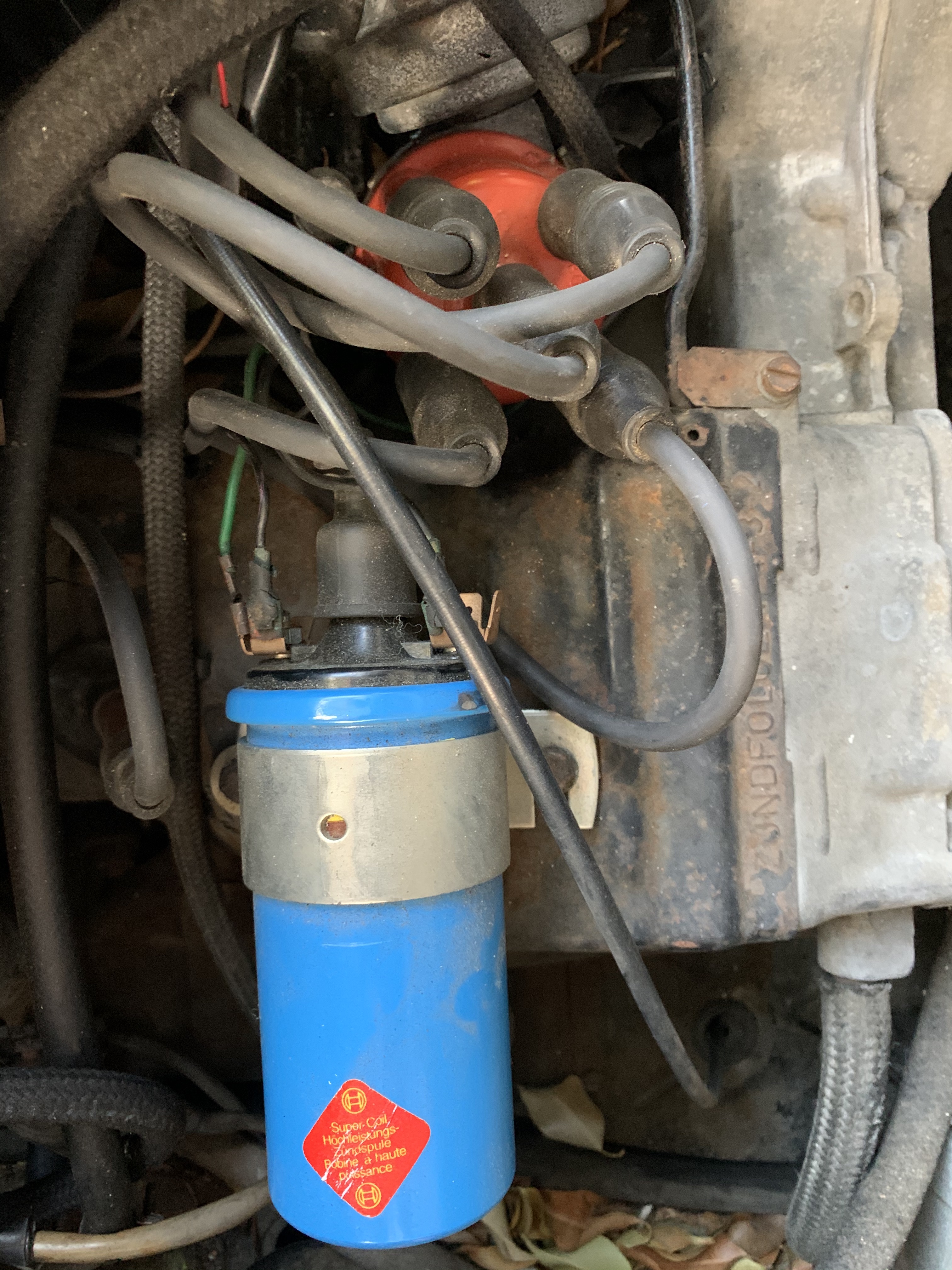

johnpierre   coil / distributor cap area - looks to be ok right...   Jun 25 2020, 08:31 PM
type2man   Remove the intake and pour fuel into the throttle ...   Jun 25 2020, 08:48 PM
johnpierre   Remove the intake and pour fuel into the throttle...   Jun 25 2020, 08:53 PM
johnpierre   Remove the intake and pour fuel into the throttle...   Jun 26 2020, 11:41 AM
