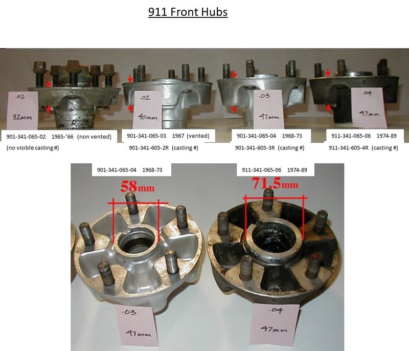

Just though I would post up some information for those doing 911 front hubs and the differences.

Awesome summary of hubs -- Thanks for posting.

Very timely and useful information - thanks. I'm just trying to source another hub for my 5 lug conversion and thought all I had to check for was '47mm'.
Couple of extra questions if I may - firstly what's the significance of the .03 and .04 numbers ?
Secondly the 58mm and 71.5mm dimensions - do they locate into the centres of certain types of wheel ? I'm fitting cookie cutters for now.
Thanks

03, 04 just indicate different versions of hub. As shown, the 03 has small 55mm diameter bearing cover and the 04 has the larger 71.5 mm cover. Your cookie cutters will work with no problem.

@andrewb
' date='Jun 27 2020, 12:54 AM' post='2828507']
Thanks
[/quote]
The grease caps are different.
One goes inside of the raised boss and one goes over the boss. I may have a single i can sell. You could mix an 03 and 04 with no problems.

Hubcentric

'914Sixer'
Thanks Mark.
'bdstone914'
Thanks to you also Bruce - that was my next question. And thanks for the offer but I'll try and find one this side of the pond. Just out of interest over here they seem to go for £75 to £150 depending on condition etc.
