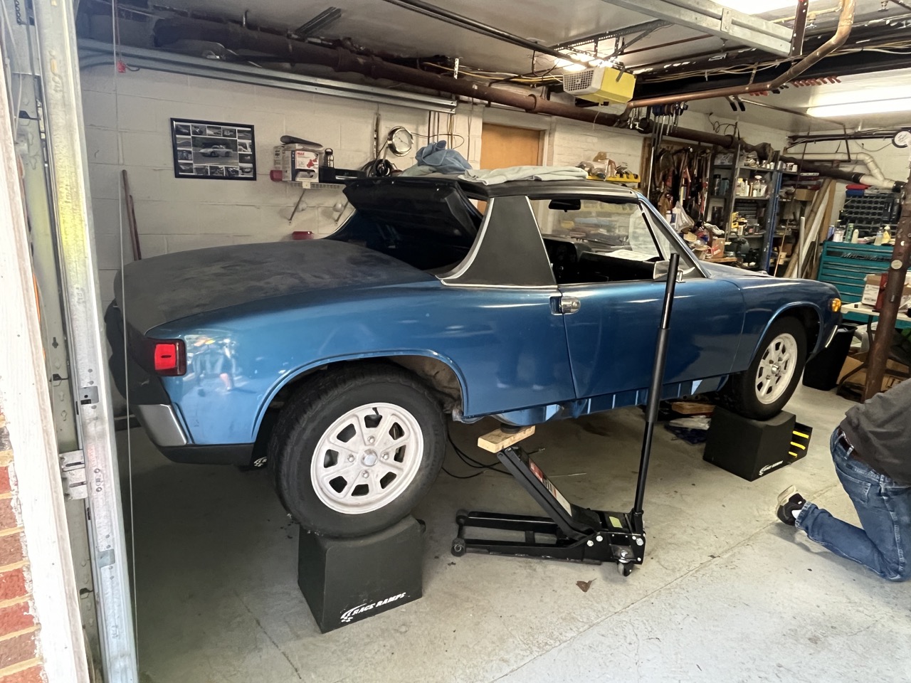

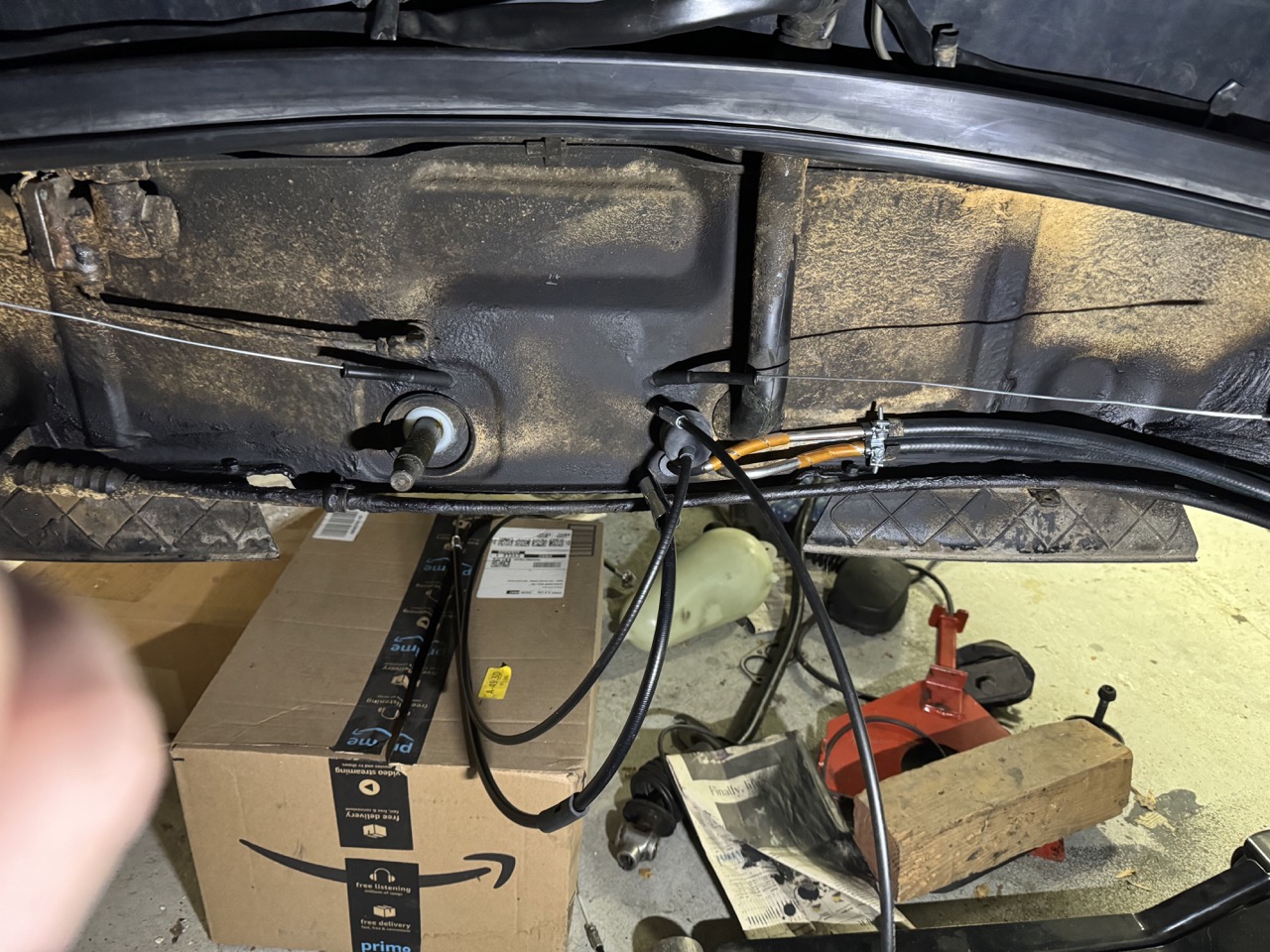

So, I bought a "new" 914 a few weeks ago (a '73 2.0). When I received it from the shipper, I noticed was the seller was quite artful about his pictures, with what was and what wasn't shown. And, now that I've had a chance to start taking things apart, I have uncovered quite a bit of DAPO-done-damage, and I'm sure there's more hiding somewhere (oh boy! something to look forward too....). Some of the damage appears to have been there for a loooong time.
I've already received a piece from a scrap car to fix this hole:
Once I took the rockers off, I discovered this:
Yes, they hole-sawed through FOUR layers of sheet metal, including the heat duct. Not sure what they were thinking, but there it is.
In the trunk, I found three hole-sawed holes. I think they might have been thinking about mounting the fuel pump in a 75/76 blister, but they never finished the work (and also picked the wrong location).

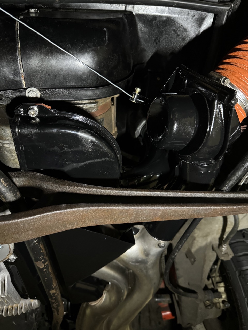

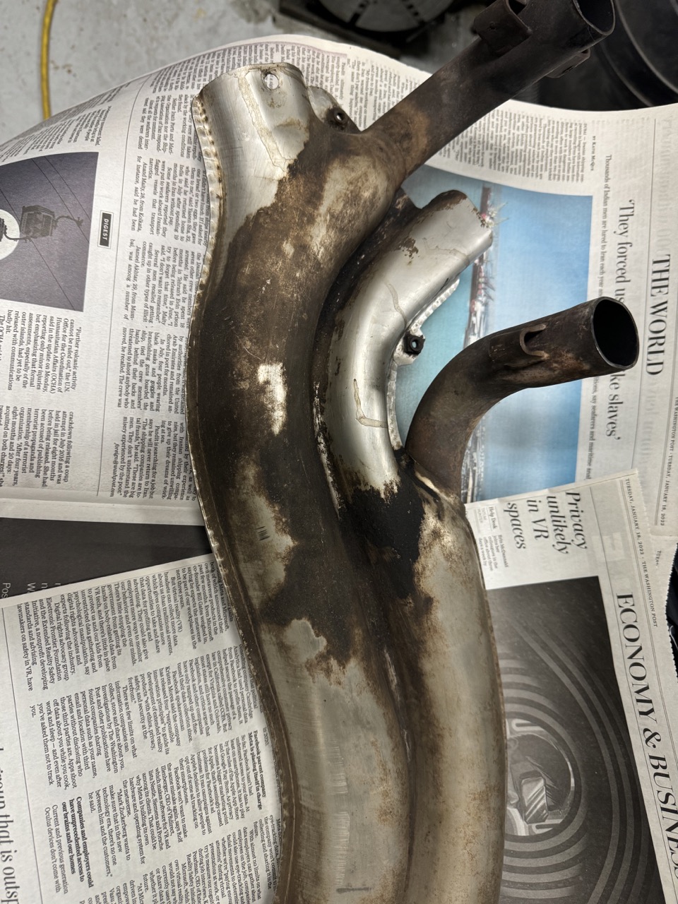

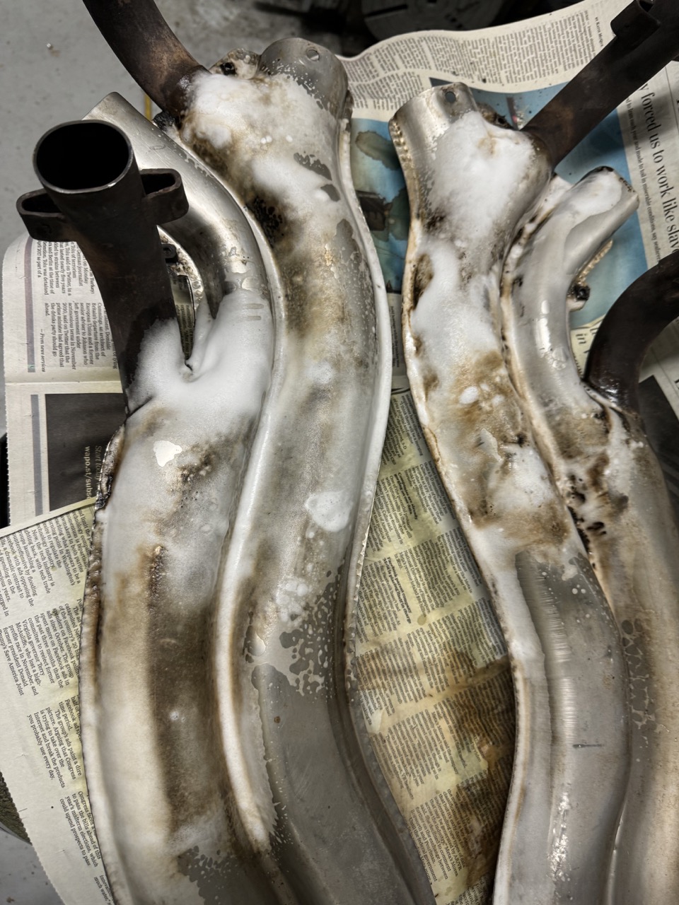

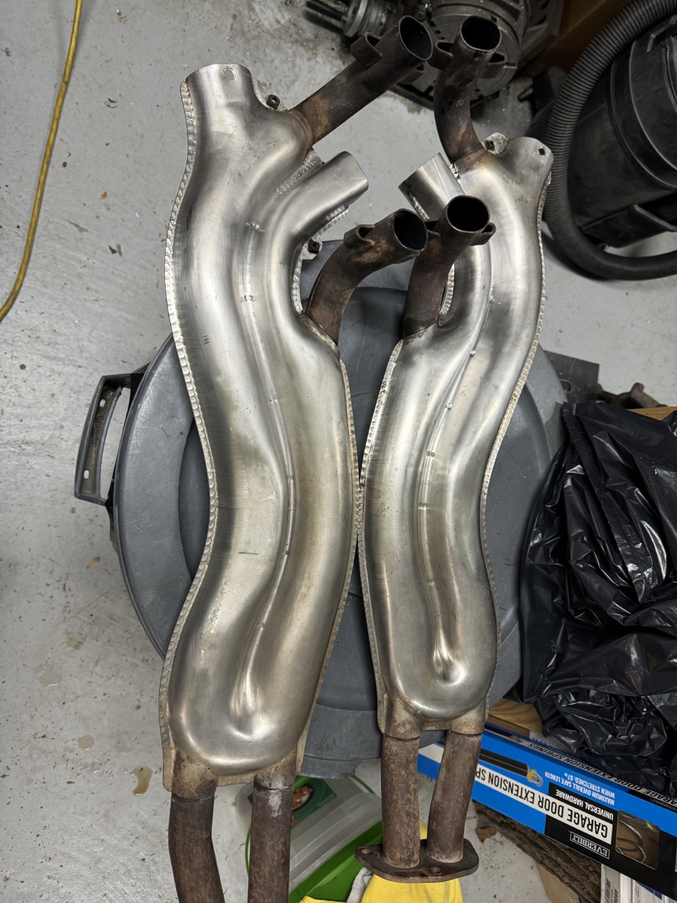

BillC   So, continuing down the list of discoveries: Ther...   Jun 27 2020, 06:23 PM
barefoot   The 1.7/1.8 SS heat exchangers have the same tub...   Jun 28 2020, 01:35 PM
BillC   The 1.7/1.8 SS heat exchangers have the same tu...   Jun 28 2020, 05:48 PM

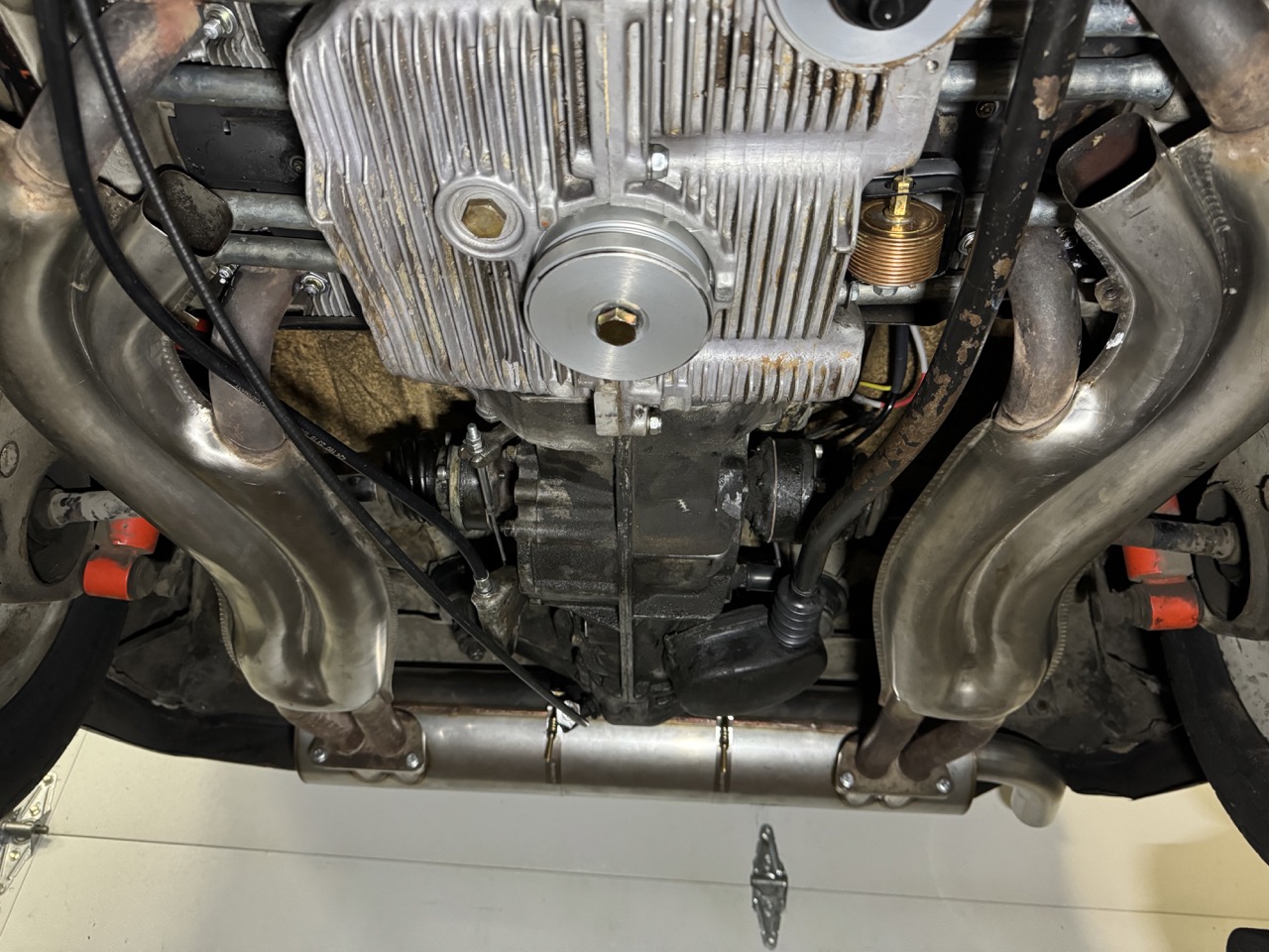

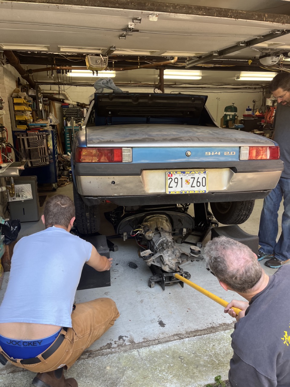

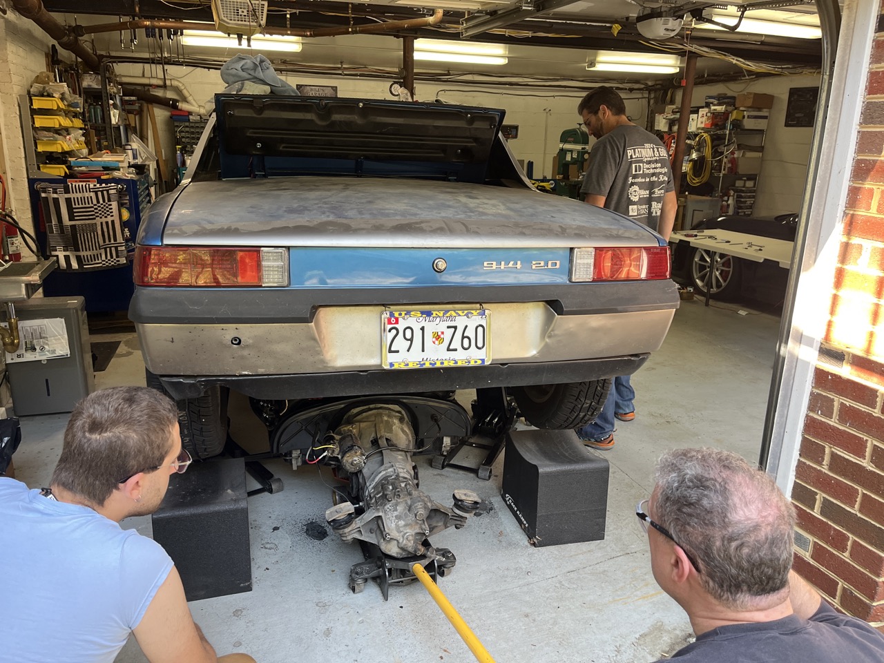

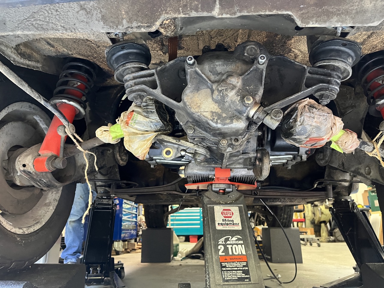

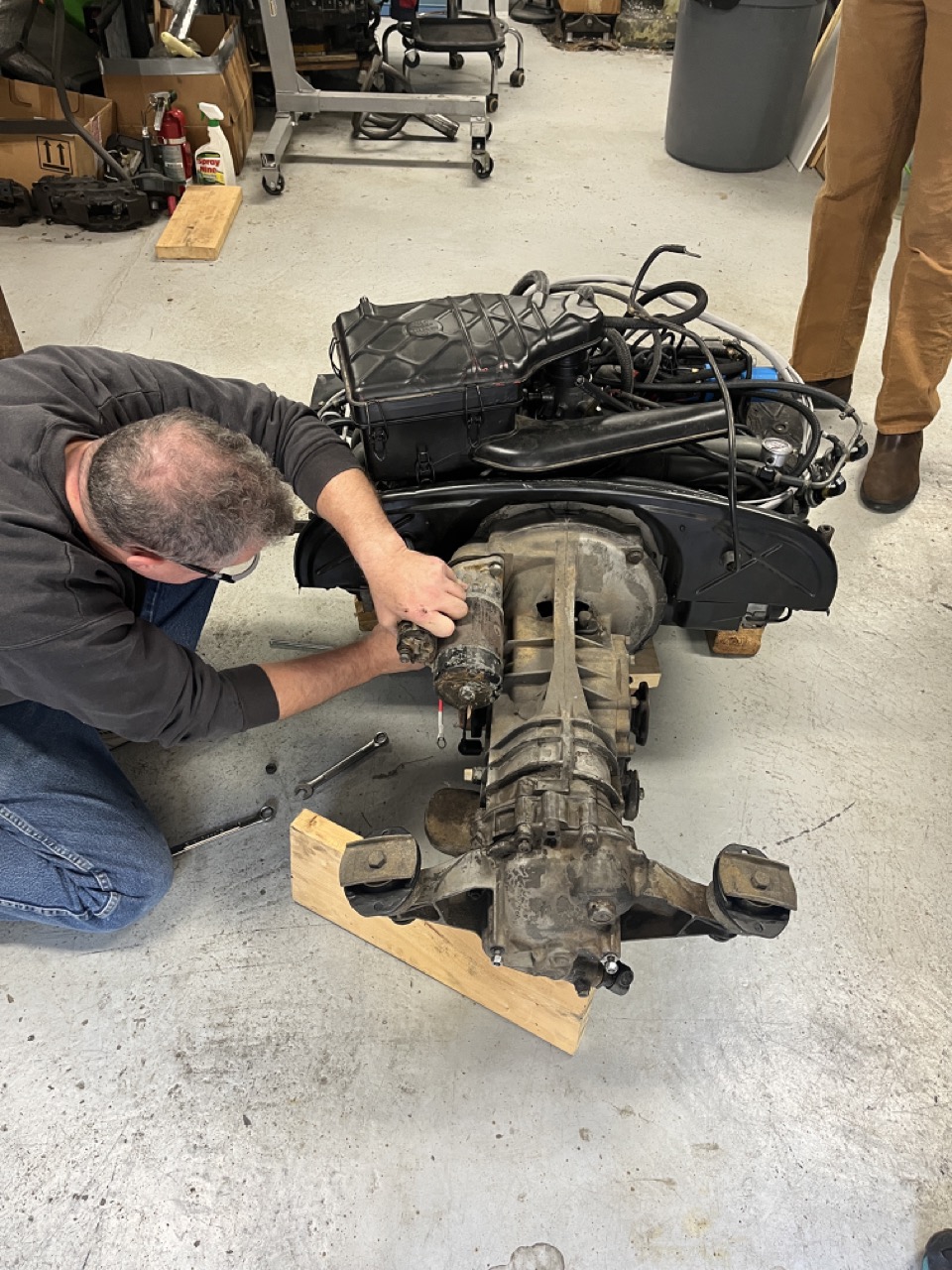

BillC   So, we got the engine and fuel tank out yesterday....   Jun 29 2020, 10:56 AM

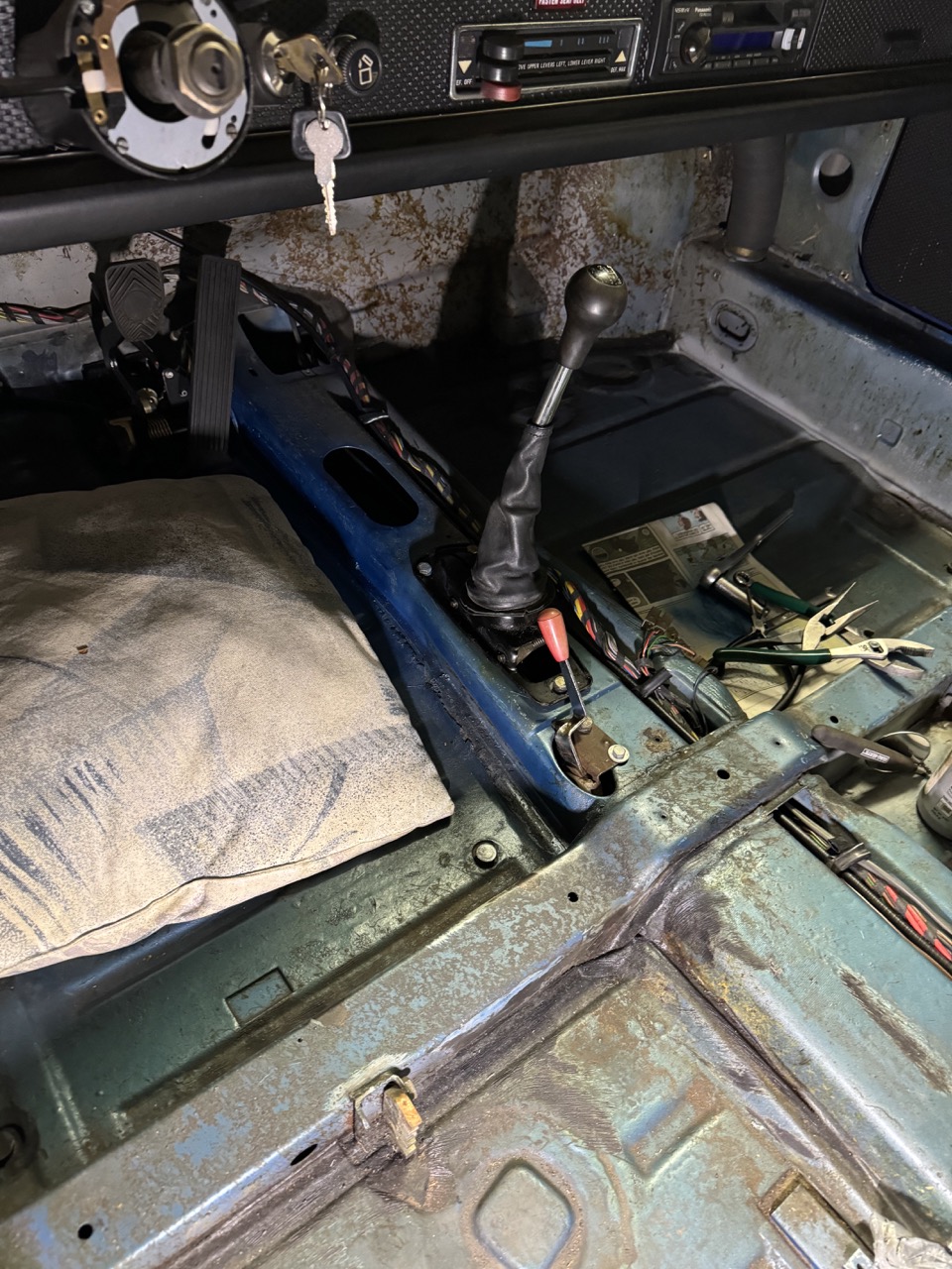

BillC   Time to tackle the hacked-in hole by the foot peda...   Jul 12 2020, 02:39 PM
