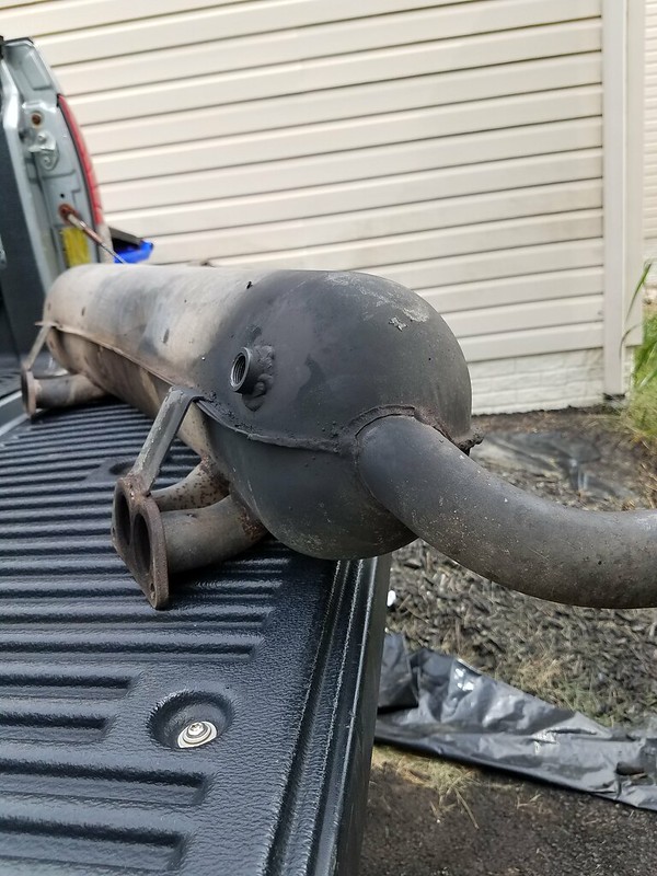

Hi all...does anyone have any photos of an AFR sensor installed on a 2.0 liter with factory heat exchangers and muffler?
Thanks!!

This is where I mounted mine. The most ideal is one on each side, close as possible to the heads to get the most accurate mixture.
(IMG:http://live.staticflickr.com/4345/37253366491_cf0aa6ce7e_c.jpg)
(IMG:http://www.914world.com/bbs2/uploads_offsite/live.staticflickr.com-18763-1594222962.1.jpg)

That’s pretty much the same place that I mounted mine. Seems to work fine (IMG:style_emoticons/default/beerchug.gif)

I guess that's where it will have to go...no good place before the muffler!!

I would have recommended the opposite side, as far away from the actual tailpipe that you can get, especially if you are trying to do any tuning with it. What I have seen with the sensor close to the tip like that is fresh air makes its way back in the tailpipe at idle/lower speeds providing invalid readings.
Stock style mufflers are really not ideal for getting good readings from a wideband. If you are doing actual tuning (aftermarket injection etc) rather than just installing a gauge I would recommend picking up a used Bursch or something else with a collector before the muffler to use while turning and then swap back to your stock exhaust when done.

I would 100% agree with the above.
