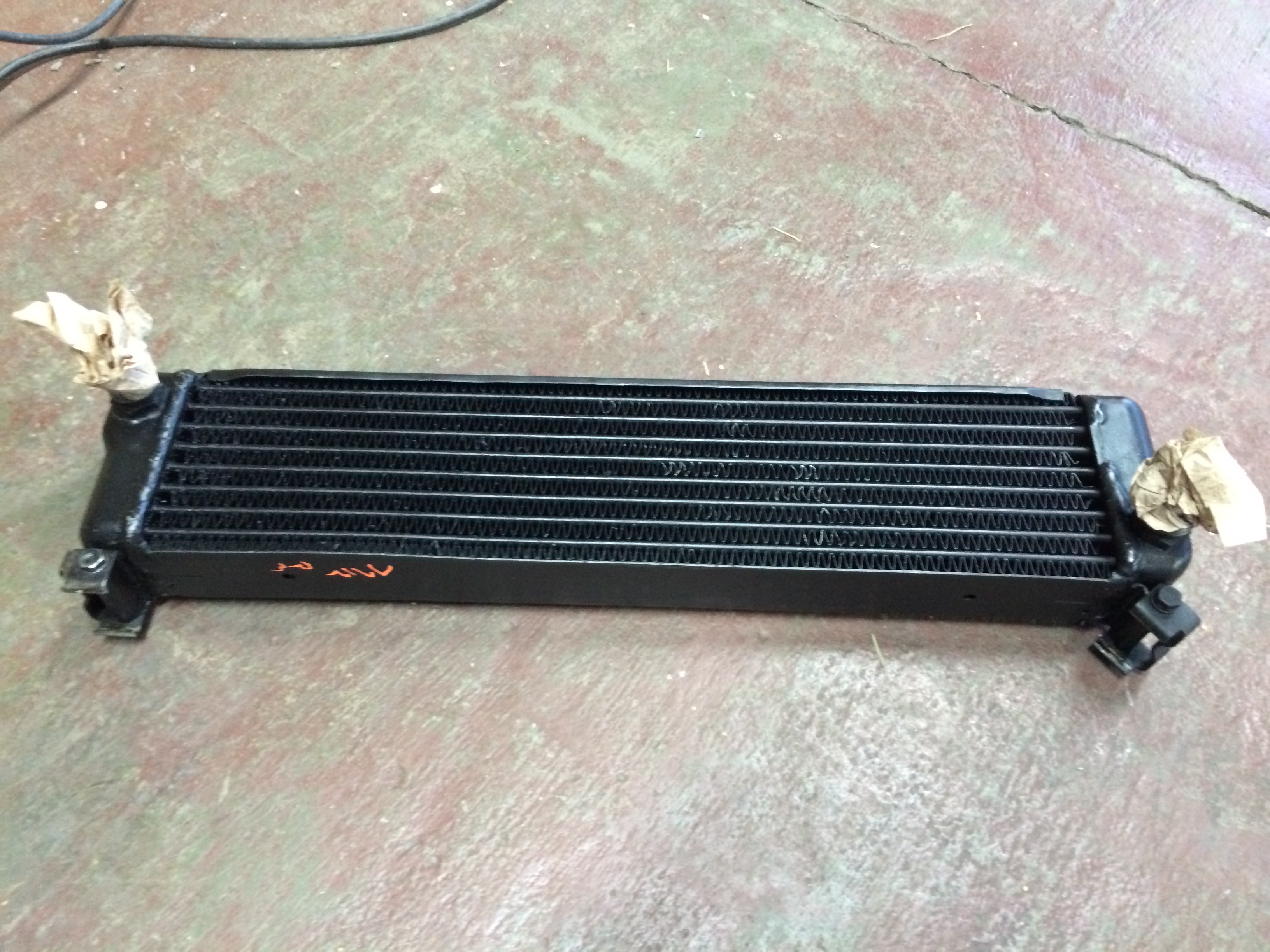

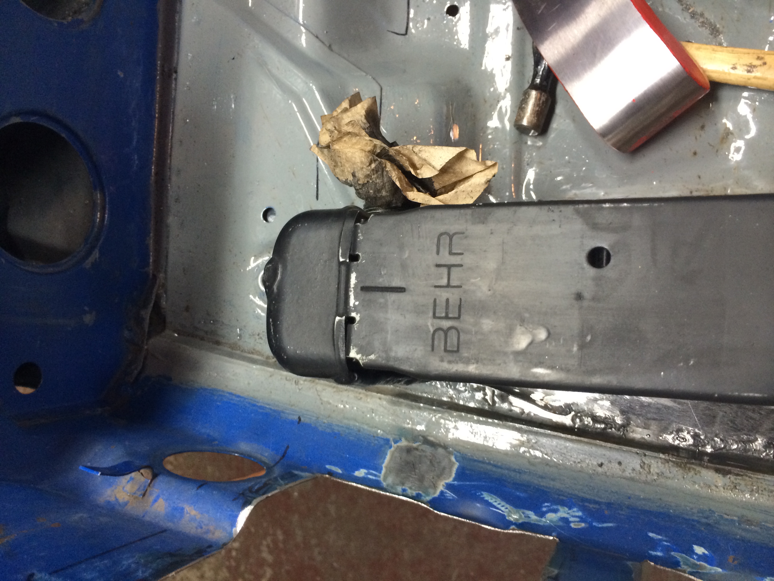

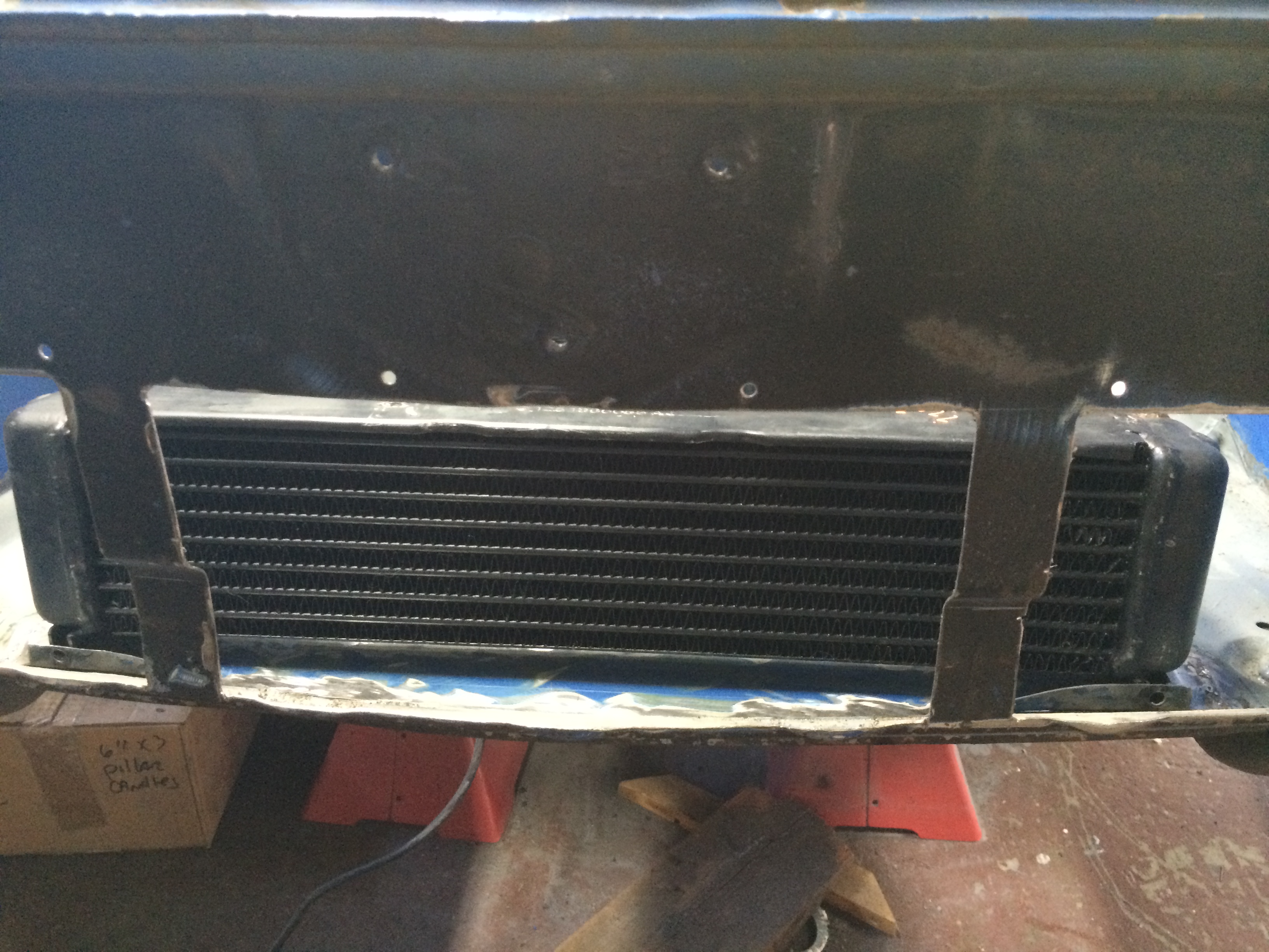

Hi - so for my 2.2 six based GT tribute, I used a Behr oil cooler from an old 300D Mercedes. Sourced from a pick-n-pull. It fits nicely in the space under the shroud, you just have to deal with the metric threads and the placement of the inlet/outlet (one each end; its a single pass, unike the original GT ones which were double pass). I recall it cost me more to have it flushed & pressure tested as it did to buy from the yard....!
So like the GT, no fans used. I run a thermostat near the oil tank and 10AN lines running up and down the rocker panels. In CA weather I rarely see oil temp above 80degC (bear in mind I also have the forced air cooler on the engine too).
Hope this helps? Photos below show build progress; I made a up a long bracket to support it which ends being part of the front end reinforcment. Also, I didn't do the full floor cut out - just two openings near the back of the shroud to vent the hot air.
- Tony

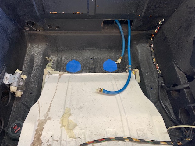

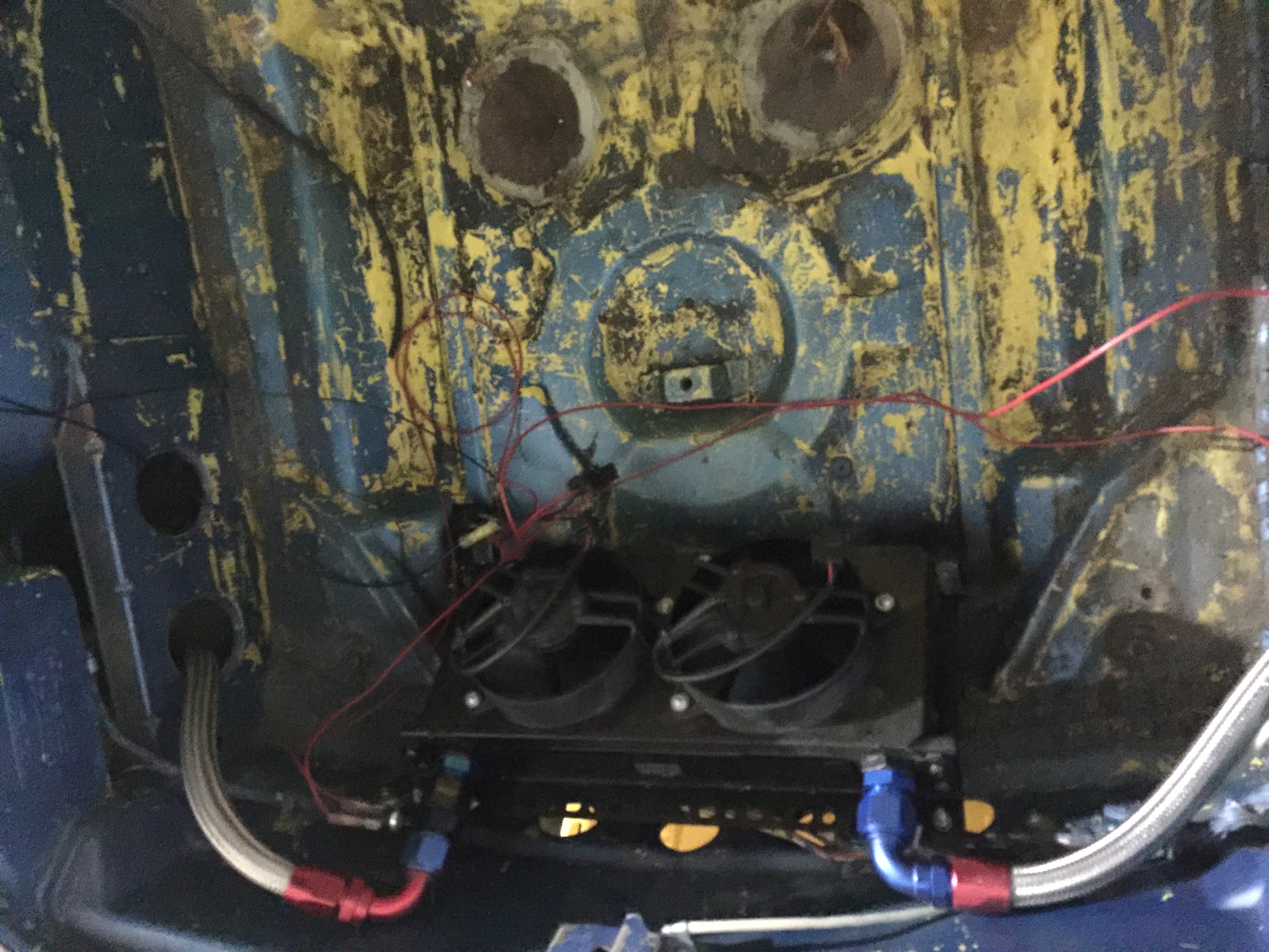

20 row Setrab with fan pack and thermostat switch.
Air comes in through the stock holes in the front body panel and exits through the body plugs.
