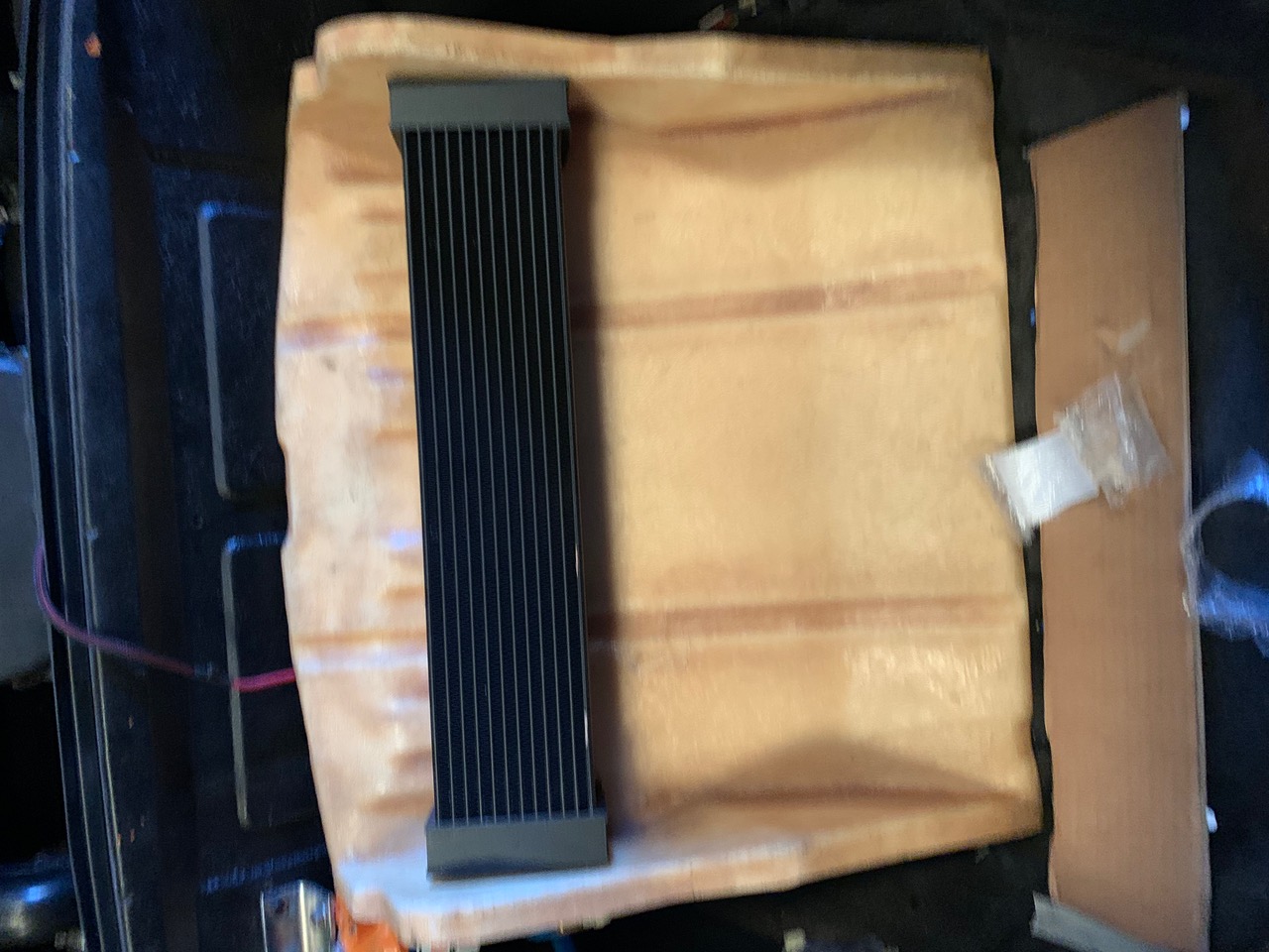

For everybody out there running a GT style cooler, would you mind posting a few photos of your cooling setup and fans?
Currently re-routing my system to use a SETRAB type cooler (example here: Patrick Motorsports Website) however I don't see any reference to fans, and it doesn't seem as though it's an option to purchase.
Also, appreciate any 'pointers' in the right direction when it comes to vendors that might have similar products / solutions. Thanks in advance for your help!

Retroracer   Hi - so for my 2.2 six based GT tribute, I used a ...   Jul 18 2020, 05:41 PM
Retroracer   one more...   Jul 18 2020, 05:43 PM
mepstein   20 row Setrab with fan pack and thermostat switch....   Jul 18 2020, 05:45 PM
SirAndy   I don't run any fans on mine, the only time i...   Jul 18 2020, 05:46 PM

Marv's3.6six   Here is my system which is a Patrick Motorsports S...   Jul 22 2020, 09:28 AM
Marv's3.6six   System with Getty CF lid installed.   Jul 22 2020, 09:40 AM
