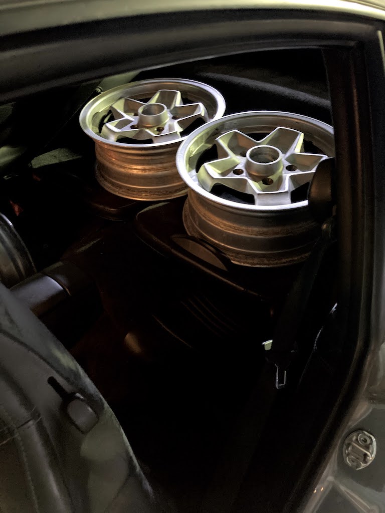

Just got back from Woody's Wheel Works in Denver and none of my cookie cutters are straight (some more than others). Trying to evaluate my options for 5-lug wheels now. Would consider replica Fuchs, a matching set of 4, 2 pairs of wheels, or anything else that may work with my upcoming 5-lug conversion. Anybody have extra 15x6 rims they are looking to get rid of?
Goal this weekend is to tackle interior, fuel lines, and button up the motor

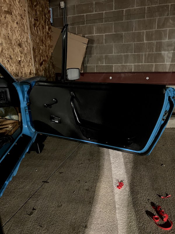

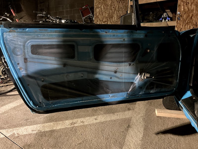

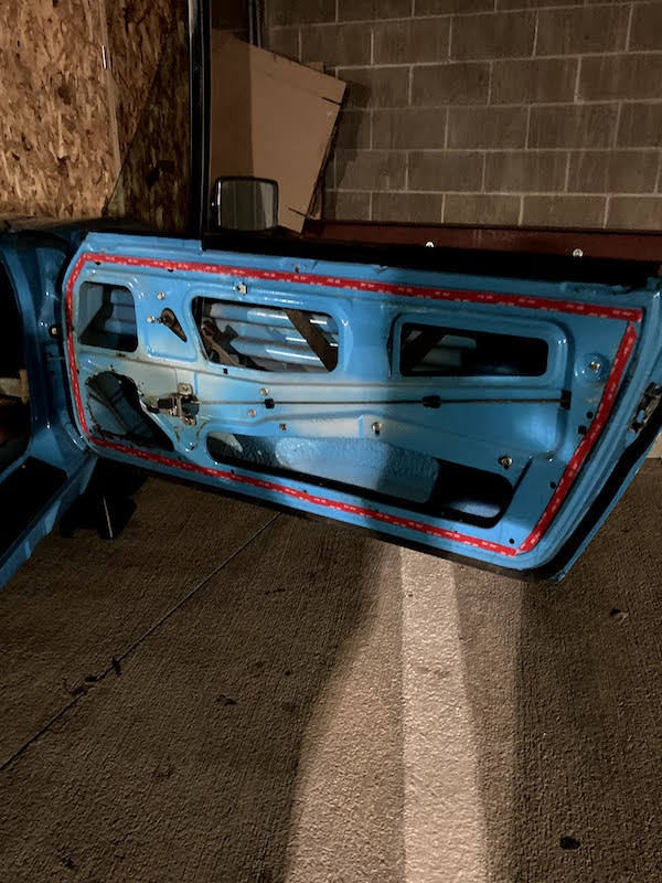

So I started the weekend off with an easy project - getting the door cards out of my storage unit and mounted. There are a number of writeups on the topic, but I purchased some 3M double sided tape from Amazon, HDX 2mm drop cloth (had laying around), and the Auto Atlanta door panel hardware kit.
Despite having 15ft of tape, I still ended up about 1.5 feet short on the bottom of the drivers' side door. If I were to do it again, I would left a 9" opening in the middle of both sides.
The AA kit comes with 3 rubber nipples that I assume are supposed to go into some of the holes. I couldn't find a good diagram online or in any writeup as to where to place these, so I ended up leaving them out. The 9 plastic rivets clipped in securely and I regret not ordering more speed clips as some were missing from my door.
