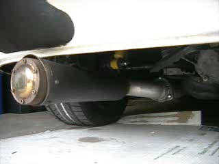

I just looked at the original mufflers and they are MagnaFlow not Flowmaster. Sorry for the misinfo. The name was on top and I was told they were Flowmasters. Here is a pic of the Supertrapps.

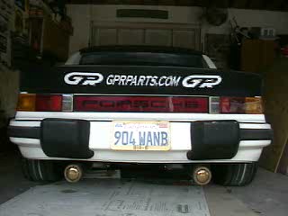

And a close up:

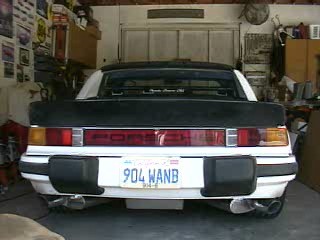

Here are the MagnaFlows the way they were originally mounted. They have been reworked so they will come straight out like the SuperTrapps now. These are much louder than the SuperTrapps even with the 15 disks that are on the SuperTrapps.

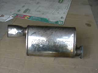

Here is the MagnaFlow off the car.
