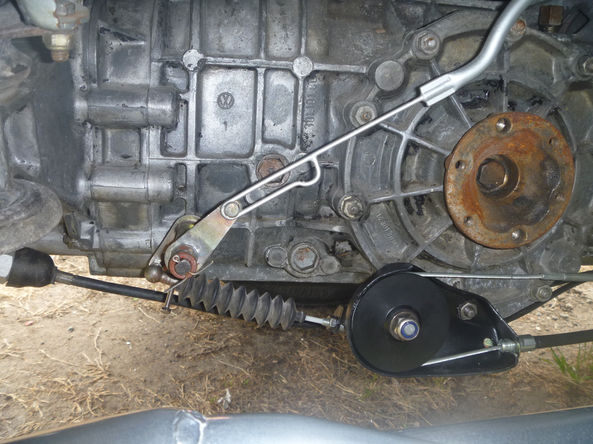

Throttle linkage ?? if you are carefully you can drill the g/box and fit a 911 pivot stud and bellcrank assembly,some mods involved but mine works for $100 outlay including curved rod to carbs.
Mines ''ass about face'' but works fine.
