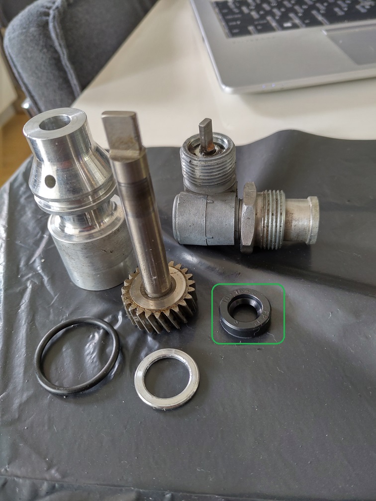

> Speedo angle drive oil seal removal, how do you get the bas#ard out ?????
porschetub
post Aug 8 2020, 07:11 PM
Posts: 5,200
Joined: 25-July 15
From: New Zealand
Member No.: 18,995
As per question,TIA
bdstone914
post Aug 8 2020, 07:49 PM
bdstone914
Posts: 5,424
Joined: 8-November 03
From: Riverside CA
Member No.: 1,319
@porschetub
Carve out the inner lip with a knife. Screw in a 14mm lug nut and it will pull it right out.
porschetub
post Aug 8 2020, 09:58 PM
Posts: 5,200
Joined: 25-July 15
From: New Zealand
Member No.: 18,995
QUOTE(bdstone914 @ Aug 9 2020, 01:49 PM) *
@porschetub
Thanks so much ,never bloody thought of that,so the bolt will grip on the metal outer after the rubber is gone ?
Whoops just did that and appears I only pulled the centre from the seal,seems the outer is still there (IMG:style_emoticons/default/headbang.gif) (IMG:style_emoticons/default/headbang.gif) .
What next.....
Edit ......sorted thanks it has no metal outer,new seal in now and much tighter on the driveshaft,cheers

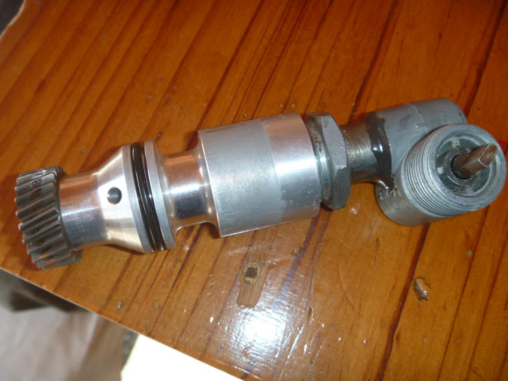

Saga continues,found a fair amount of wear on the shaft carrier and a bit sloppy in the gearbox even with new o ring seal....PO had fitted the lock screw with a fat washer behind it so it wasn't located into the carrier enough,sorted that.
Angle drive was very loose and suspect another leak possible in that area so applied a bead of JB weld and worked well.

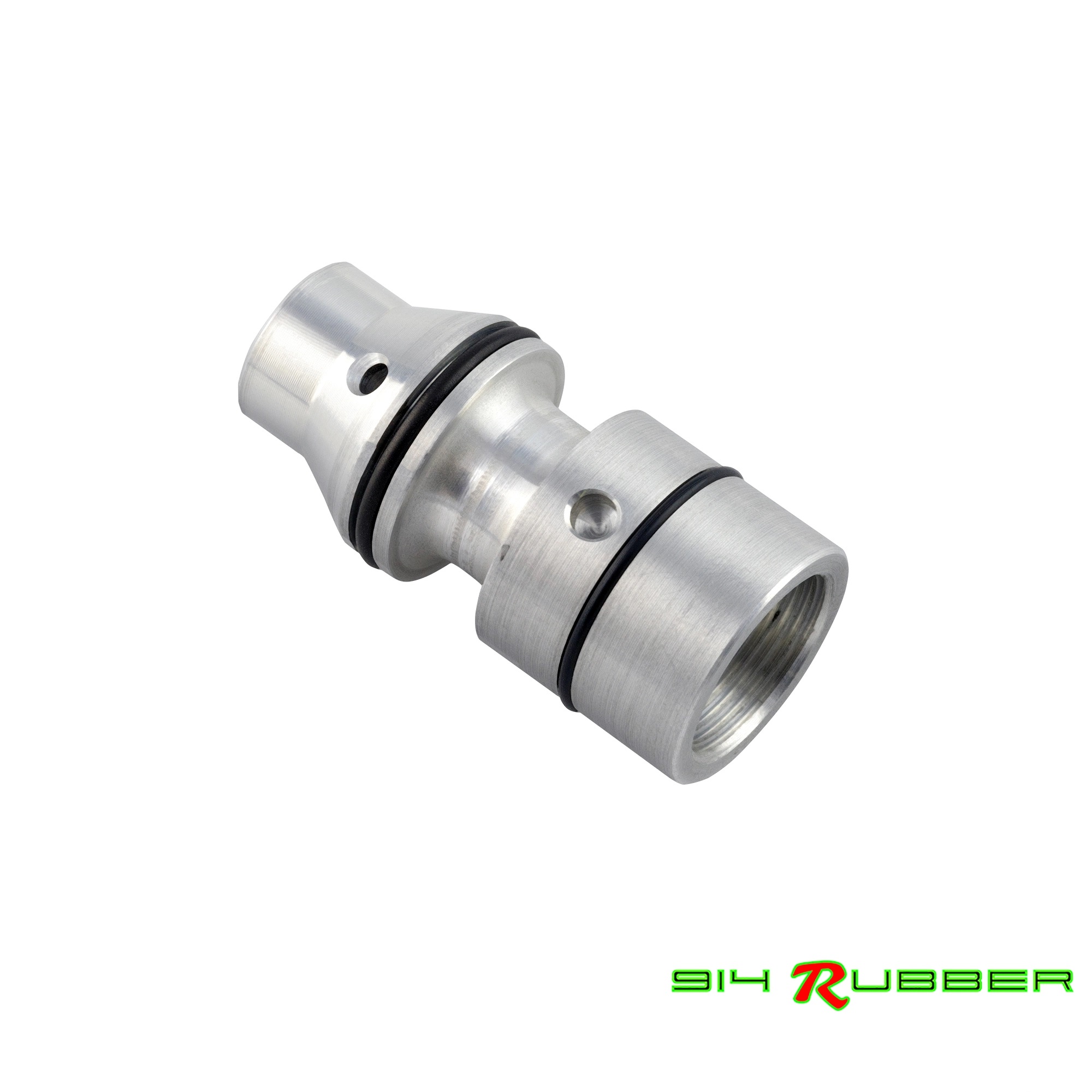

Your more likely to have fluid leak at the worn section of the bushing. That’s the reason for adding a second seal. The internal rotary seal should contain the fluid from the shaft.
bdstone914
post Aug 10 2020, 10:01 PM
bdstone914
Posts: 5,424
From: Riverside CA
Member No.: 1,319
@porschetub
Note the erosion on the aluminum wear it is not contacting the case. This may cause more seepage.
The bottom part of the angle drive to the top normally pivots.
Hope that works for you.

Thanks guys,my reason for removing it was the change the inner oil seal as that was clearly where it was leaking.
Would like to have machined for a second o ring but have no lathe to do it on as my brother is away so couldn't use his workshop.
Checked it this morning and no leaks so forever hopeful (IMG:style_emoticons/default/biggrin.gif) .

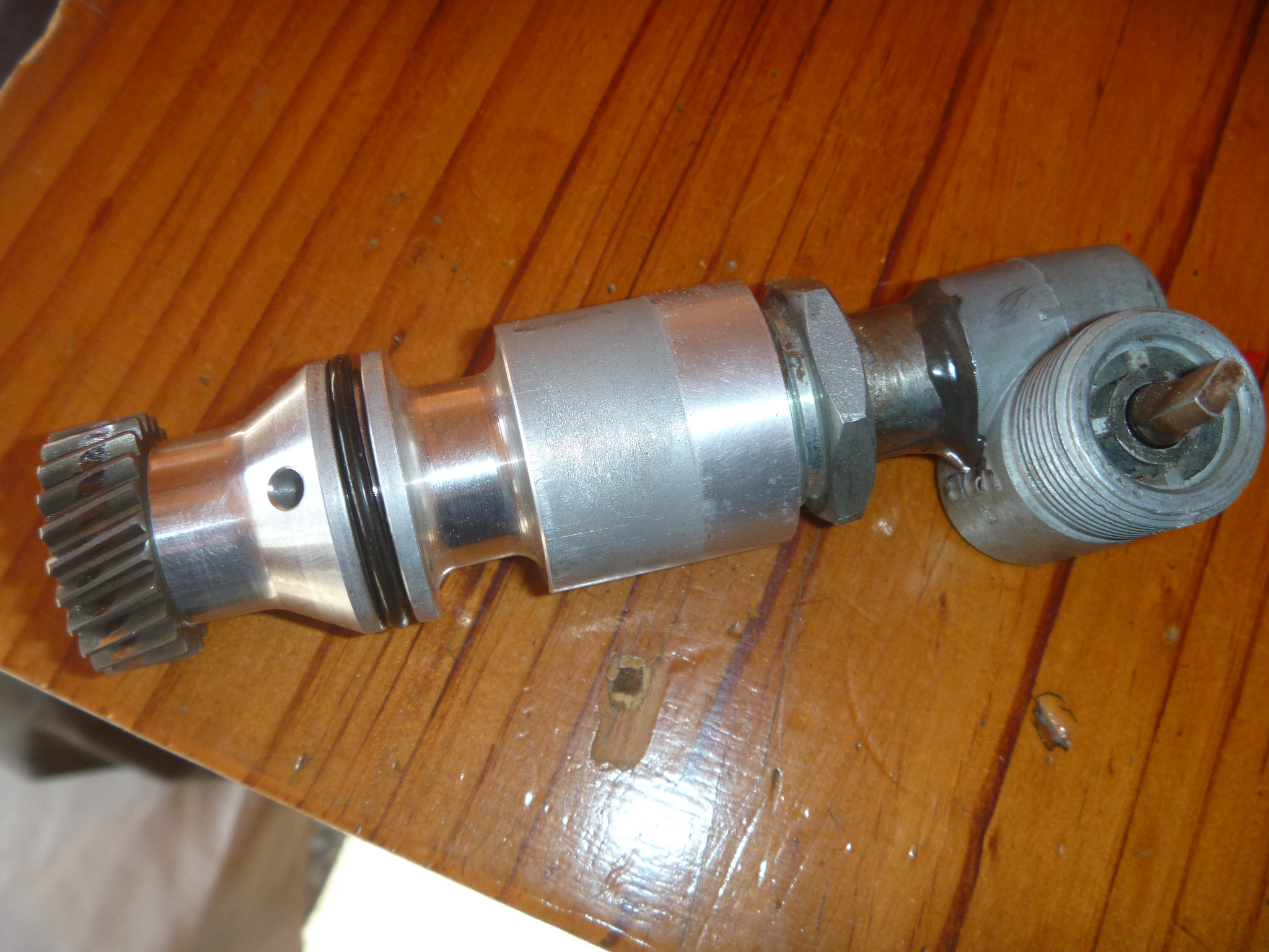

Pretty straight fwd job,I drilled the seal and fitted a self tapping screw and it was easy to get out.
Couldn't believe how hard the seal had become just broke up on removal,install was with easy as also as I had a T1 tool I made yrs ago.

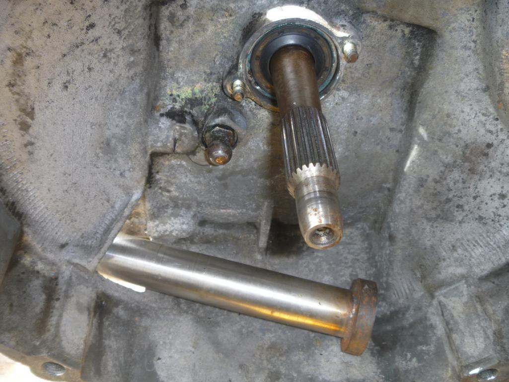

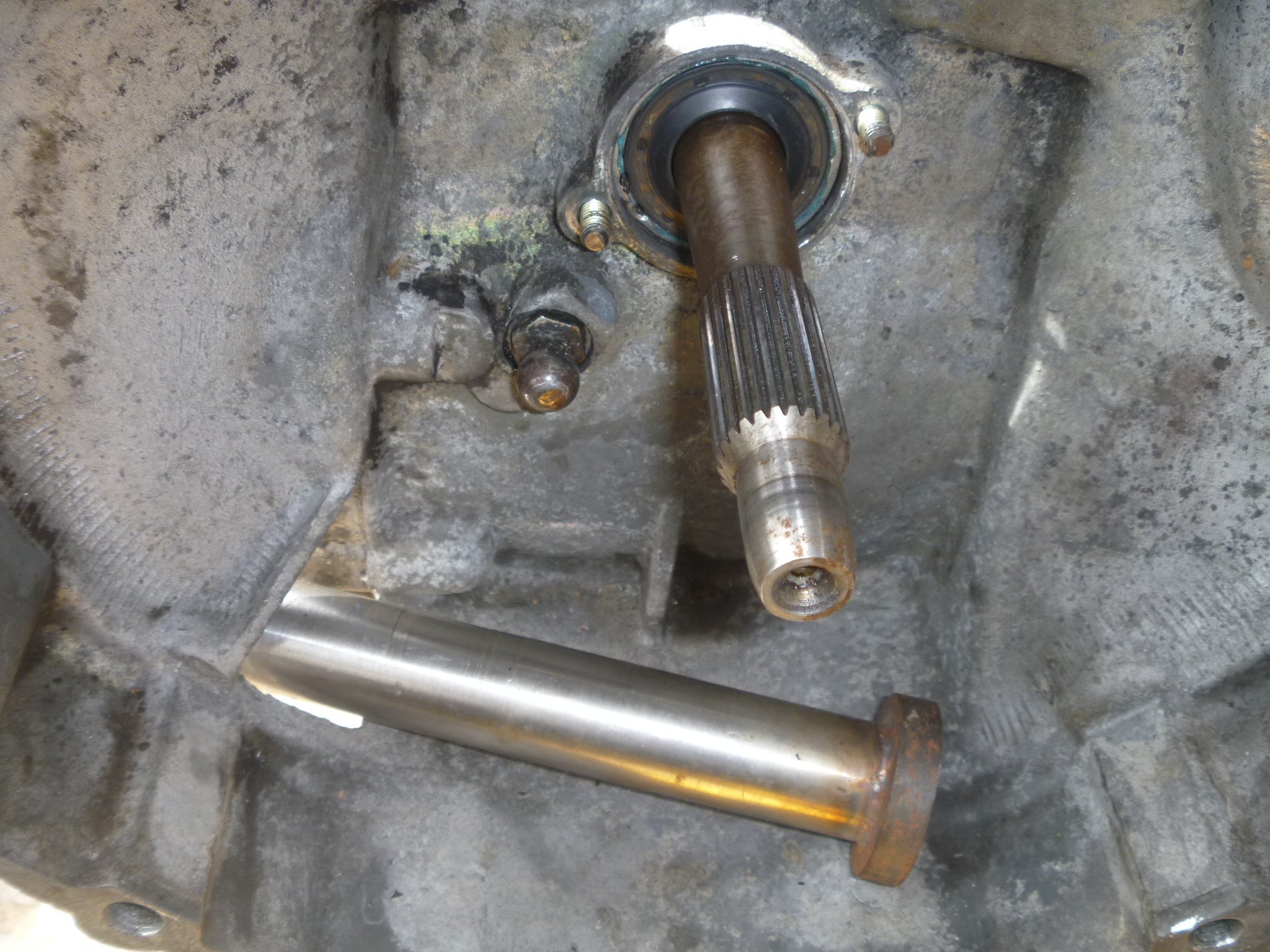

Continuing on or "while you are in there" as they say,no leaks @ speedo drive,moved on to my rear shifter rod...found locking screw on the fwd uni-joint was loose ,kicking myself as I hadn't drilled a detent for the locking screw (IMG:style_emoticons/default/slap.gif) so it was moving around so fixed that.
Just found with all the caked up grease removed from the shifter,genuine cable fitted,and adjustment of cable position has really improved the action,test drive will confirm.
Happy with results (IMG:style_emoticons/default/biggrin.gif) .

Test drove today,much smoother shift ,didn't do a gearshift alignment cause it was right,reset the rear shift rod straight up and down in neutral.
No result on my popping 4th gear but still happy with worthwhile results,funny thing as it will shift to 4th with the car sitting and moves the car forward on a combo of throttle and clutch footwork,wasn't doing that before latest work (IMG:style_emoticons/default/confused24.gif) .
Good results with my breather tube from oil tank vent to aircleaner fitting,it sucks the moisture down instead of draining back to the tank....what was I thinking with my old K&N setup ....
