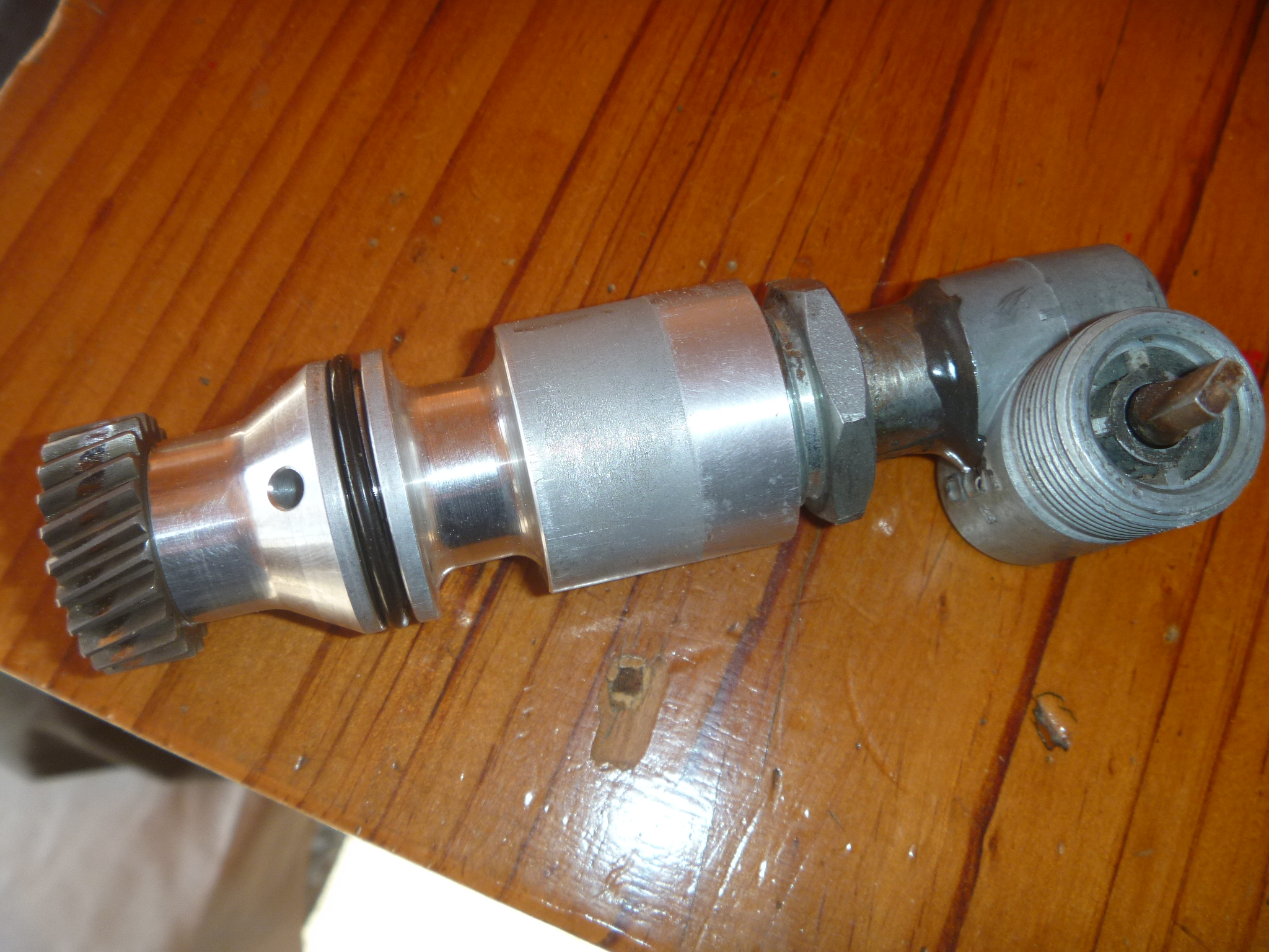

porschetub
Saga continues,found a fair amount of wear on the shaft carrier and a bit sloppy in the gearbox even with new o ring seal....PO had fitted the lock screw with a fat washer behind it so it wasn't located into the carrier enough,sorted that.
Angle drive was very loose and suspect another leak possible in that area so applied a bead of JB weld and worked well.

Your more likely to have fluid leak at the worn section of the bushing. That’s the reason for adding a second seal. The internal rotary seal should contain the fluid from the shaft.
bdstone914
@porschetub
Note the erosion on the aluminum wear it is not contacting the case. This may cause more seepage.
The bottom part of the angle drive to the top normally pivots.
Hope that works for you.
porschetub
Thanks guys,my reason for removing it was the change the inner oil seal as that was clearly where it was leaking.
Would like to have machined for a second o ring but have no lathe to do it on as my brother is away so couldn't use his workshop.
Checked it this morning and no leaks so forever hopeful biggrin.gif .

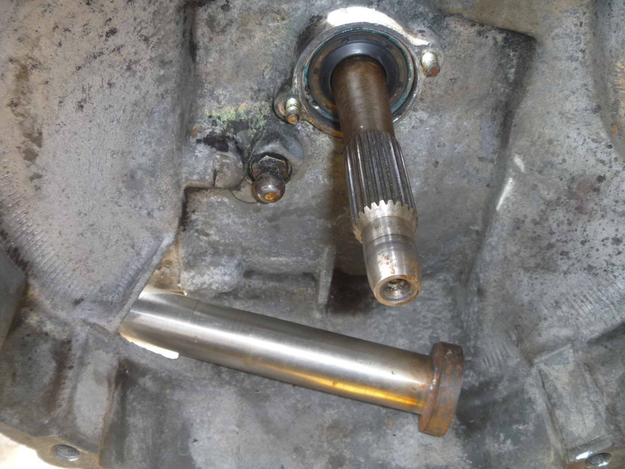

Pretty straight fwd job,I drilled the seal and fitted a self tapping screw and it was easy to get out.
Couldn't believe how hard the seal had become just broke up on removal,install was with easy as also as I had a T1 tool I made yrs ago.
