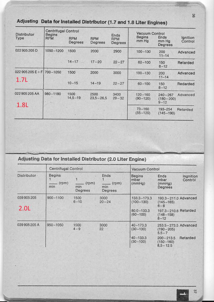

I know there’s about 1,000,001 variations of the distributors on these cars, and I’ve also read here that the Pertronix Distributors are clones of the much hated 009 distributors. Is the SVDA unit they sell considered acceptable because it has a better curve than their other units?
D186504 Flame Thrower distributoR
Thanks!

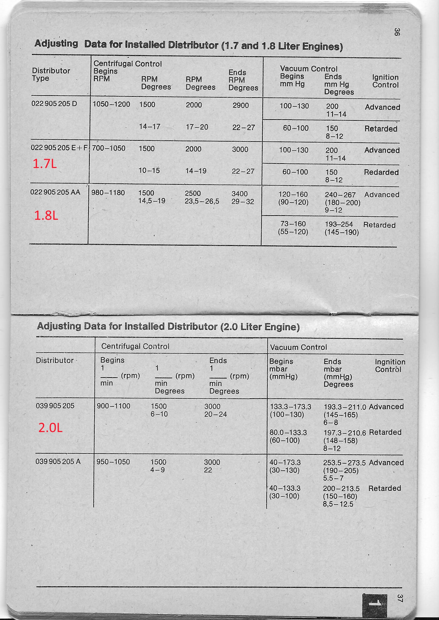

bbrock   Can anyone enlighten me on why the 1.8L dizzy is t...   Aug 18 2020, 02:36 PM
davep   022 905 205 T is the (unlisted on your pages) corr...   Aug 18 2020, 02:50 PM
bbrock   022 905 205 T is the (unlisted on your pages) cor...   Aug 18 2020, 03:41 PM
Tdskip   Is that the one people are using for carb conver...   Aug 18 2020, 03:58 PM
nditiz1   Is the European 1.8 version a DVDA or SVDA? Not s...   Aug 18 2020, 03:44 PM
bbrock   Is the European 1.8 version a DVDA or SVDA? Not ...   Aug 18 2020, 04:02 PM
