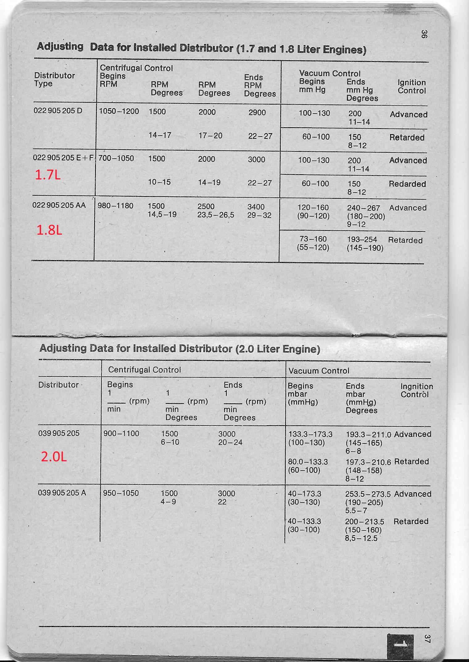

If you want a vacuum advance carb, just get one from a 1.8, for that matter it's got (IIRC) 5* of vacuum retard on the other side of the dashpot
bbrock
Can anyone enlighten me on why the 1.8L dizzy is the preferred stock dizzy for carbs? Is it the lack of injector trigger points or is the curve better? I've looked at the specs on the 1.8 vs 2.0 but don't know enough to understand if the differences would significantly affect performance.

I'm working from memory as well, which for me is dangerous; but I think the 1.8 had 5* of retard at idle with the retard side of the dashpot connected, so potentially you could get a total of 37* with both dashpots. That said, I've never hooked up one like that, just with the advance side.
