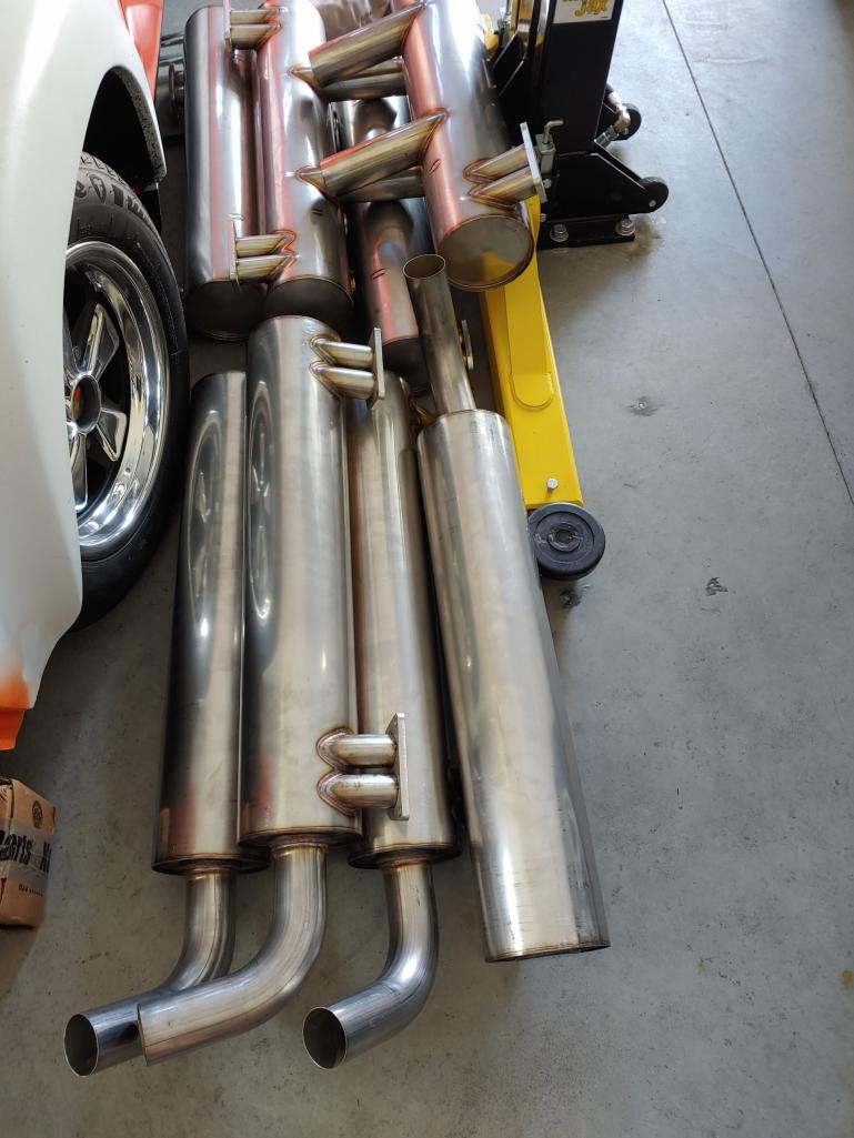

Not the most flattering picture there of the garage but I have to much of my sons stuff in there.

I like the sound of the Bursch. It's not too loud unless you really romp on it. I am not a big fan of loud exhausts.
mb911
post Aug 19 2020, 06:36 PM
Posts: 7,794
Joined: 2-January 09
From: Burlington wi
Member No.: 9,892
I make a very quiet muffler for all 914s .. I don't care for loud ones either any more

That welding (IMG:style_emoticons/default/drooley.gif) ,IMO its hard to get folks to understand that loud isn't better,a muffler that is designed correctly will not be loud but maybe a bit more throaty and also supply a power gain in there too.
