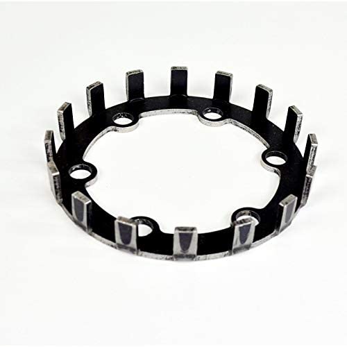

BIGKAT_83
post Aug 21 2020, 03:14 PM
Posts: 1,800
Joined: 25-January 03
From: Way down south Bogart,GA
Member No.: 194
The speed output to the speedometer on a boxster comes from the ABS module.
I used a Attached Image on the cv joint with a vr sensor.
Bob
