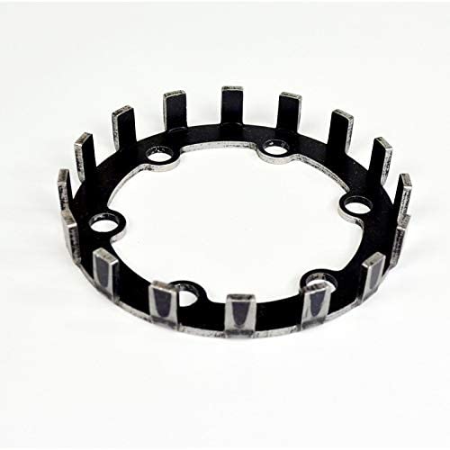

I used a Click to view attachment on the cv joint with a vr sensor.
