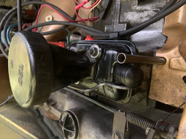

I'm sure this topic has been discussed in the past, but being a newbie not really sure how to find the specific threads. Anyway, I have oil leaking out of my oil breather, not really sure where it is coming from. Definitely not coming from the gasket at the base of the tower. There is a rubber plug where the breather hose should be attached, which I'm sure was routed somewhere in the fuel injection system. Obviously, I have weber's, so not sure what to do with the breather connection. Does the plug on the breather tube cause over-pressure in the system, forcing out oil? Any suggestions/solutions would be appreciated. I removed the dip stick for the picture. Attached Image

QUOTE(ghia1974 @ Aug 21 2020, 07:44 PM) *
What year and engine is that? '75? 2.0? Or, is it really a Ghia?
Do you have an anti-flashback valve plumbed to the heads? If not, that plug may be the only way to vent crankcase pressure, and your leak could be caused by over-pressure like you said.
ghia1974
post Aug 22 2020, 05:22 AM
Posts: 14
Joined: 6-August 15
From: New Jersey
Member No.: 19,033
I stepped up in class!
It’s a 73 with 1.7.

you should remove that plug
your crank case does need to breath, and will cause more leaks (due to internal pressure) if you do not have some type of breather
some guys route that into one of the carb air filters (re burn, like the factory)
others use a bottle or buy a carb breather box.... that allows the case to breath, and a box to catch the small amount of oil that also escapes with the pressure.

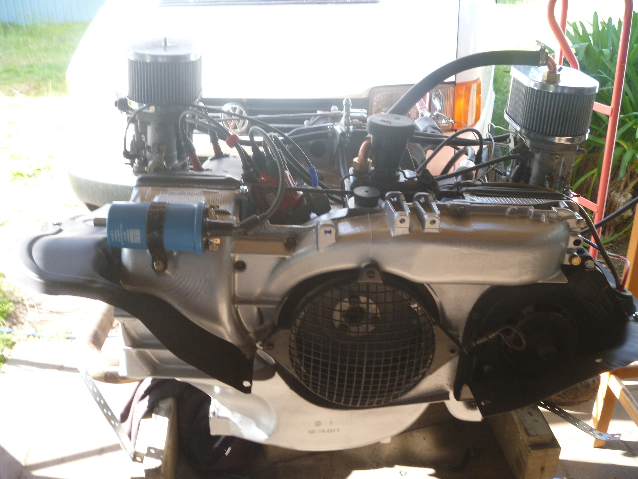

The cork gasket under the filler will be where your leak is as mentioned you have no venting.
This is what I did on my last customer build,a bit clumsy looking but functional,tested it disconnected from the carb with engine running and just some fumes nothing else.
Any oil vapour will separate in the breather box and run downwards,the fumes get sucked into the top of the carb.
Use the biggest hose and fittings for max effect (IMG:style_emoticons/default/beerchug.gif) .
