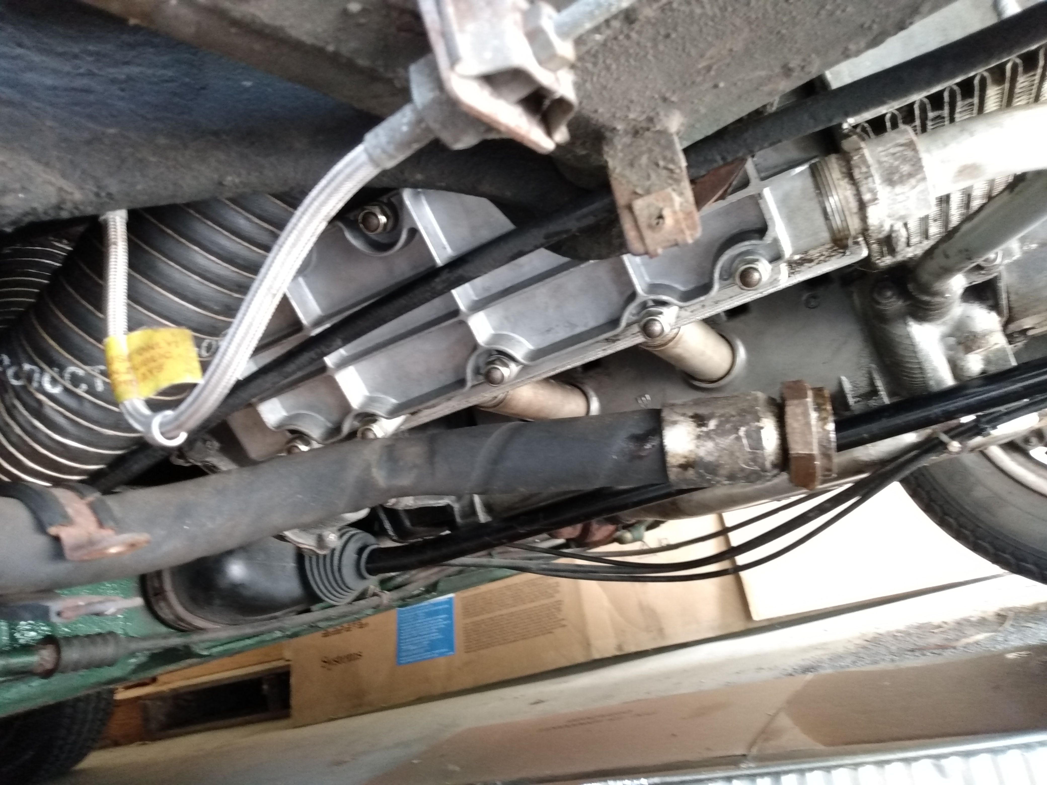

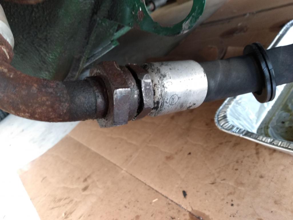

Bought one of the Rothsport oil valves because I was tired of cleaning up oil after taking the car out. Installing it was my weekend project (what did you do to your 914...?) Had the pull the heat exchanger, and the hose connection at the oil cooler came off surprisingly easy. The connection at the U bracket is another story. It hasn't been loosened in at least 30 years and having no luck breaking it loose. Any suggestions?
And before you ask 'how did I change the oil?'; the car has been driven less than 10k miles in the last 30 years, and 'oil changes' were done almost on a continuous basis by refilling since the leakback was so bad anytime I drove it. New lower valve covers & gaskets helped, but it still drained about half the tank when it sat for several months. Attached Image Attached Image

porschetub   When I put my oil lines together I purchased a che...   Aug 23 2020, 02:41 PM
fixer34   When I put my oil lines together I purchased a ch...   Aug 23 2020, 03:03 PM
porschetub   When I put my oil lines together I purchased a c...   Aug 23 2020, 05:46 PM
GeorgeRud   They’re 32 and 36mm, and it’s best to get the ...   Aug 23 2020, 07:15 PM
fixer34   They’re 32 and 36mm, and it’s best to get the...   Aug 23 2020, 07:46 PM

9146GUY   Biggest issue I see is that one fitting is steel a...   Aug 24 2020, 07:42 AM
fixer34   Biggest issue I see is that one fitting is steel ...   Aug 24 2020, 08:25 AM
rgalla9146   In your photo both sides are steel, the aluminum i...   Aug 24 2020, 09:36 AM
fixer34   In your photo both sides are steel, the aluminum ...   Aug 24 2020, 09:41 AM
slivel   In your photo both sides are steel, the aluminum ...   Aug 24 2020, 10:18 AM

rgalla9146   All threads are conventional, no reverse except th...   Aug 31 2020, 06:51 AM

johnlush   Search for "Alltrade Strap Wrench". You ...   Aug 31 2020, 11:52 AM
fixer34   So, "with a little (LOT) help from my friends...   Sep 3 2020, 05:12 PM
