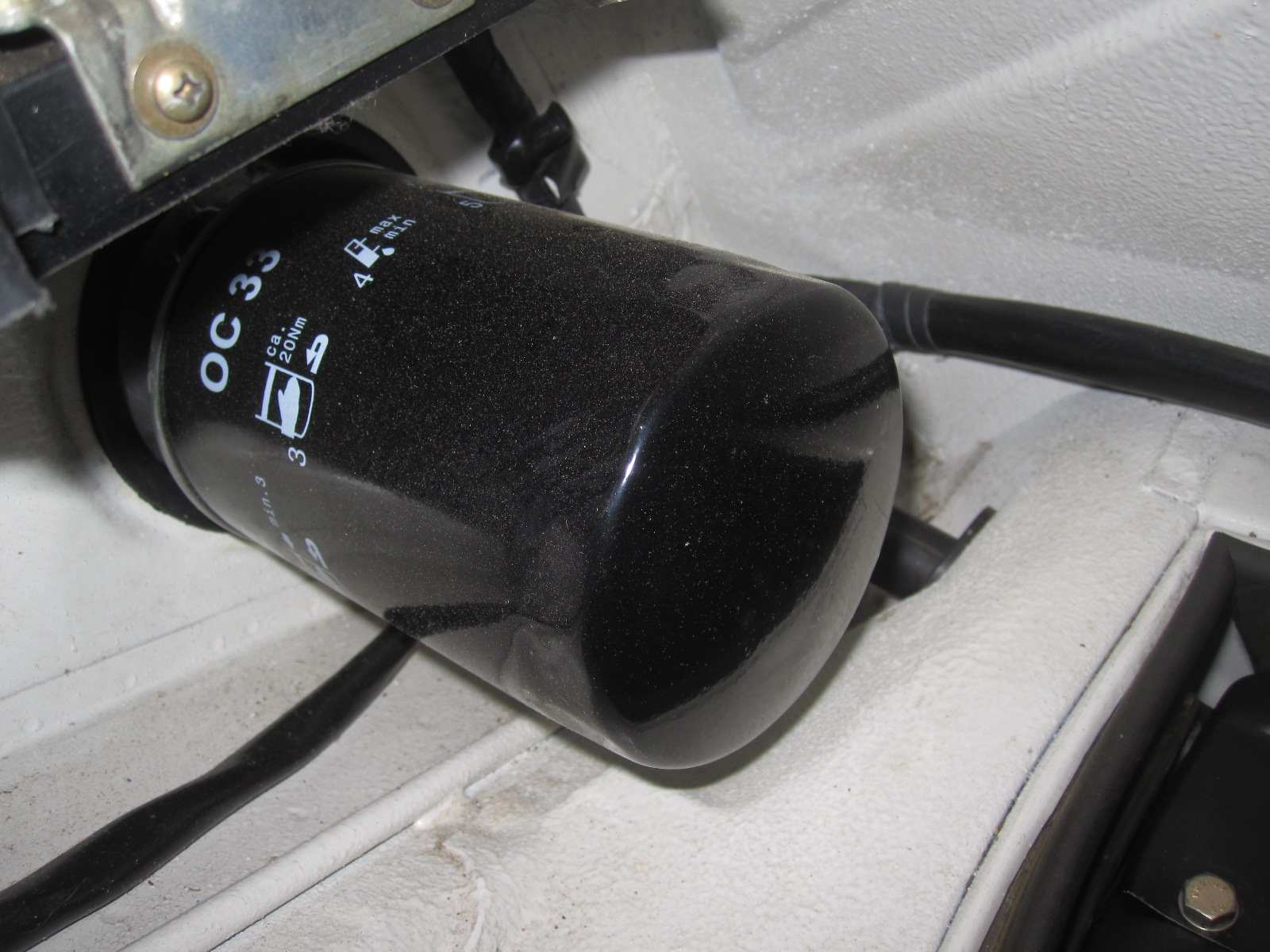

Your car ?
Please get from the dealer.
Or next best get a Mahle or a Mann.
Also, Porsche now sells correct vintage look filters.
Best to check what filter console you have, the fitting could be the larger later
version.
Stuff plenty of absorbent something under and around before removing the filter.
Drain hot tank first. Mahle OC 33 is correct.
