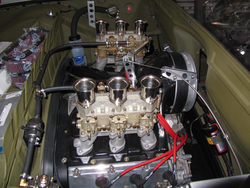

Mark Henry   I made mine using the stock /4 throttle cable. -t...   Aug 25 2020, 03:17 PM
Mark Henry   I made mine using the stock /4 throttle cable. -...   Aug 26 2020, 05:06 PM

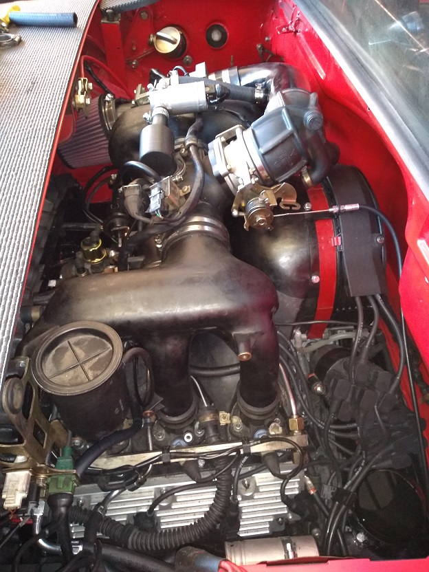

ClayPerrine   Here is how I did mine. The 964 throttle linkag...   Aug 27 2020, 06:39 AM
