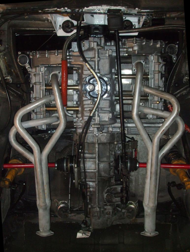

I made mine using the stock /4 throttle cable.
-the crank from a 911, I heated it cherry so the brass melted and turned it to its new orientation.
-I used a 911 throttle pull rod, I had to cut some out of the rod length and welded it back up.
- I used a long bolt (cut off and hole drilled for cotter pin) for the crank pin, a bit of bicycle handle, some 1/16" steel, some welding drilled some holes so ot mointed on the side cover and made the tranny mount for the cable. Turned out good but was a bit overkill.
-Made the curve channel for routing the speedo clutch and throttle cable out of an old tent pole, some clamps and and I welded on some tabs, see pic below.

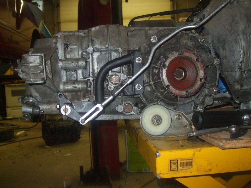

I found a couple good pic's of how I did my trans crank.
IPB Image
IPB Image
IPB Image

Pretty much what Mark H did but drilled the trans and used 911 pivot and bellcrank which I modified to fit relay rod to carb bellcrank on the engine.
Drilling the trans has to be carefully done,not something you just rip into.
I think you have a different bell crank (engine mounted ) bracket so the PMS one you have may suit your needs better...done really know exactly.
You need to start a build thread,it could save you $$$ and make the whole thing easier because you will learn from others mistakes biggrin.gif biggrin.gif .

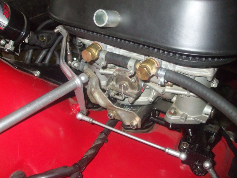

Krieger
Here's how I did mine. Patrick Motorsport 914/6 throttle cable.
Krieger
Oops

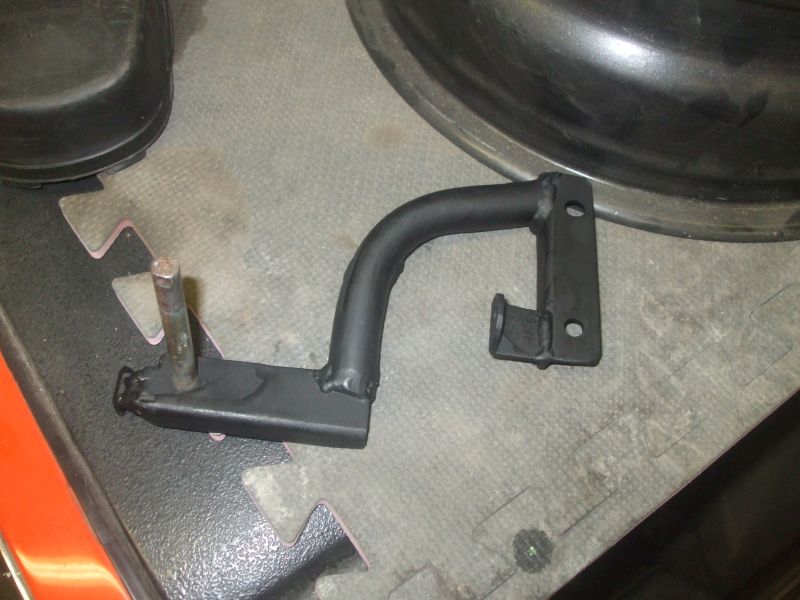

ClayPerrine
Here is how I did mine.
The 964 throttle linkage had to be scrapped when I flipped the throttle body around. And I was in an hurry to make Okteenerfest, so I just fabricated this. It works, but I don't particularly like the angle on the cable where it makes the turn next to the fan. I haven't had any binding or sticking though.
I am tentatively planning a Megasquirt conversion, and I have looked at using a 996 throttle body I have. It would have to go in the stock rearward facing location due to the size, and the fact that I will be using a map sensor instead of a MAF. So the cable installation will be more of a straight shot to the throttle body.
Clay
