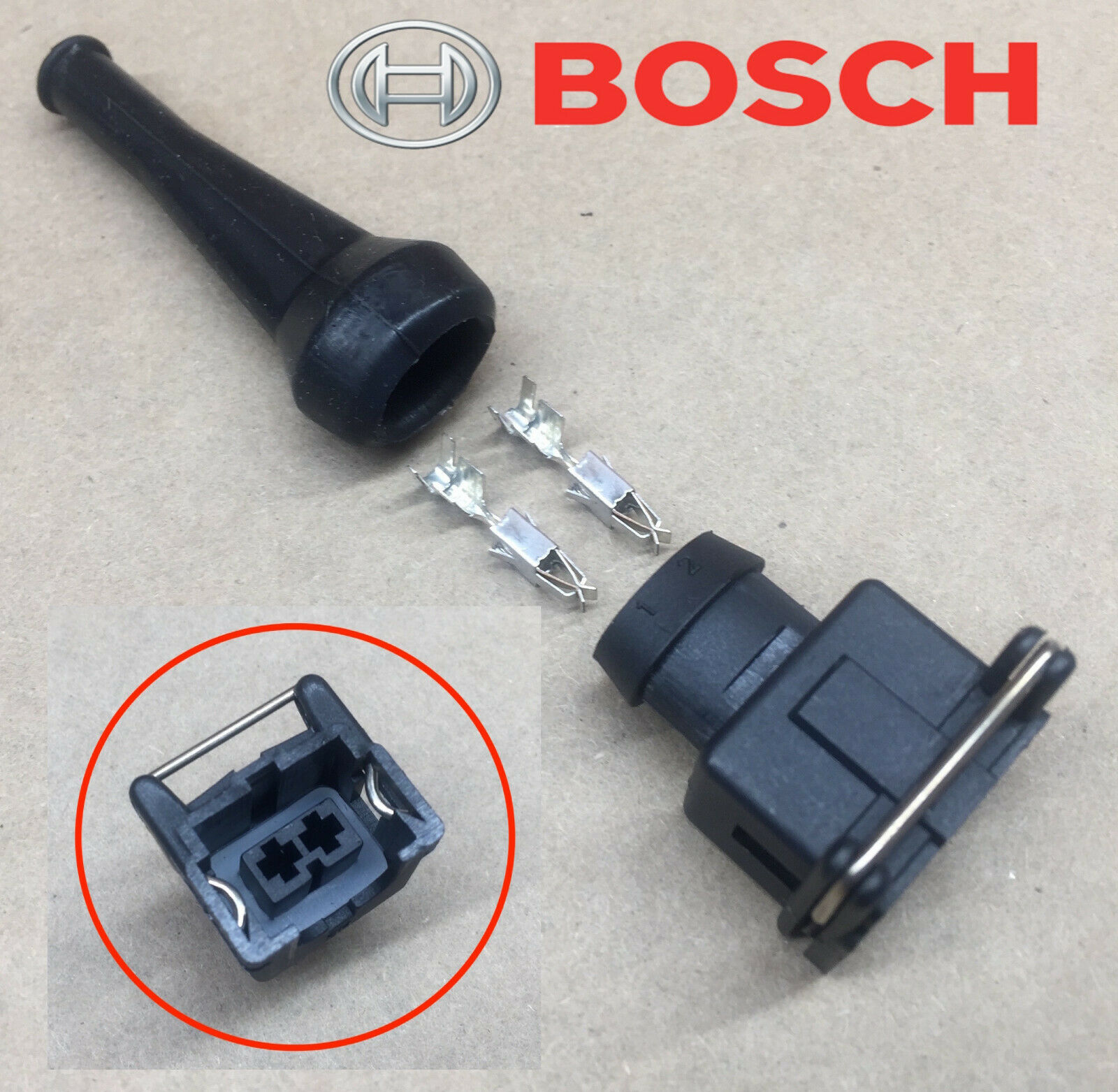

Here's a kit for the injectors. Doesn't help for the distributor connection.
Injector connector and boot

QUOTE(IronHillRestorations @ Sep 23 2020, 03:44 PM) *
Unfortunaley that kit is only for the 1.8L L-Jet cars, Perry. No worky for D-Jet cars.
Andrew has a 74 2.0L D-jet.
