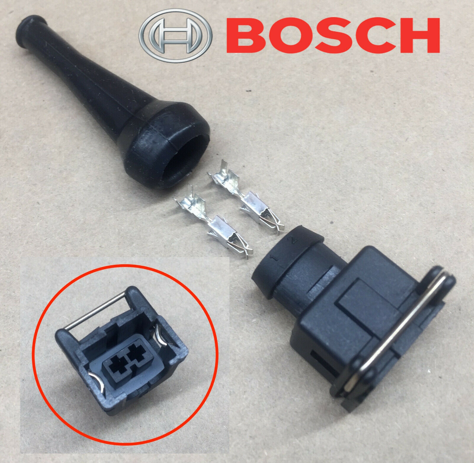

Here's a kit for the injectors. Doesn't help for the distributor connection.
Injector connector and boot
windforfun
Spade lug connectors are a dime a dozen. Buy some different sizes. Crimp the connection first & then solder it. 1" or so of shrink tubing is always a good idea. Don't cut any wire strands while stripping the insulation. This is how MB does their spade lugs.
JeffBowlsby
QUOTE(IronHillRestorations @ Sep 23 2020, 03:44 PM) *
Unfortunaley that kit is only for the 1.8L L-Jet cars, Perry. No worky for D-Jet cars.
