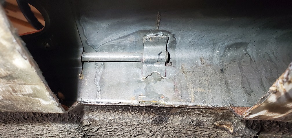

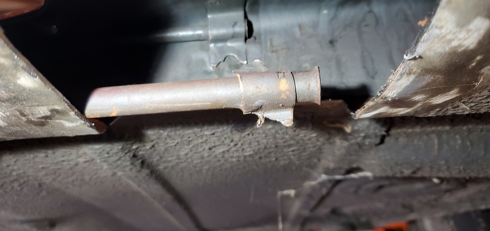

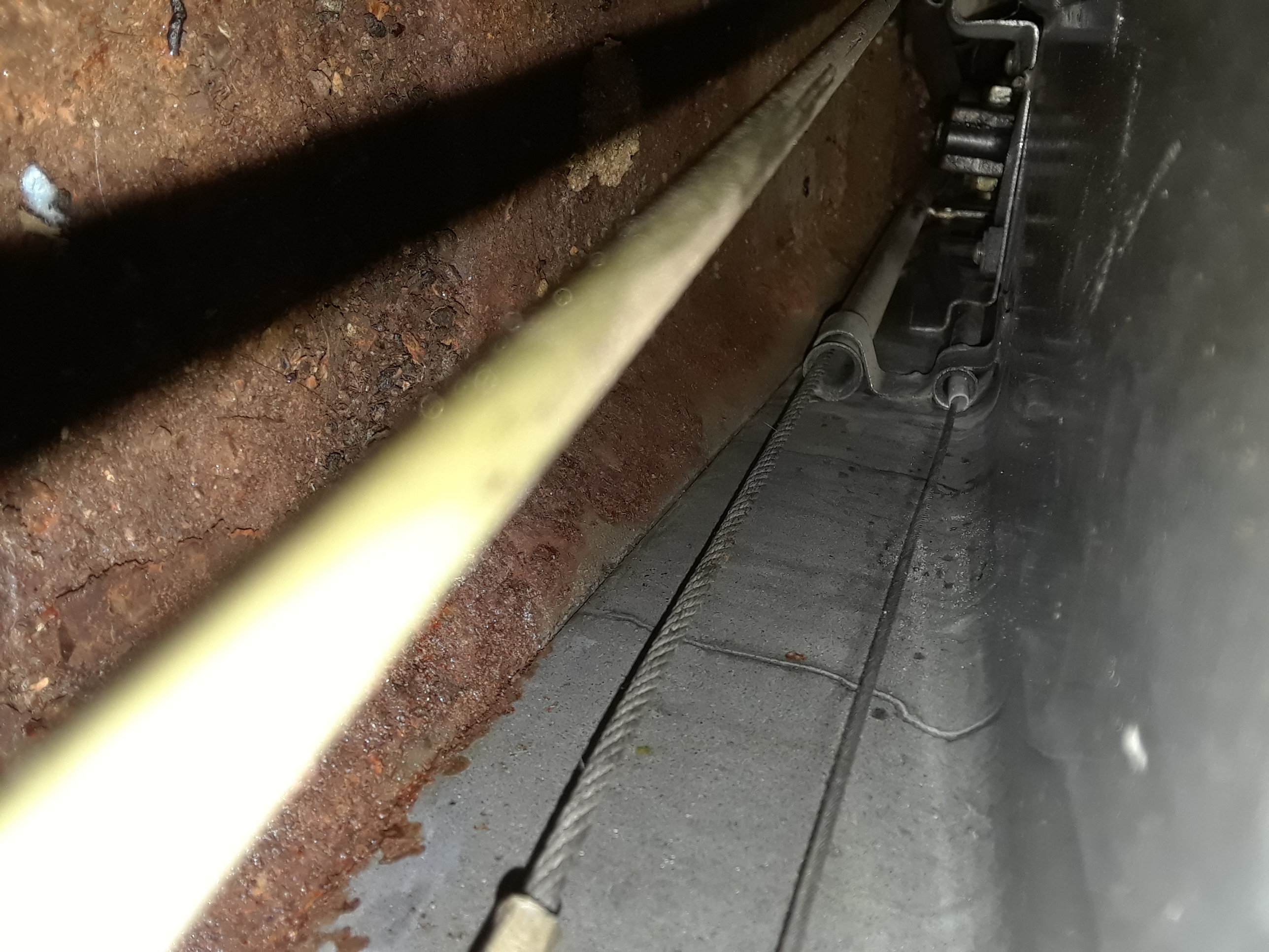

Here's a couple shots from @warpig (s) tunnel on Friday, if that helps.
Upper tube is the accelerator cable. Broken tube is clutch tube.
So I'd install the accelerator cable first. Then the clutch cable, trying to keep it
down on the tunnel floor. Should keep it from getting wrapped up.
My .02c after 3rd cup of coffee.

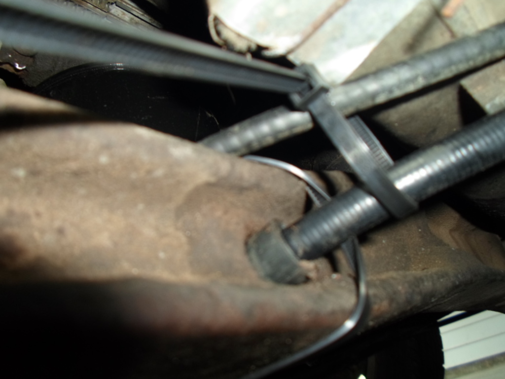

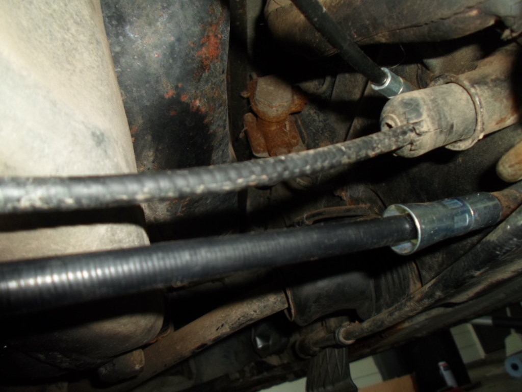

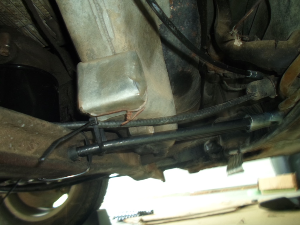

Each cable runs through its own tube, so they can't even cross until they exit their respective tubes, which is only about a foot from your access panel at the very front. As stated, you can snap a pic with your cell phone and make sure they are parallel and not crossed.
I'll let others chime in to correct me if there is a better way, but you will have to feed the clutch cable(fat black end) back through the engine bar hole first past the cylindrical grommet attached to it, then push the front of the cable into the tube. This will hopefully make sense and is probably obvious to most.
This is because the cable housing fitting that mates to the end of the clutch tube itself won't fit through the engine bar hole. Simply put, you can't just thread the front end through the bar and into the tube as might be your first inclination. I attached a another pic of the inside front of the tunnel for viewing pleasure. Sorry if the pic ends up sideways.
...couple more pics of where the clutch cable goes thru the bar and mates up with the tube...excuse the tie wraps...they are currently "place holders" as I haven't hooked up the pulley end yet.

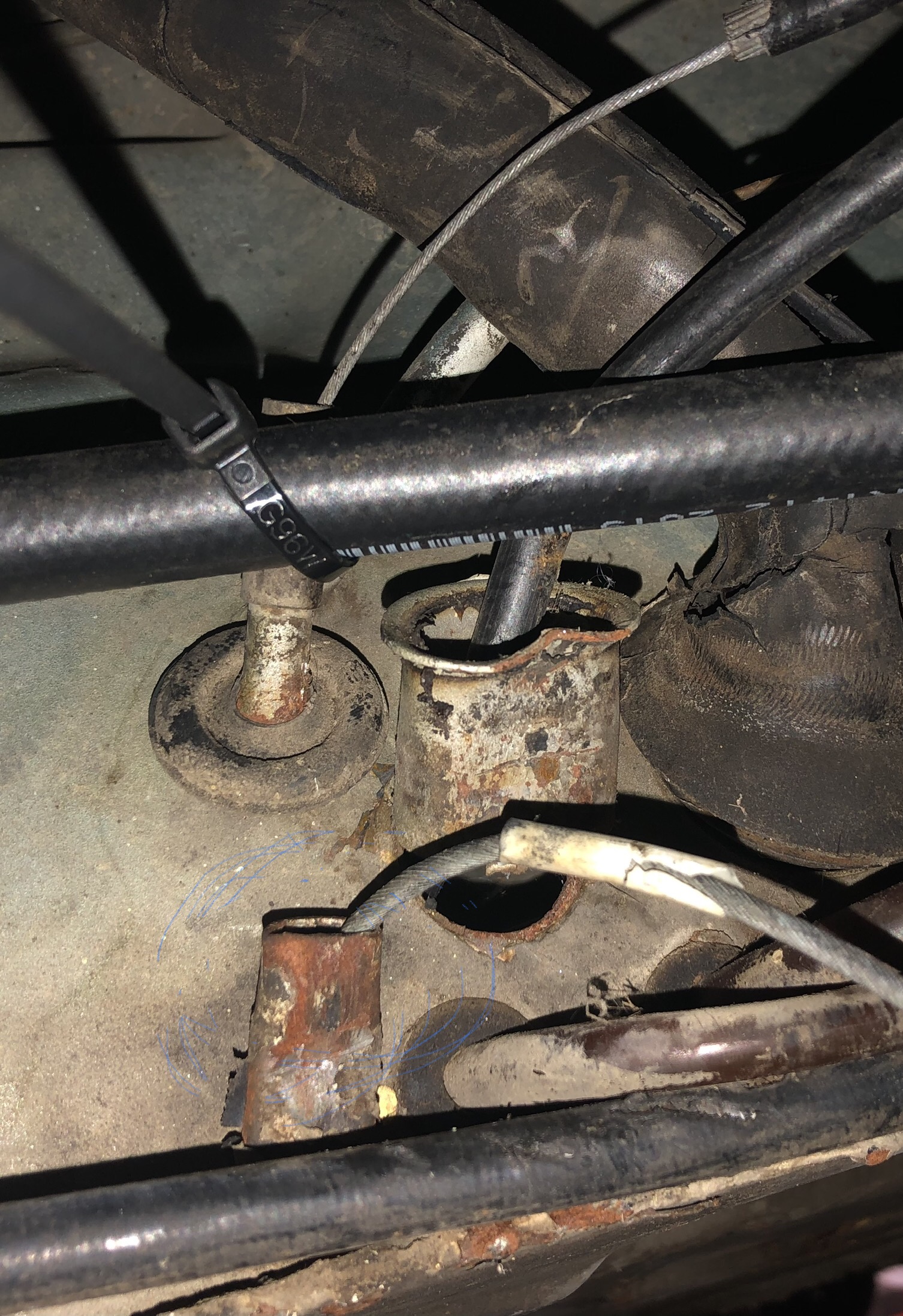

Well that was interestingly difficult.
Cable came off easily once Noel and you all gave me some coaching but check out what happened to the tubes that the cables run through.

I see there is still a plastic (probably original) fuel line - serious fire potential. Most experienced advice is to replace them with stainless steel lines.

Thank you Keith, I put you that on the list. Appreciate the eyes on it.
Weird to think about how those tubes got bent - nothing else is out of place or damaged.
