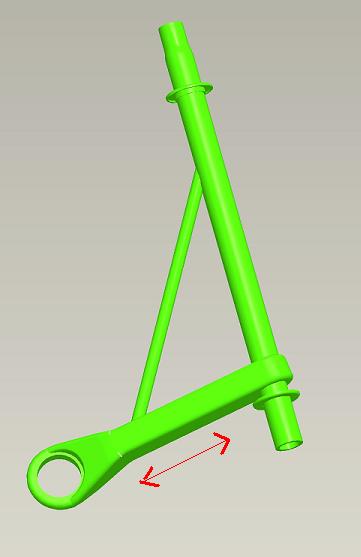

Trying to figure out if I can safely go 1" per side to make the front track the same as the rear....I currently have 1.25" thick spacers, so I could eliminate those which would be nice.
I figure not that big of a deal on the camber since that is easily fixed by opening up the top of the shock tower
(salvage title car, so no worries about "ruining it" (IMG:http://www.914world.com/bbs2/html/emoticons/smile.gif) )
For those that have installed turbo-tie rods, do you think there is enough adjustment to move the ends out an inch per side???

When you lengthen the arms you need to make sure that the inner pivot point does not change in relation to the inner pivot point of the tie rod. THis will mess up your caster and bump steer.

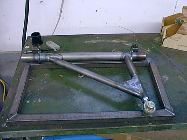

QUOTE (MattR @ Jul 13 2005, 10:47 PM)
could you construct suspension out of steel tubes and eliminate the torsion bar in favor of a coilover?
of course. the factory did with the 935's more than 25 years ago, and new 935-style parts are in current production.
you do need to reinforce the upper structure some, since it was not designed to accept spring loads.

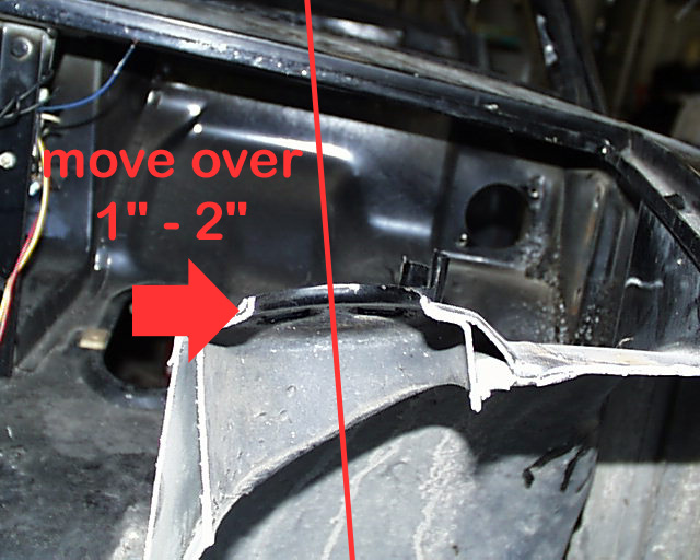

(IMG:http://www.914world.com/bbs2/html/emoticons/icon_bump.gif) for JP (IMG:http://www.914world.com/bbs2/html/emoticons/smile.gif)
so sitting in traffic I got to thinking again about this.....
it looks like there is room inside the shock/strut well to cut and move the mounting over 1" or more depending how far you widen the a-arms....

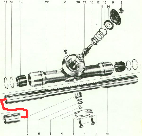

From: Antioch, CA
Member No.: 87
the second modification to the steering rack will be just as "fun" to perform (IMG:http://www.914world.com/bbs2/html/emoticons/smash.gif) (IMG:http://www.914world.com/bbs2/html/emoticons/welder.gif)
you'd need a "sacrificial" rack so that the ends can be cut off, machined and installed to a good rack....this will cure the problem of the turbo tie rods being too short....

How wide do you want to go? = How deep is your pocket?
Adjustable width 935 front end

Wider is better, as you know. I've done it (by moving the lower control arm mounts inboard and replacing them with tubes and rod ends). My overall stance is a bit wider in the front, but with the coil-overs I have to run a spacer to keep clearance between my spring and tire.
The down side of my setup (as Brett mentioned) is toe out in bump (not sure about caster???), but the upside is good roll center control (very little migration over the range of travel and roll).
You can lengthen the tie rods to accomodate... why would you mess with the rack?
