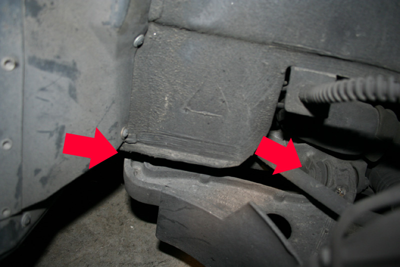

Mueller   pics for JP.....'91 C2 (sorry for being so dir...   Apr 3 2006, 12:08 PM
Mueller   red arrows show pivot points....mono-ball replacem...   Apr 3 2006, 12:09 PM
J P Stein   need a pic looking fwd or aft.....like Groot's...   Apr 3 2006, 12:57 PM
