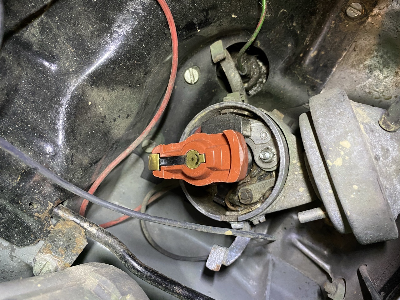

I guess it’s in here?Attached Image

IDF carbs? Size? The interior of that distr is pretty dirty.

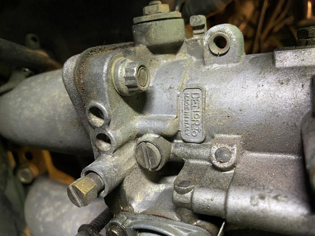

ps
No idea on the carb type / size etc...
I'll add a photo and see if any one recognises them

Carbs will have a stamping, which can be hard to see, on the main body in the middle.
https://www.carburetion.com/CarbID/weberID.htm

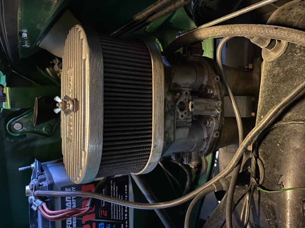

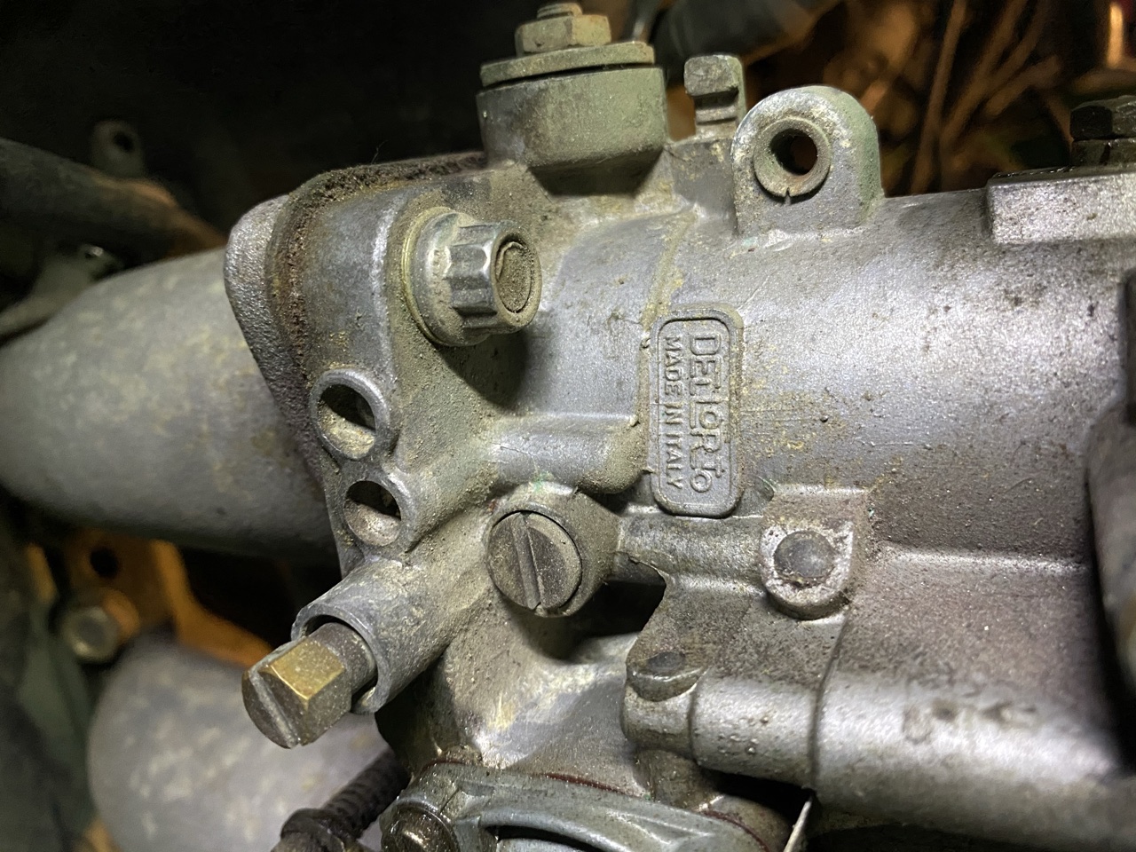

Pictures on the carbsAttached Image Attached Image

That helps. Judging by that intake to carb gasket, those carbs have been on a long time. As mentioned, lots of possibilities. Not relevant, but where does that black wire on the + terminal go to? The line coming off the distr vacuum canister too.

Looks like an electronic ignition module of some sort is installed. That little black box just under the rotor looks like a pickup for a Pertronix style ignition. Also can see a red and black wire tucked in under the rotor as well. Those would go to the pickup of the ignition.
So no points or condenser in there. But as mentioned the advance plates might be gummed up. But you’d probably feel that in all gears and anytime you stomped the accelerator.
But as Kevin said, it looks dirty in the distributor. Would t hurt to clean it. You can check the advance plates while you’re cleaning the distributor. Rotor just pulls off (pull it straight up).

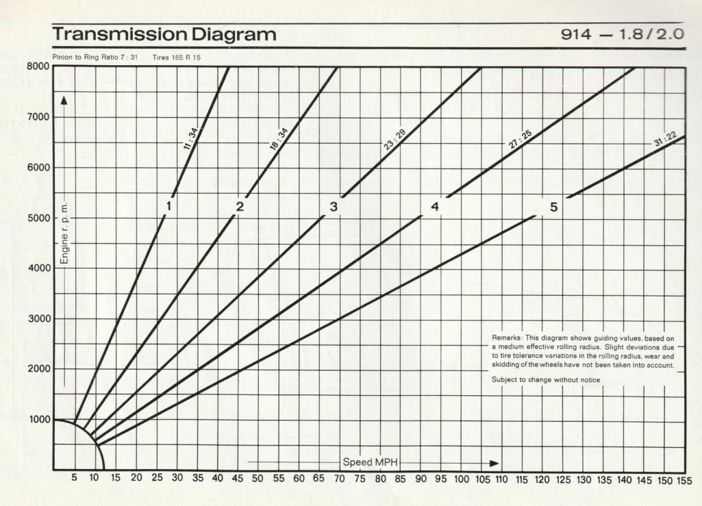

If I shifted from 3rd to 4th at around 30mph / 3500rpm it was sluggish and a just over 30mph in 4th it felt like it was in the wrong gear and needed to down shift back to 3rd
3500 rpm should be around 45mph in 3rd and close to 60 in fourth.. any chance your clutch is slipping?

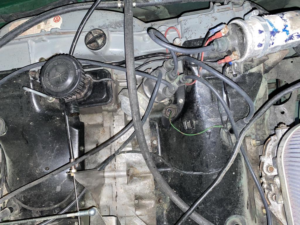

The black wire from the +ve terminal goes to the starter motor
The rest of the set up looks like this
