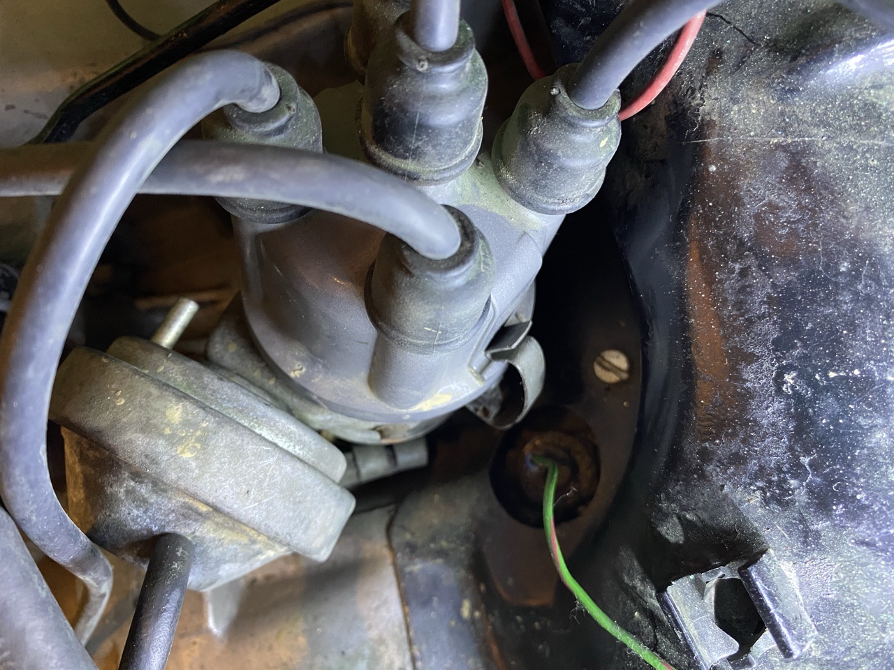

Looking at the direction the plug wires follow from the distributor, I believe you have them out of the proper order(?). The picture shows the two spark plug wires on the driver side (next to each other) of the distributor go to the driver side cylinders, similarly the two spark plug wires (also next to each other) on the passenger side go to the passenger side cylinders. This seems rationally wrong to me where the driver side cylinders fire one after the other, similarly passenger side firing one after the other. Check your firing order and attach spark plug wires accordingly. Hope this helps.

No, that's right if I'm not mistaken. 1432

Gint is right!. I am surprised that the timing is not sequential from side to side, as in 1,4,2,3 (IMG:style_emoticons/default/beer.gif)
Would it run if that was the case?
Does any one have a picture of the correct positioning on the distributor top please?
Hello,
1. Did you remove or rotate your dizzy? I know that car was running well and it is running when the car arrived to you.
2. If you still have the original or stock 1975 1.8 Dizzy, the TDC notch on your dizzy should be the RED dot on the pic that I edited.
3. Stock TDC (#1) usually around 11 o’clock and should be on the notch (see pic)
4. If you didn’t touch anything on your engine during the body repair, probably the reason of your rough idle is a carb issue. Maybe jets are clogged or dirty.
I also included a pic from other post that show the vacuum canister is facing/aligned to the Oil tower fill. My previous 75 1.8 F.I. and a 74 1.8 F.I. of a friend that I help fixed has the same location.
Below is a pic where you can find the size of your carb for dellerto.

I haven't disturbed anything since the car arrived, I couldn't drive it in the UK so I didn't know how it was running but it started (after a few turns) and idled OK so I didn't mess with anything
I have only taken the dizzy cap off to look inside to check the contact points and the condition of the rotor arm
There are lugs for the spring clips so I am presuming I have the cap on correctly, it could be possible to rotate it by 180 degrees - would this make a difference?
I think the firing order / leads are correct, if you look at the lead from cylinder one and go clockwise, it is followed by 4, then 3 then 2 so 2 is next to 1. Its only incorrect if you go anti clockwise (as then its 1,2,3,4)Attached Image

Your firing order is correct based on the picture you originally posted.
This could be a timing/distributor or carb issue. Starting from the beginning and checking everything suggested so far is required.
With the engine on #1 cyl TDC, the rotor should be pointing roughly at the physical location of #1 cylinder provided the dizzy is not 180 degrees out.
I don't know that you should really expect phenomenal performance in 4th gear at 30MPH anyway. But that's relative. If you noticed that it performed decently once before and then you noticed it wasn't for example.

With the engine on #1 cyl TDC, the rotor should be pointing roughly at the physical location of #1 cylinder on the distributor cap position provided the dizzy is not 180 degrees out.

I corrected by statement about #1 position in my last post. I added this: "on the distributor cap position" to this line:
Which is roughly 11 o'clock as pointed out earlier in the thread.

Have you tried cleaning your dizzy like what others have mentioned? looks really dirty inside there. And also your pertronix (color black inside your dizzy) may have issue with the contact because of some dirt. Can you rev your engine higher like around 3k rpm? I still really think that it is just a carb issue right now since you haven’t change anything on the engine.

What does the inside of the distr cap look like? That green tinge on the outside looks like pollen. Ancient. The spark plug wires are run pretty helter skelter. everything looks old. Replace dispossables. That + lead for the starter should not run across the top of the engine. The distr needs to be cleaned and weights oiled. Consider the process a comprehensive tuneup. Then approach the carbs.
