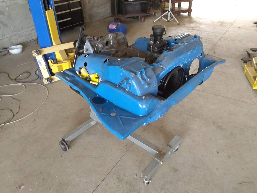

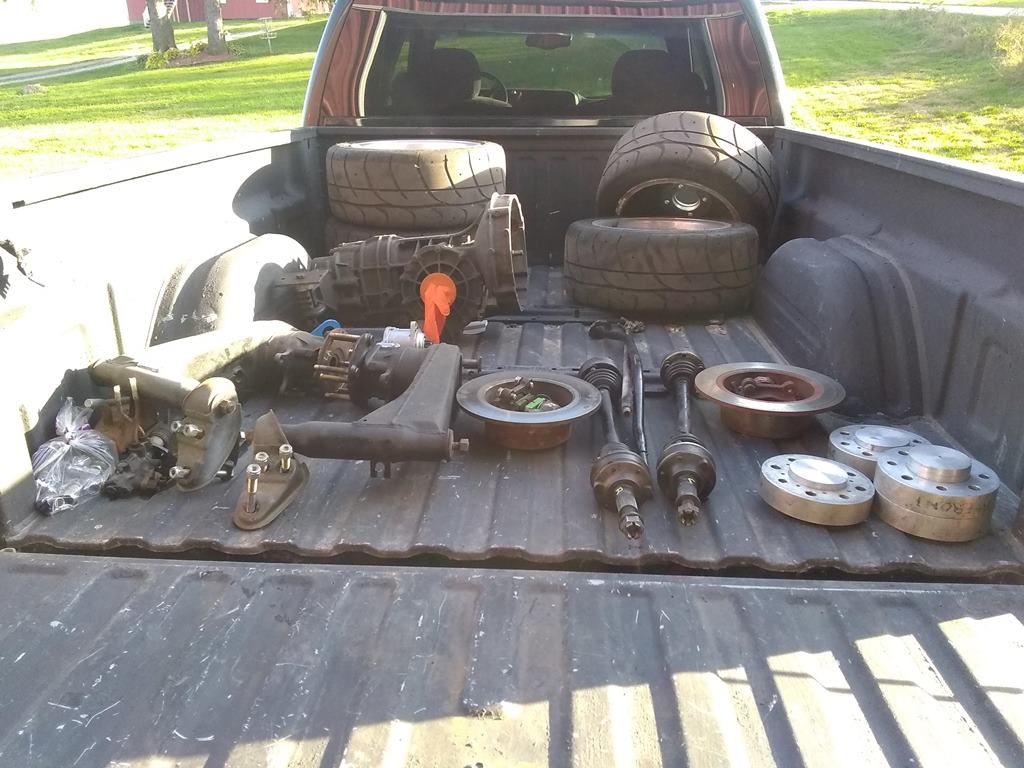

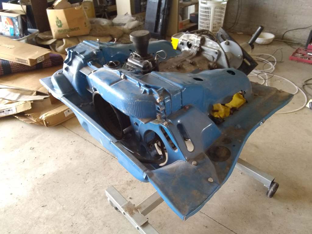

I have been playing with VW Sandrails for about twenty years. Was setting up to build a mid-engine dual port rail this winter when I stumbled upon a type four 1.7L located twenty miles from my house. With the mid engine I wanted the engine cooling air inlet on the alternator pulley side. I contacted the seller and he asked me if I wanted the transaxle too.
The donor car was a 1973 914 setup for autocross with no title. I ended up with the engine, transaxle, rear brakes, shifter, starter, trailing arms, and all four tires for what I sold my old VW sand rail. (pictures attached) I know it's sacrilegious to part out a good car for a tube chassis rail but I am stoked!

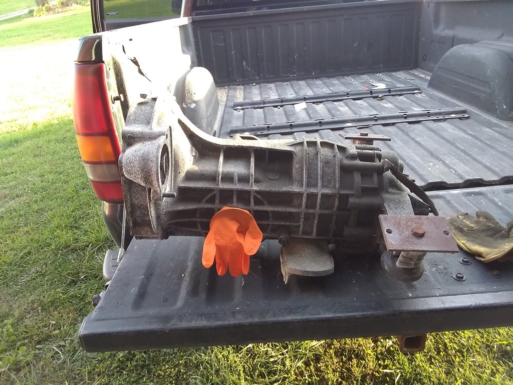

I will be lurking about, there are a few widgets bolted to the 914 transaxle that I am curious what they are.

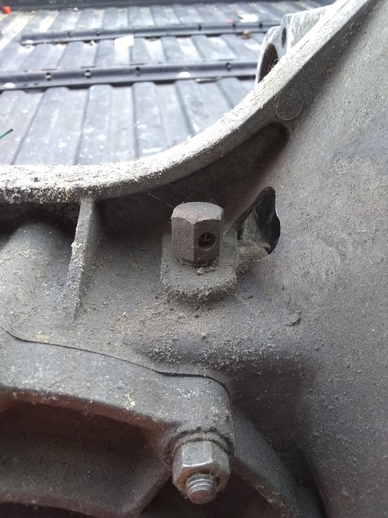

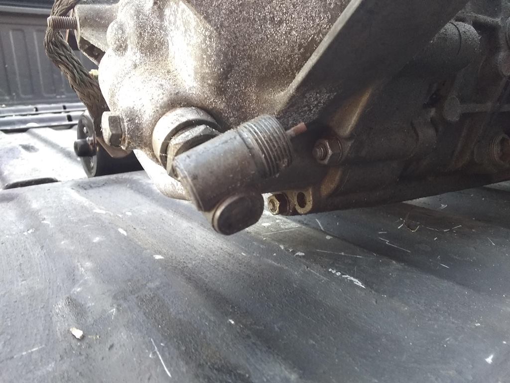

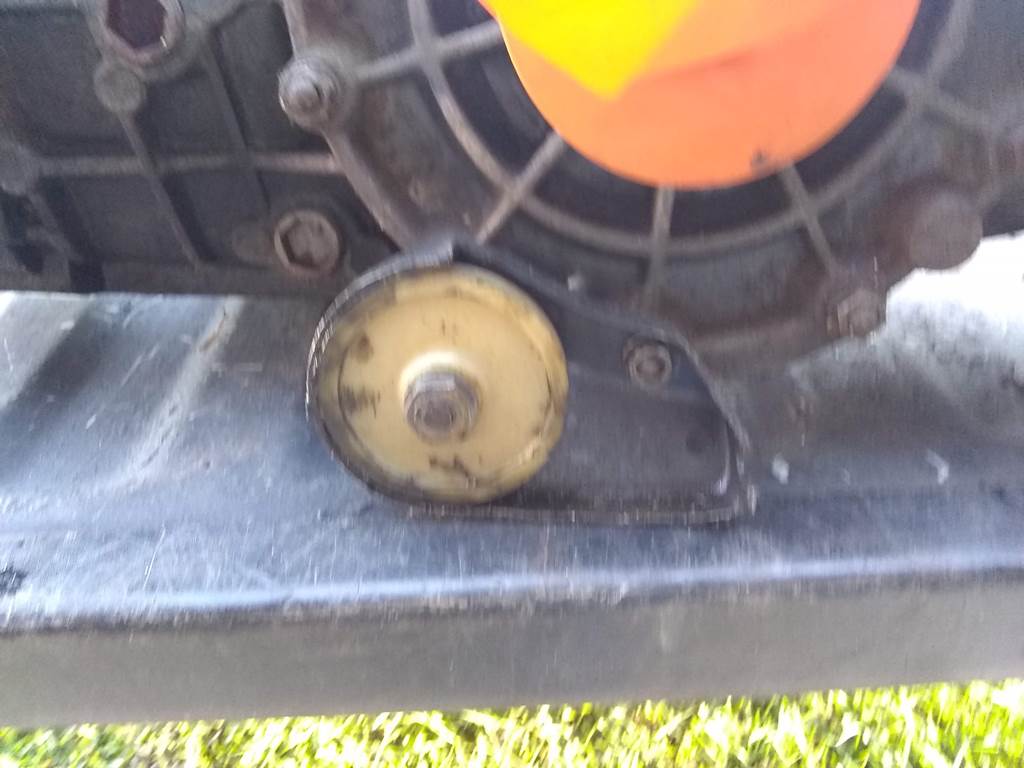

Some quick questions:
I assume this is the transmission case breather?
Speedometer drive?
What is this white plastic wheel? I can't even guess...

Yes, trans breather vent,
Yes, speedo drive,
Pulley is for the clutch cable to wrap around so a pull from the pedal assembly becomes a rearward pull on the throwout bearing arm to push the TO bearing forward.....got it??
Well that would have taken me forever to figure out, fantastic, thank you! (IMG:style_emoticons/default/smilie_pokal.gif)

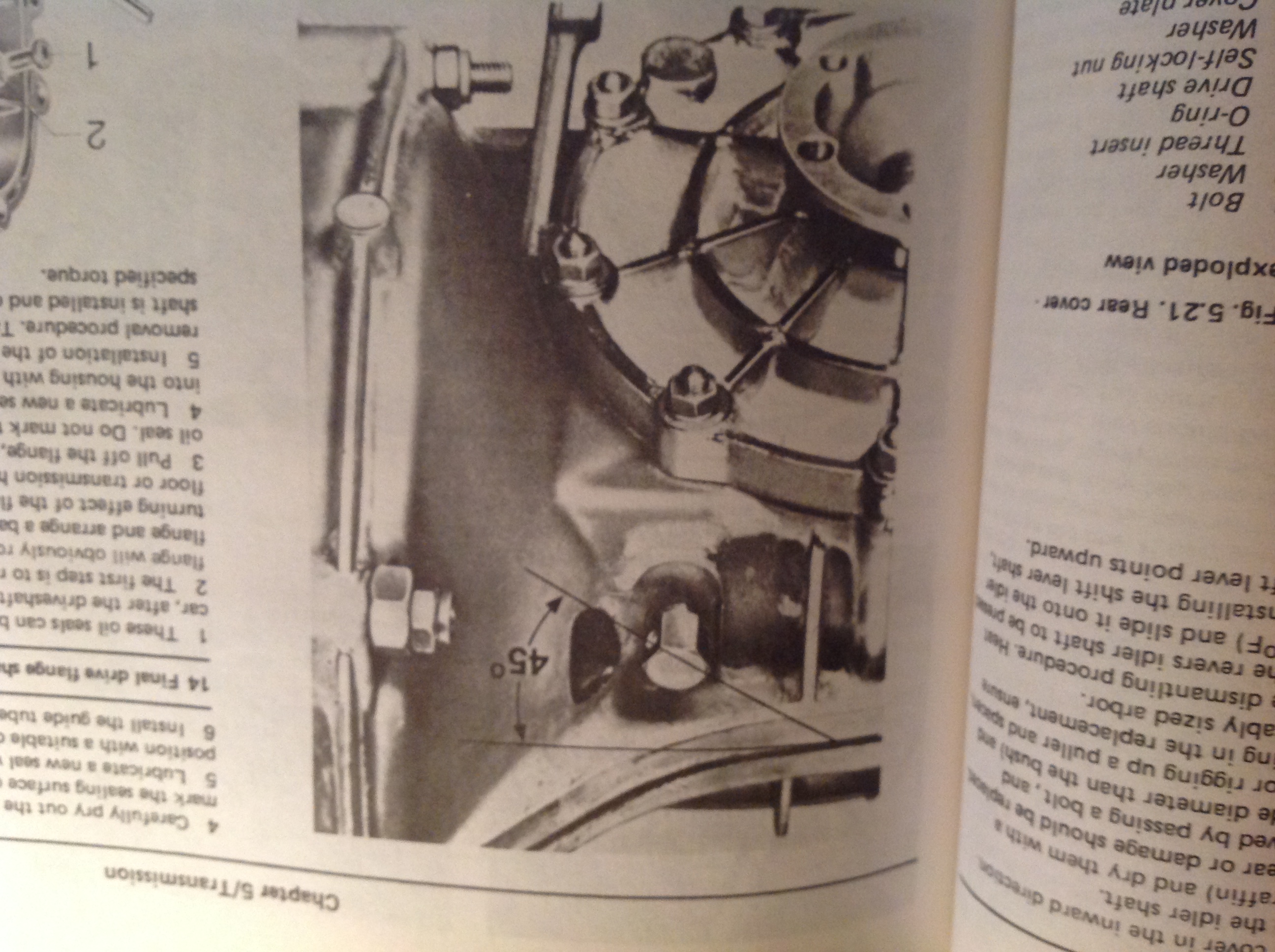

Here is the breather orientation. Make sure the port on the vent is not plugged.Attached Image
