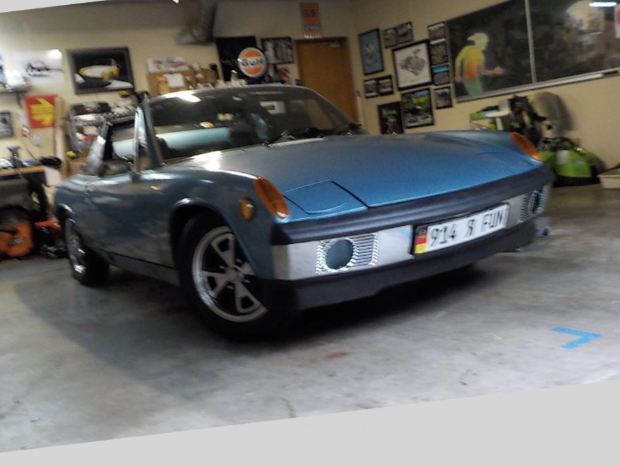

I will be using same wheels I got from a friend (member here) and planning to use 195x60. I will share a picture of my friend’s car with the wheels and 195x60 tires on it.

They look sooooo good.
