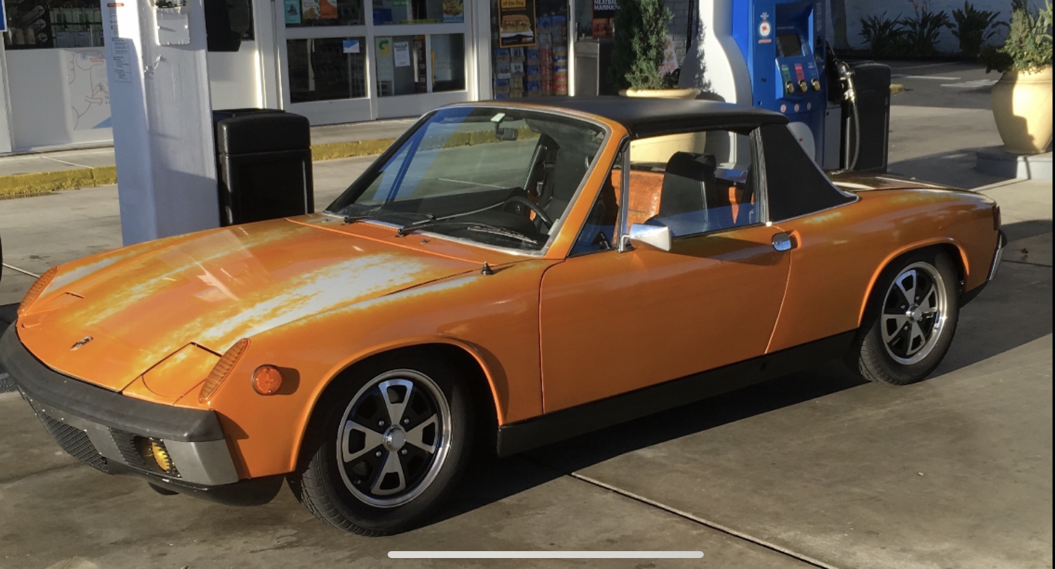

https://tiresize.com/calculator/Over the years I've run various sizes.. 165/80-15, 185/70-15, 195/60-15, 195/50-15 and 205-50-15 all on the stock 5.5x15 porsche rims. Your desired appearance, performance and availability will all impact your choices. imho, over the years my favorite was 195/60-15 "sticky" tires from the 1990s. Because I run more towards performance vs stock appearance, i would be inclined to run a 205/50-15. But the simple fun of sliding the car on 165/80's has a certain appeal as these cars have moved well past being "fast" or even sporty and are appreciated for simply still being around after 50 years.
