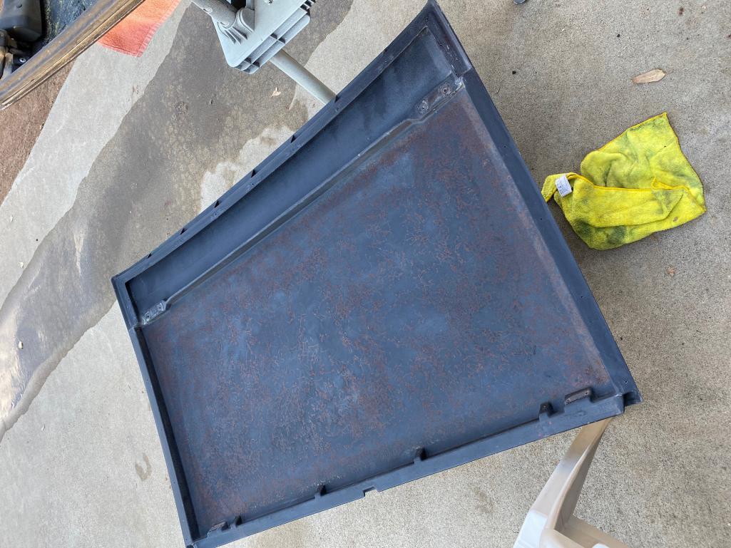

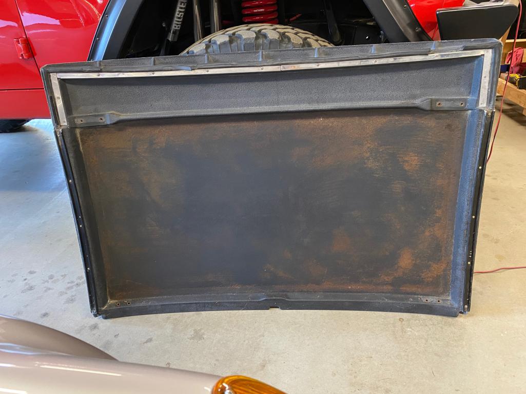

Interesting thread, I've been trying to find a really good 'stock' top to be able to swap out my body colored top just to change up the look if so inclined. I have 3 spare tops now as I've searched for one that needs only paint and minor refinishing vs a full on re-do.
After this thread, realized that I have two early and one late, I need the late one so will be probably bringing the early ones to sell off next time we ever have a G&R Swap meet...
Early:
Late:

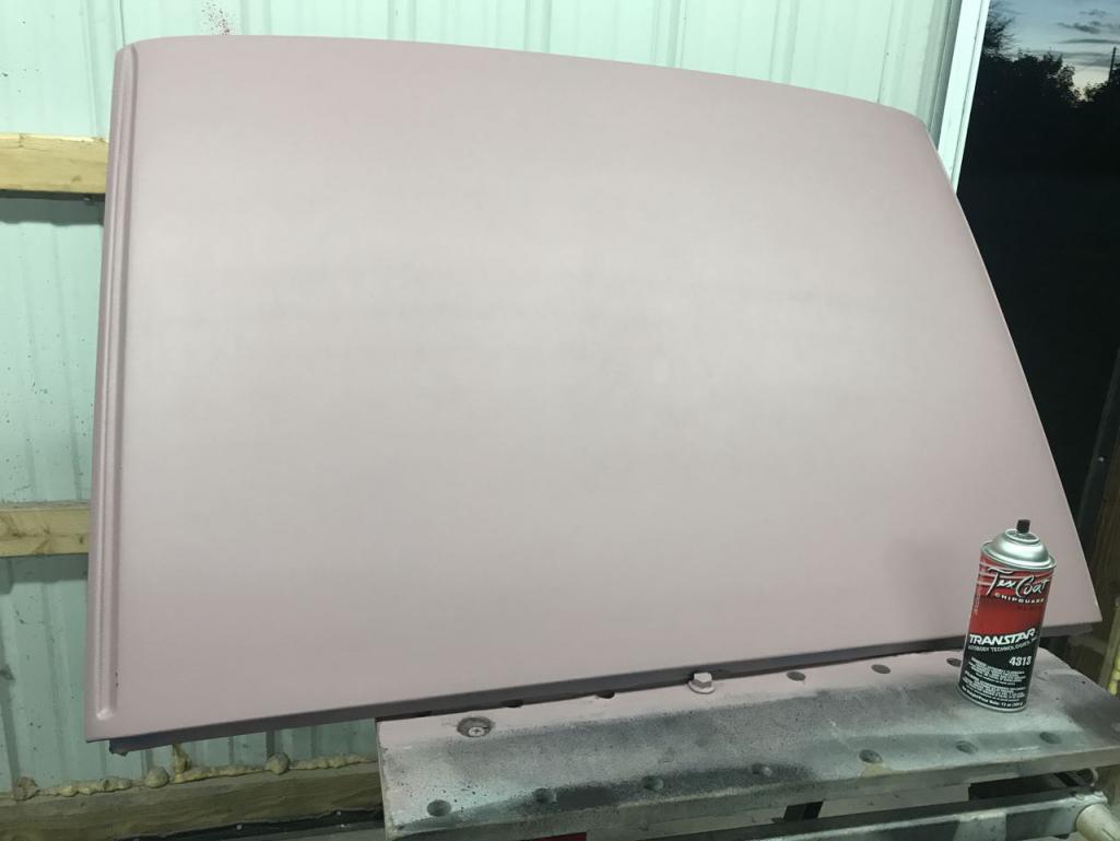

What is the preferred product to treat a top exterior to freshen it? Even further, if a guy wanted to respray it, what's the DIY solution or product?
Garland
post Oct 17 2020, 12:25 AM
Restoration Fanatic
Posts: 1,413
Joined: 8-January 04
From: ......Michigan......
Member No.: 1,535
Post # 146 Link
Here’s how, and the product I used. It turned out nice. Distance when spraying the texture coat, will give you the factory effect as far as texture. Then finish with the black satin used in an earlier post on the same page for the bumpers.
