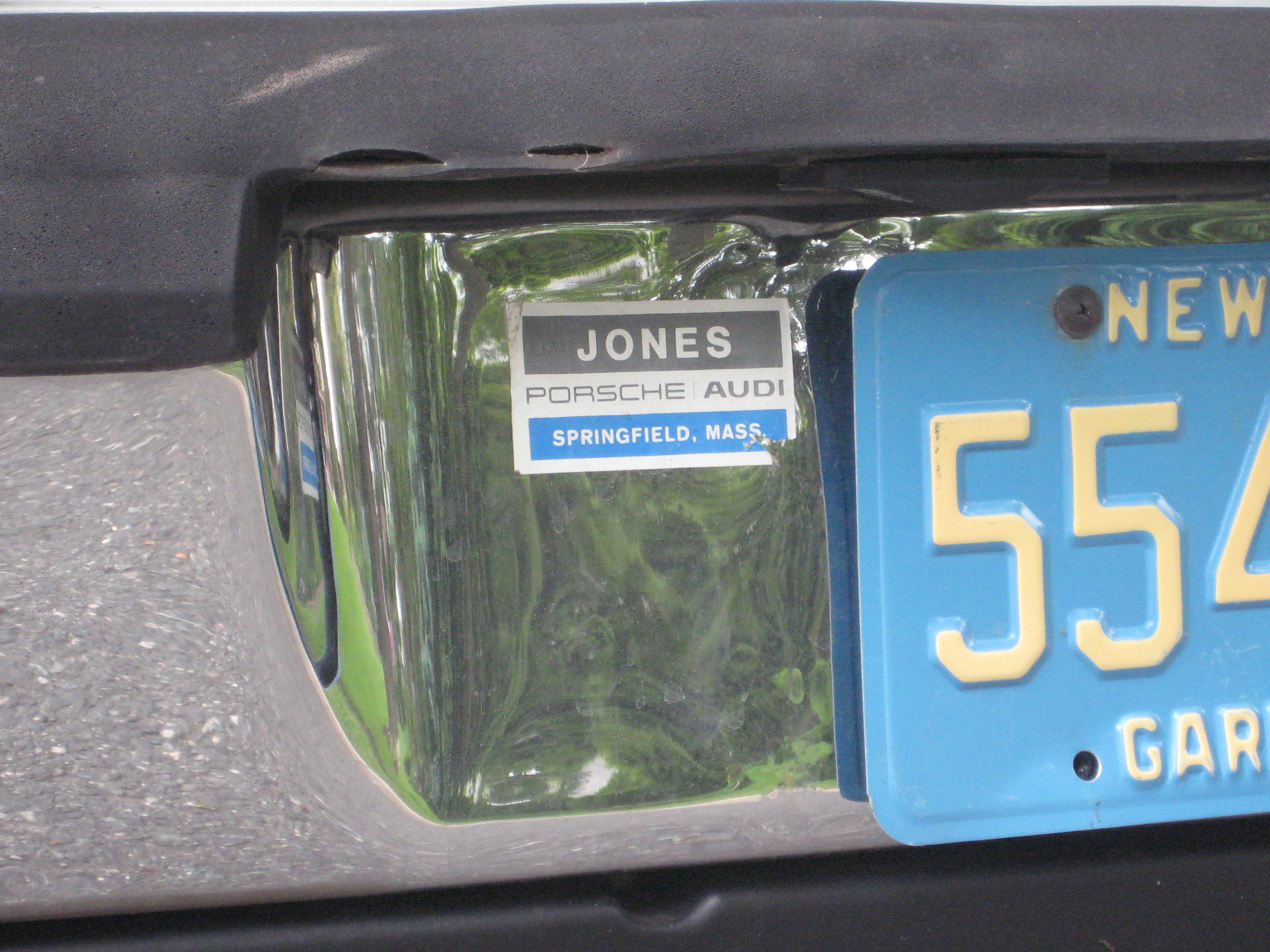

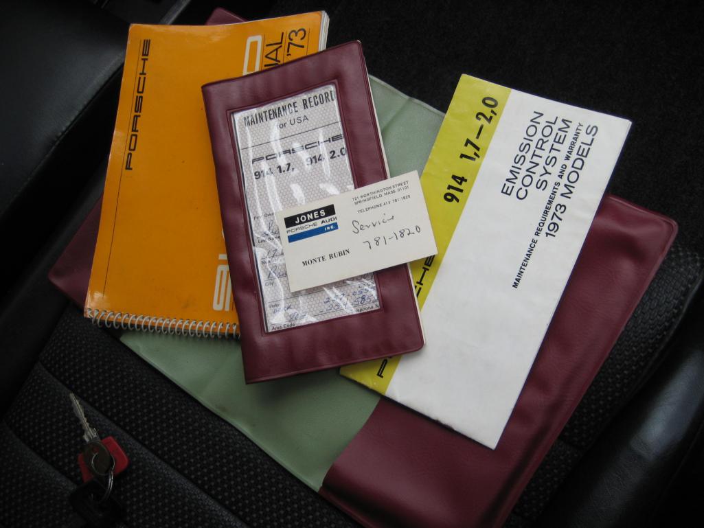

QUOTE(DANNYMAC @ Oct 12 2020, 03:34 PM) *
Yes ! Thanks Previous owner says and has receipts, fuel lines and brake lines replaced in 2016
Pics show the original plastic lines in the tunnel and engine shelf.
QUOTE(Gint @ Oct 12 2020, 05:50 PM) *
Wow! Looking at the receipts that car was sold by Jones Porsche/Audi in Springfield, Mass. They went belly up in the late '70's and I later worked at the dealer that bought the franchises. I've got a "Porsche" sign from the Jones service dept hanging in my garage. Also one receipt says "ask for Rose Marie" who was most likely the same Rose Marie that came over to the new dealership from Jones.

QUOTE(ejm @ Oct 12 2020, 06:32 PM) *
Ed good to see you in Stroudsburg
Pictures from a '73 2.0 I owned in 2014
Small world right ? do you recognise the salesmans name ?
