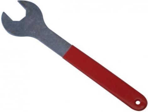

Hi guys,
I am going to install the turbo tie rod kit on my 74. Read all I could find but had a question on the flat key to be used. The one on autoatlanta is square but I can't seem to find them here. Would the below "rounded" one work ? Size is 32 mm so that should be correct

It needs to be a thin 32mm the flat part of the turbo tie rod is very narrow. A crescent wrench will not work

Snap-on sells thin blade wrenches, of course at a Snap-on price.

Check your local bike shops. I purchased one from such place and it worked great on two turbo installs . Save yourself some cash too.

Yep. 32mm headset wrench (also you can search cone wrench)

Got mine on amazon...
Park Tool Headset Wrench... https://www.amazon.com/dp/B001VRF0TM?ref=pp...op_mob_ap_share

Cheap bikes still use the old standards.
The park wrenches are good but not designed to crank down on the hardware. When you use them on a bike headset, you hold the 32mm flat on the bearing race while you crank down on the top nut with a large adjustable wrench. If you put a lot of torque on a thin spanner wrench, you end up rounding off the edges.

I went to a local bicycle shop and used their wrench.

I don't recall who, but a member here was selling laser cut wrenches for stock and turbo tie rods. I bought one and it is great. You might want to search the member vendor forum.

I bought my set years ago to replace Chrysler inner tie rod ends... I recently used them to change my turbo tie rod ends.

The one shown in my picture is actually used for bikes and is very thin. Will give it a try, cost is cheap.
