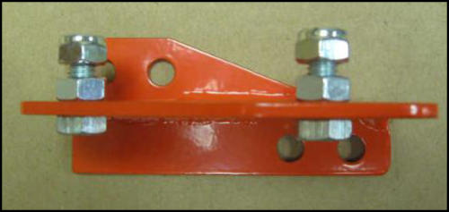

This is what I installed.
Still get dirty (but maybe a little less).
Better ground clearance for sure.
http://www.tangerineracing.com/transmission.htm

Another option is from Tangerine Racing mount $52.

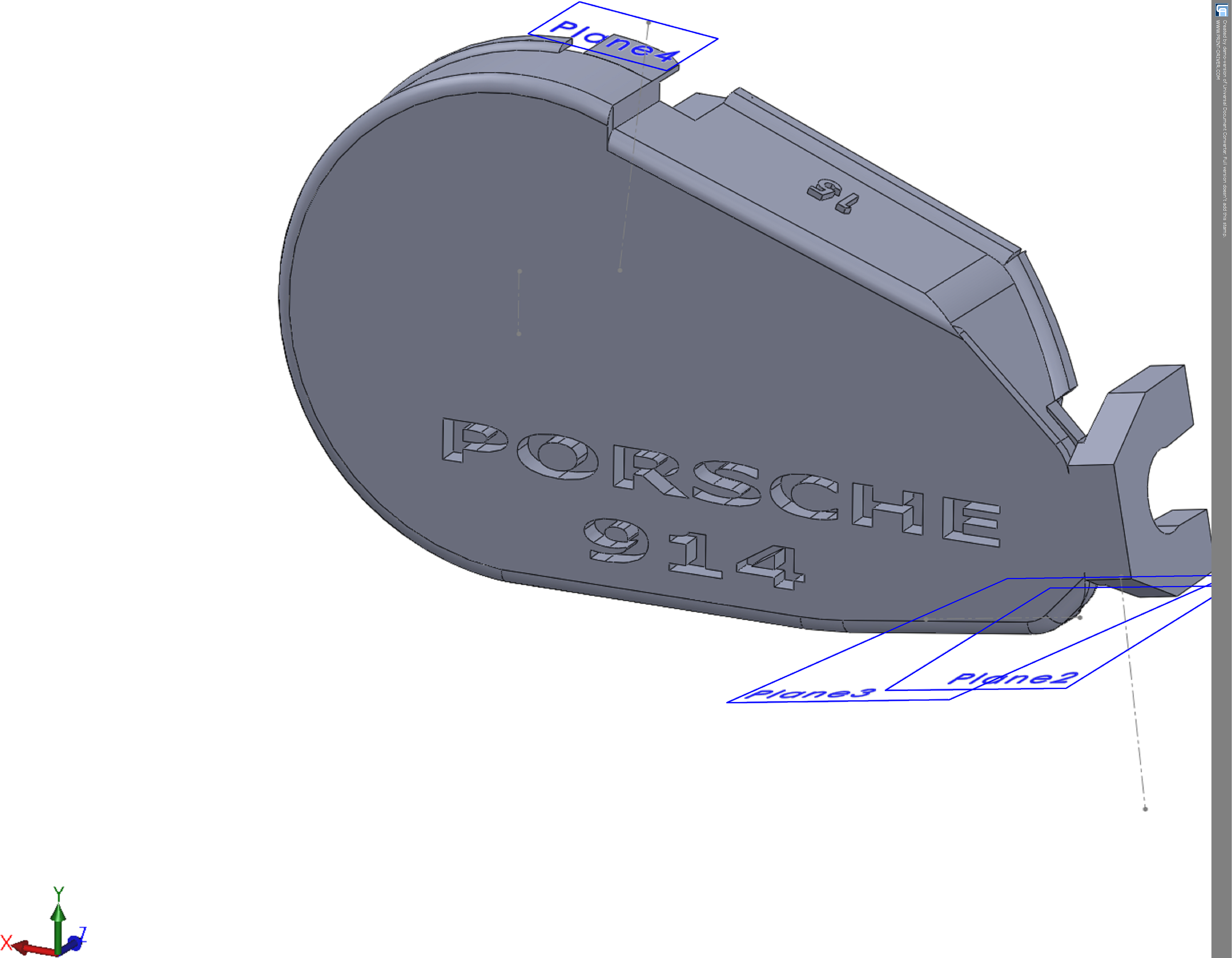

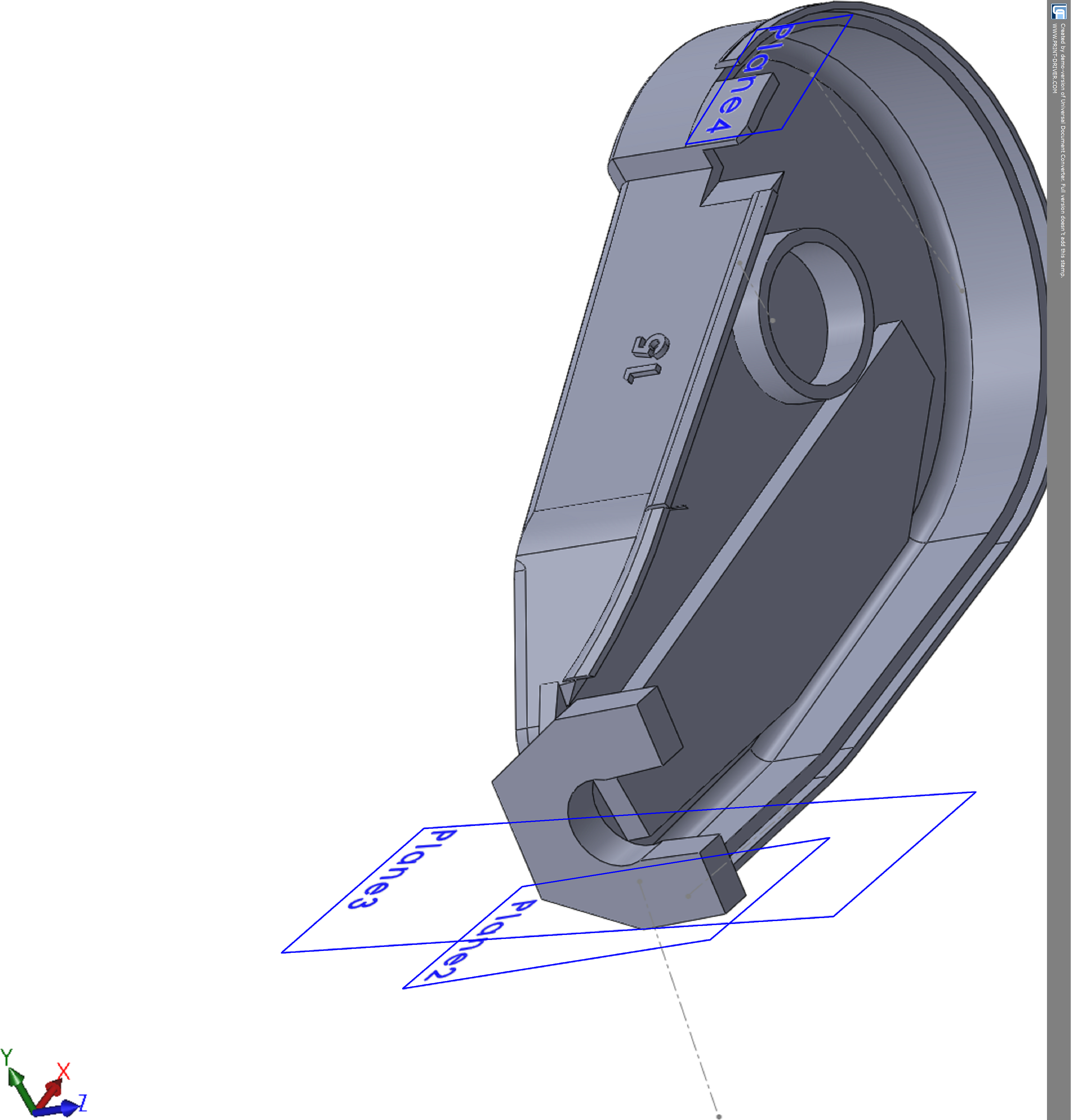

I printed a cover a while back but didn't mount it. I tried some clips but they didn't hold it on. Probably should have just used some tiewraps. Here's what it looks like now.

Wow....those last two replies really are thought provoking. Just how significant is the dirt contamination in the life of a cable? Great question....And then the picture of the actual cover is amazing.....I want one of those!! Especially if it was made out of clear plastic or softer clear rubber (hint hint Mark). Anyway.....I am on my way to the fabric store to buy some polyester cloth and see what I can come up with. Thanks you guys,

As much as I think it's a solution seeking a problem, that is great design work and you have at least one interested customer! Great job! I wish I had more time to play . . . Is that done in Inventor? Axis and the way planes are notated look familiar. Maybe some other AutoDesk product?
