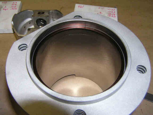

Gotta take a first step. Ring gaps. Here's the top ring at a depth of 12 mm (top of piston to 2nd ring). .019". These are pregapped from JE. Everyone say run em at that gap. All rings were between .018" and .020"
